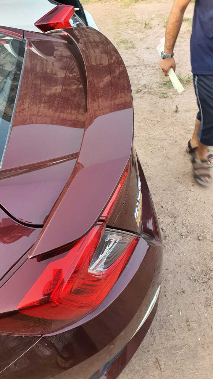

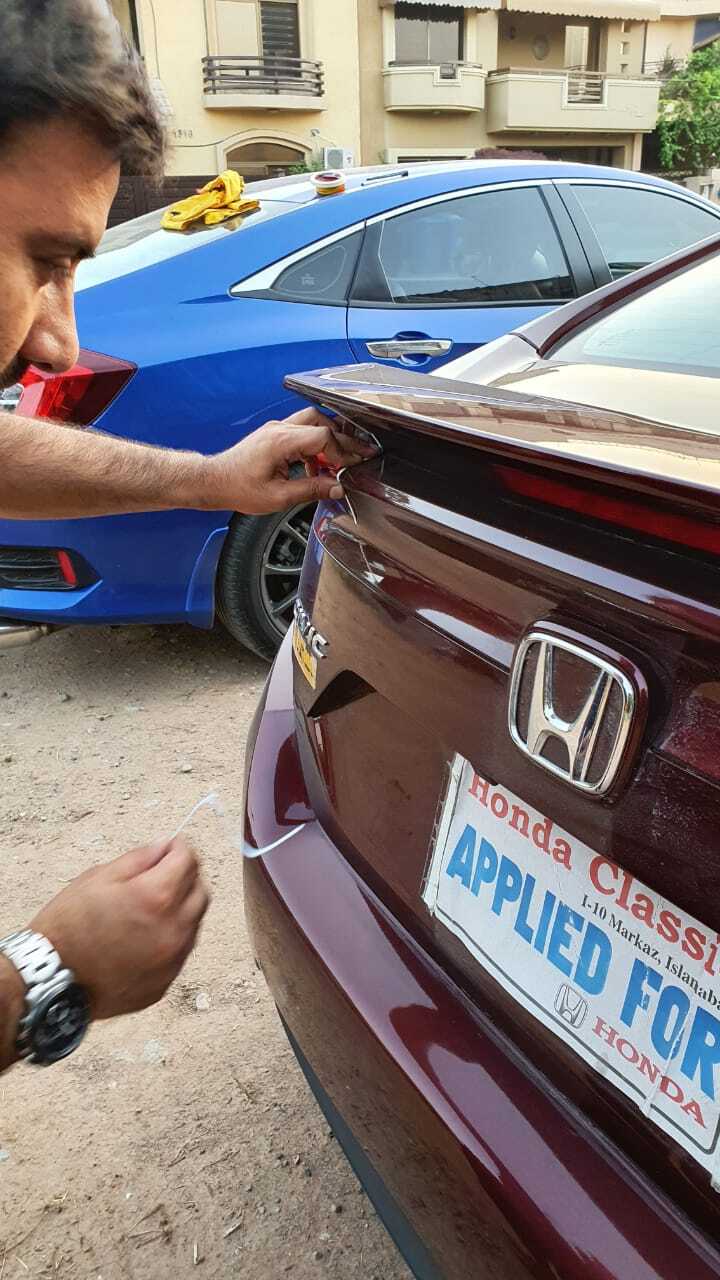

We went to a friends place to and parked the cars parallel to see the OEM spoiler position.

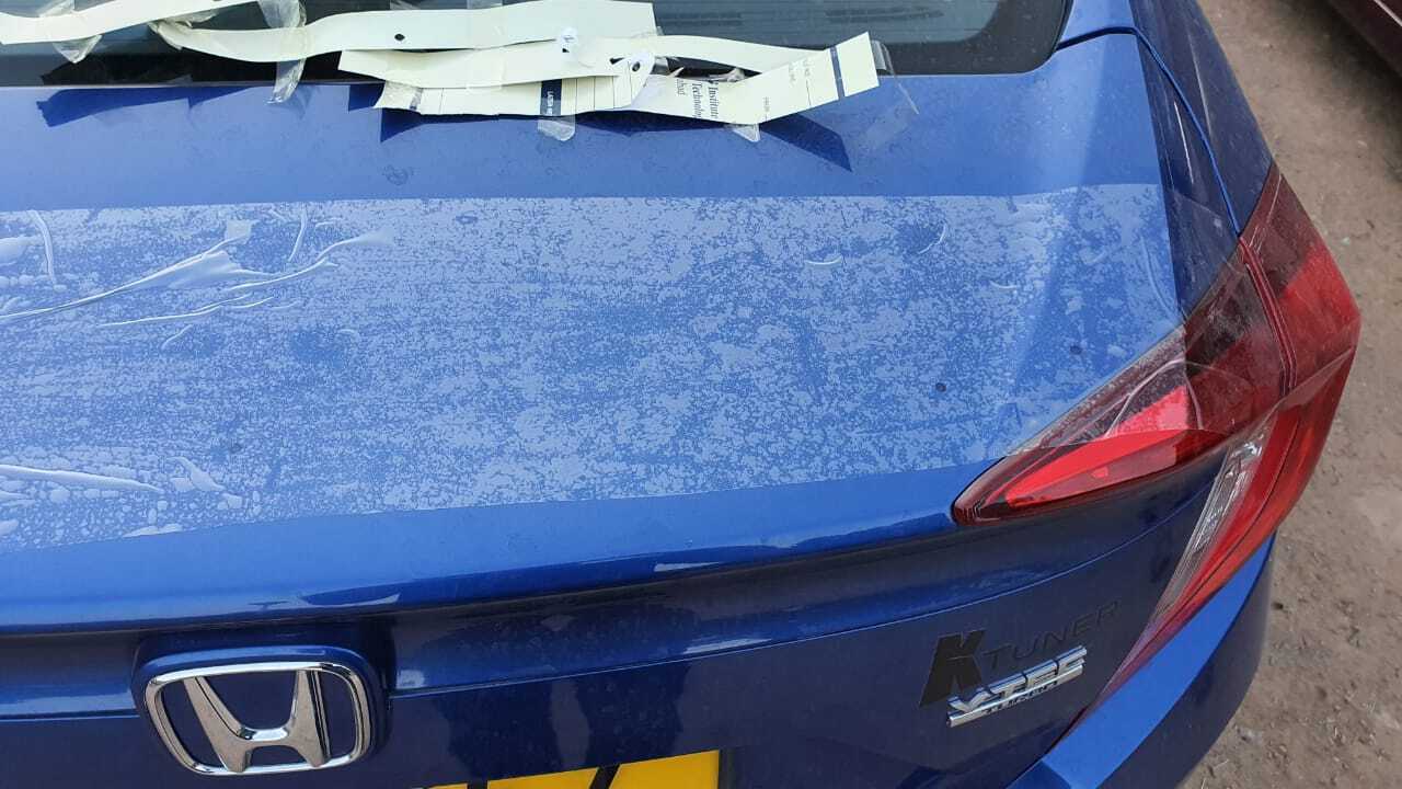

to protect paint, a transparent vinyl sheet was pasted on the trunk so that during our work, the paint doesn't get scratched.

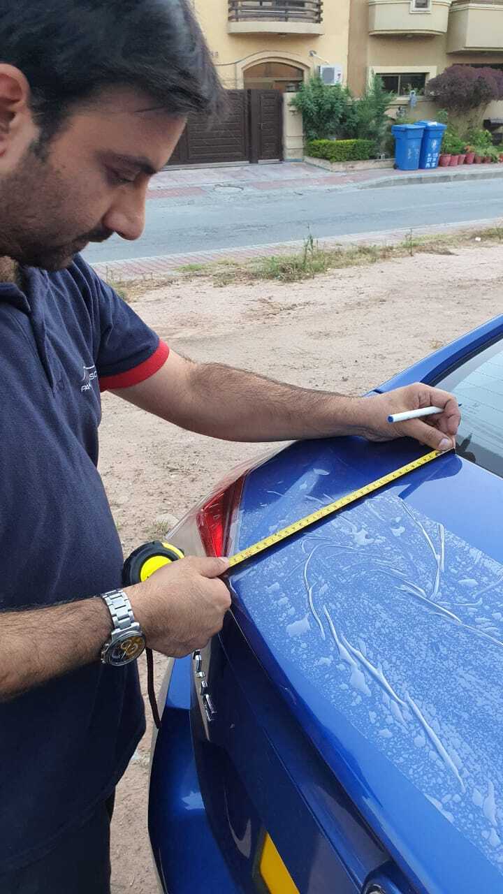

Marking strips were made using file cover with a punch for the hole.
Thats the spoiler.
Strips were glued to the bottom of the spoiler to match the hole.

Then place the spoiler with marking strips on the exact position.
tape the strip with body and lift the spoiler and mark the holes.
take measurements again to re-check the holes center position.
the sample installation of OEM installed Spoiler of a friend Jawad was great help.with out that it was not possible.

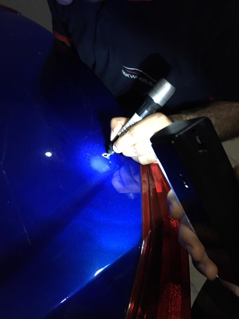

Now the drilling part.
Another video as there were 4 holes.
Drilling for Brake light wiring.
Then touch up paint was used to cover the drilled hole for future possible rust protection.
