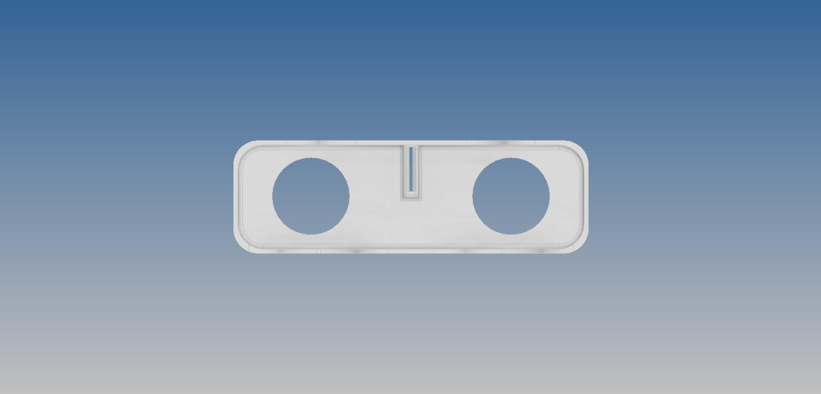

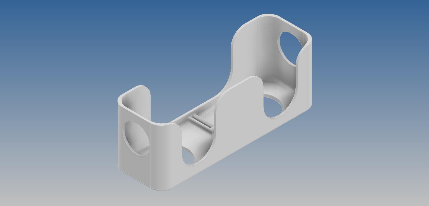

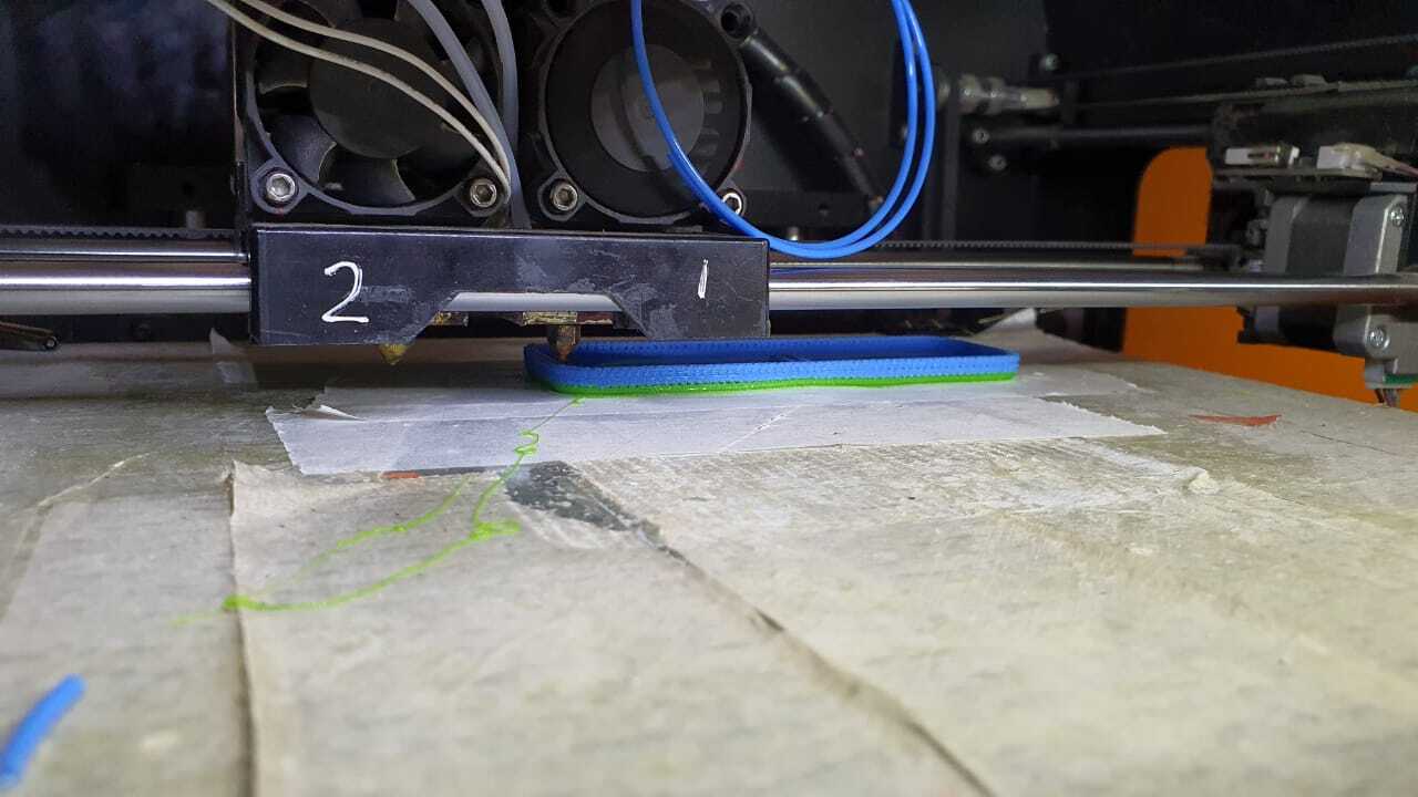

I am making a part to find the dead center of trunk.I made this CAD drawing.Round holes are just to reduce the material nothing else.I just need the shape with the slit in the center.
now 3D Printing it .
I will put this part in this sectionand the slit in the center will give me the center of the trunk.
I have not done it before. but logically I think I will achieve my goal

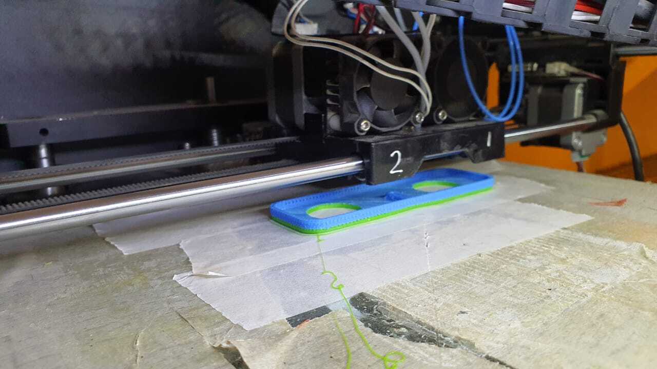

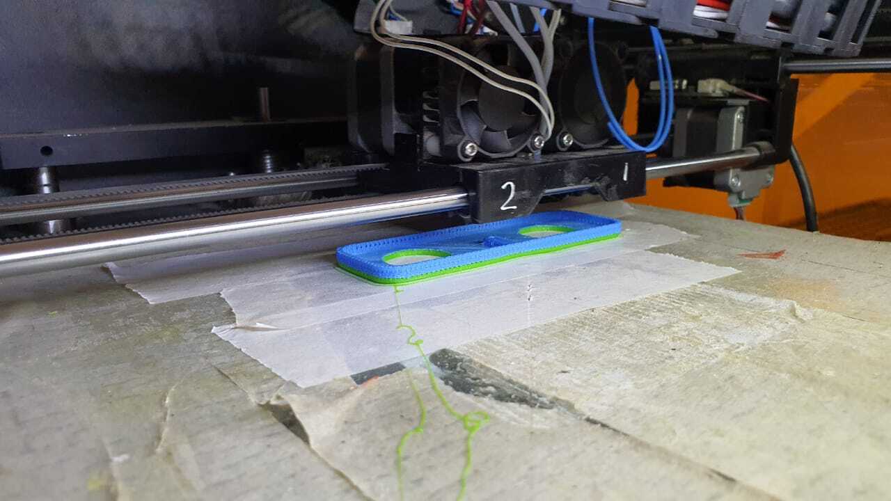

3D Printing Pictures.
3D Printing Video.

update at 3D Printing .
Ehtesham bhai is piece say hoga kiya? it's only for finding the dead center ya koi aur bhi purpose hay iska?
only to find the dead center of the trunk.so that the spoiler is not to any of the side..This part will help me to find the center by an accuracy of +/- 0.1mm

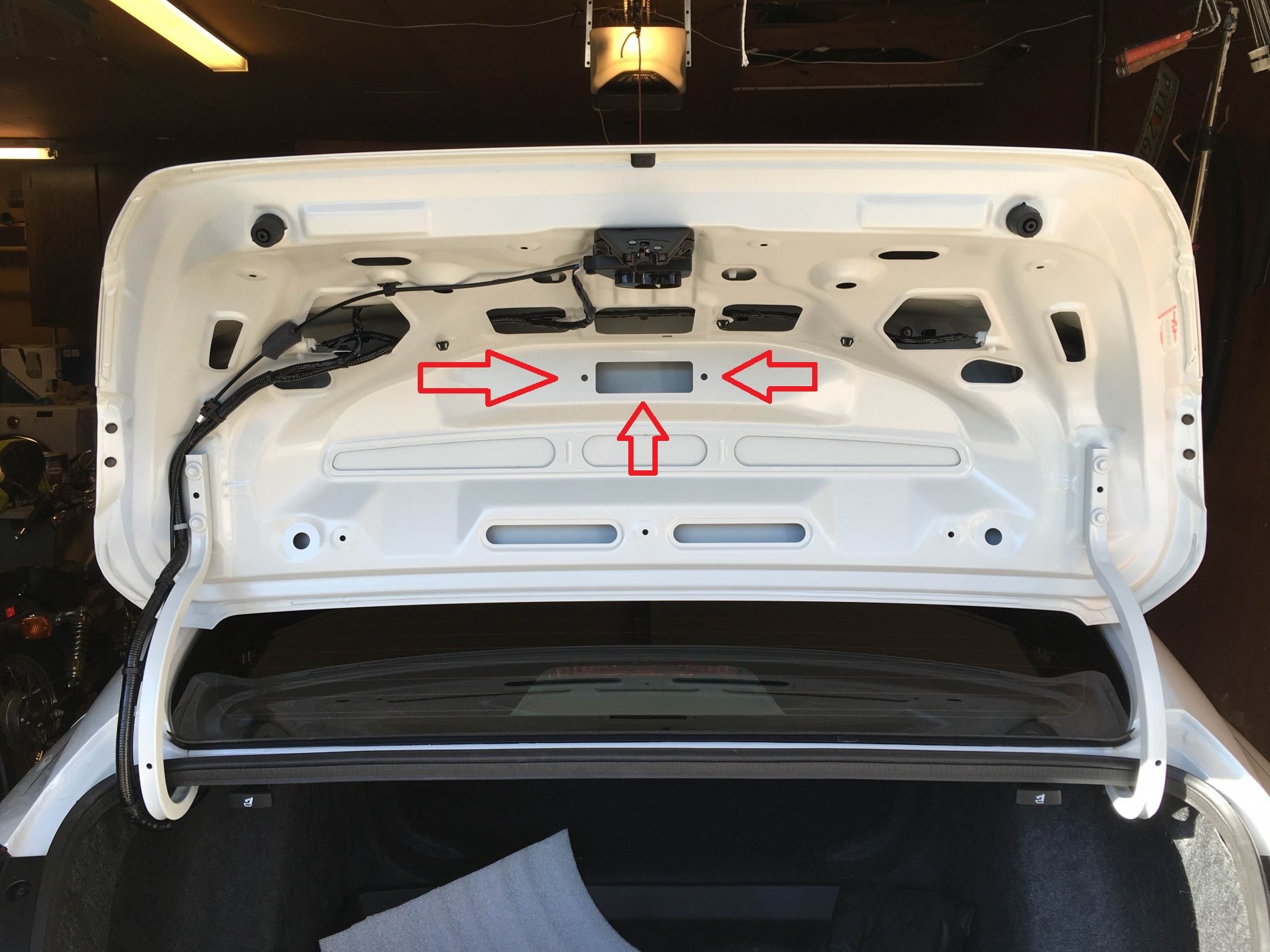

Zabardast MA, aisa na ho jo factory say RS aaye uskay spoiler thore taire ho aur aap ka bilkul dead center:P boht confusion hojayegi Atlas k liye:laughing:
hahahahanai nai ... factory mein RS ki trunk holes wali hoti hai ..so the holes are there already
