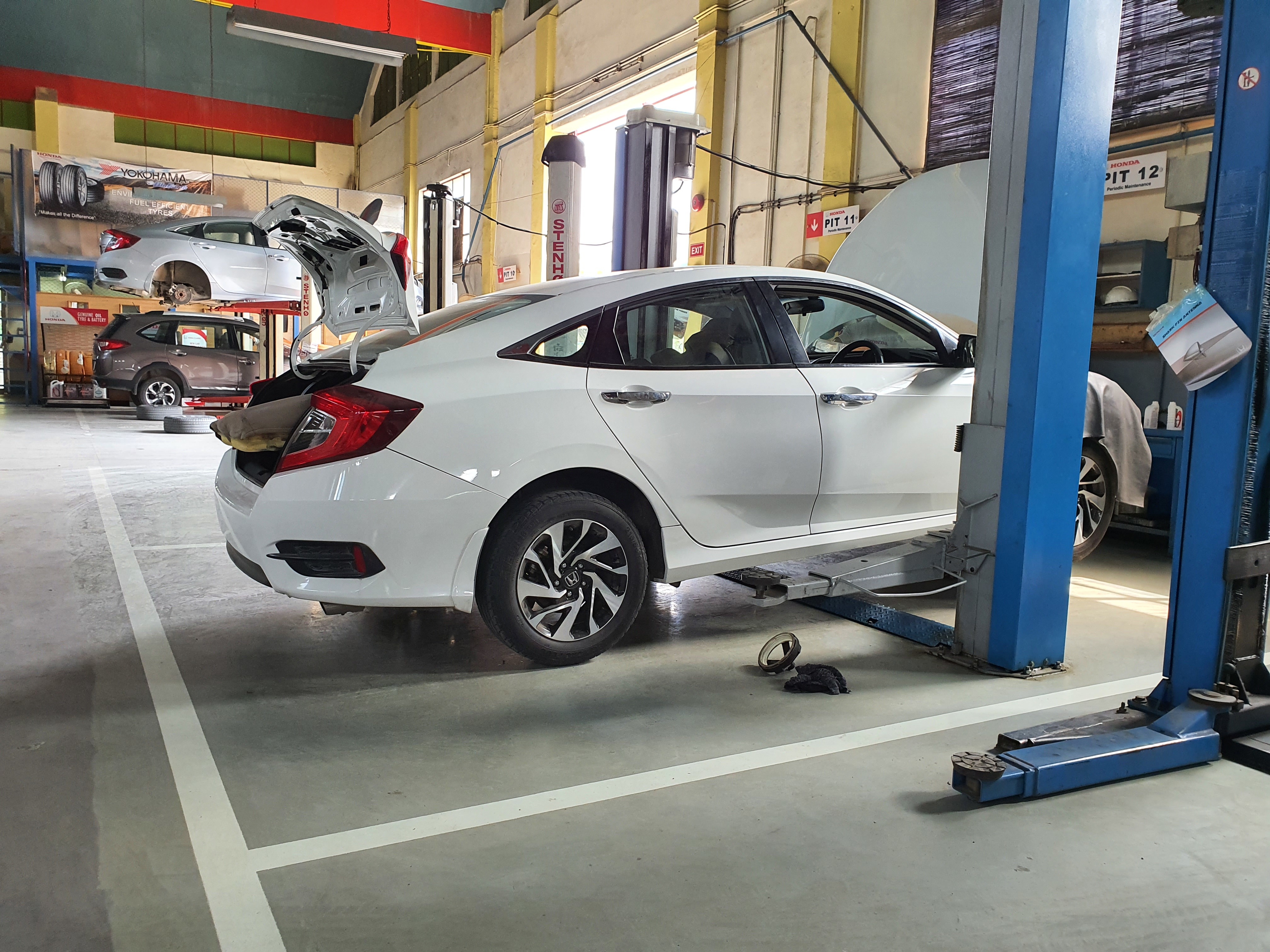

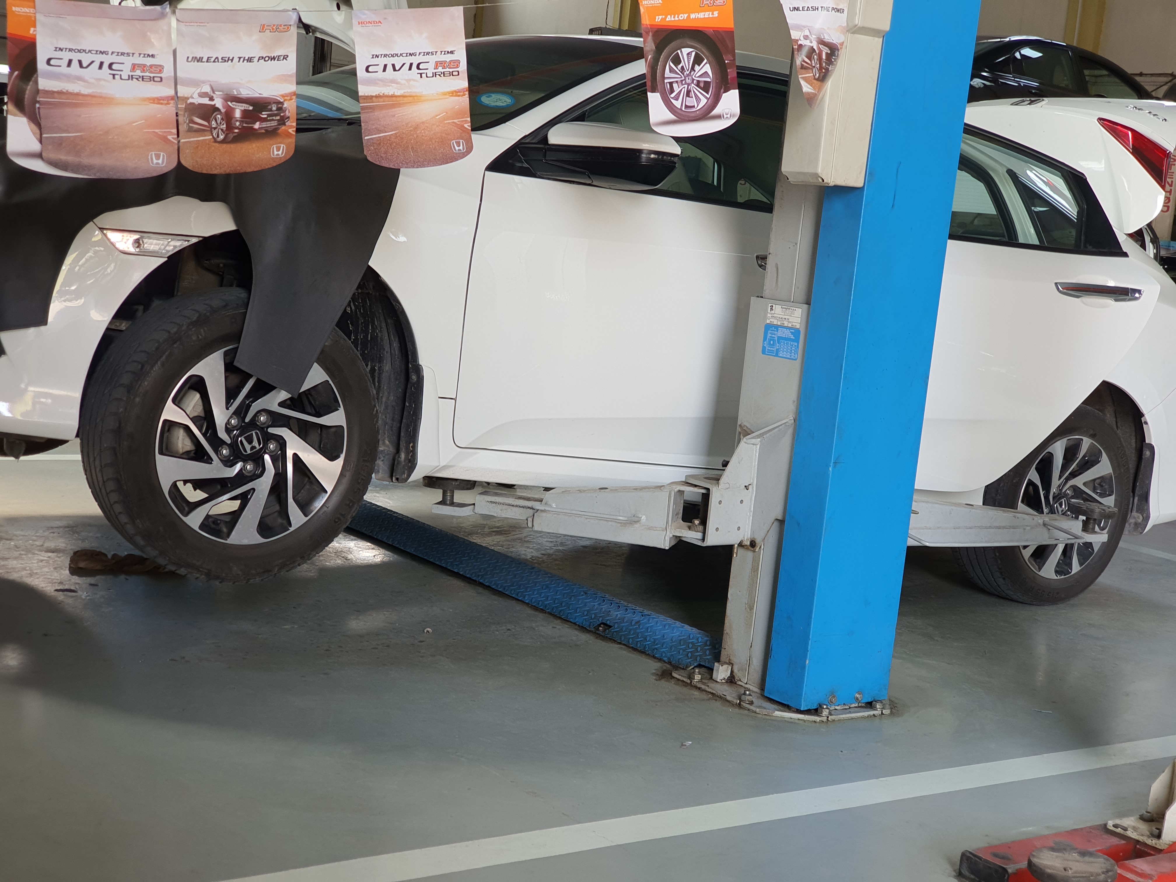

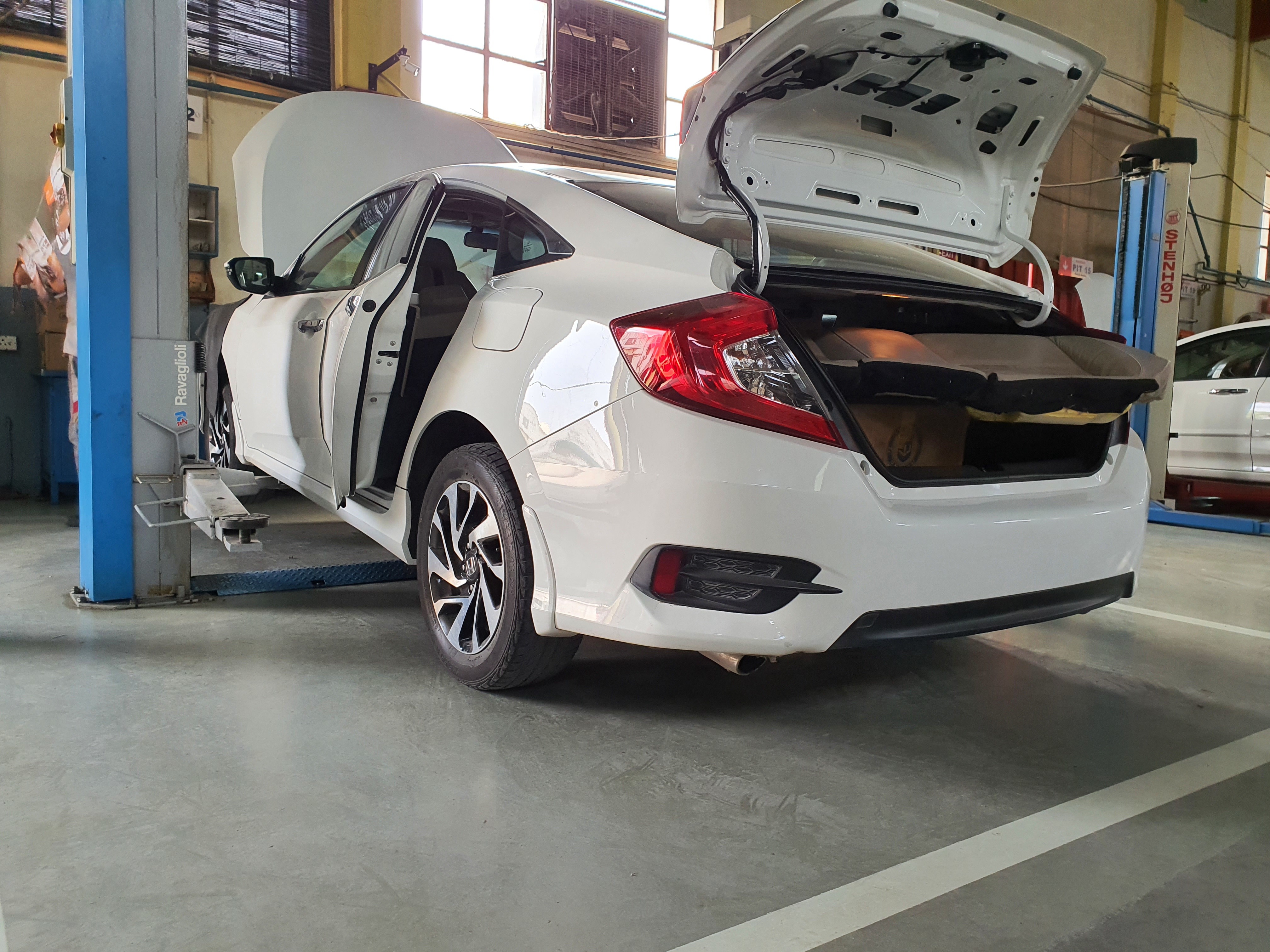

They lifted the car from front because the fuel tank is full topped up.
They had to make this angle to avoid spilling of fuel.

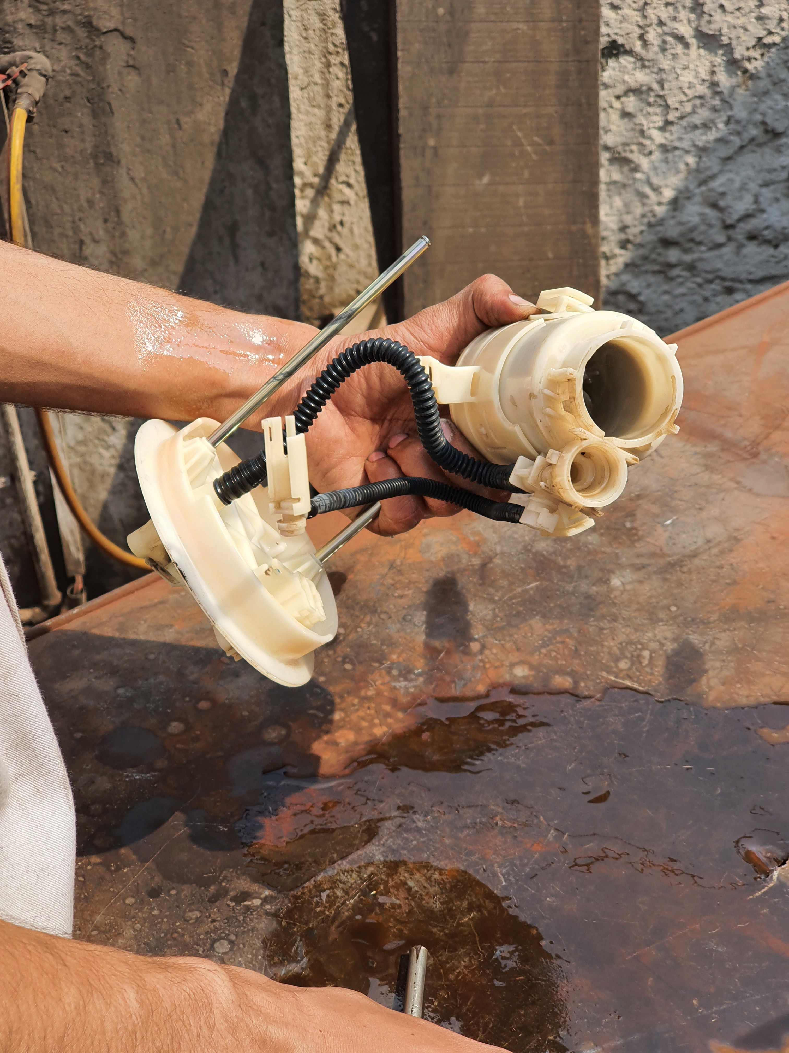

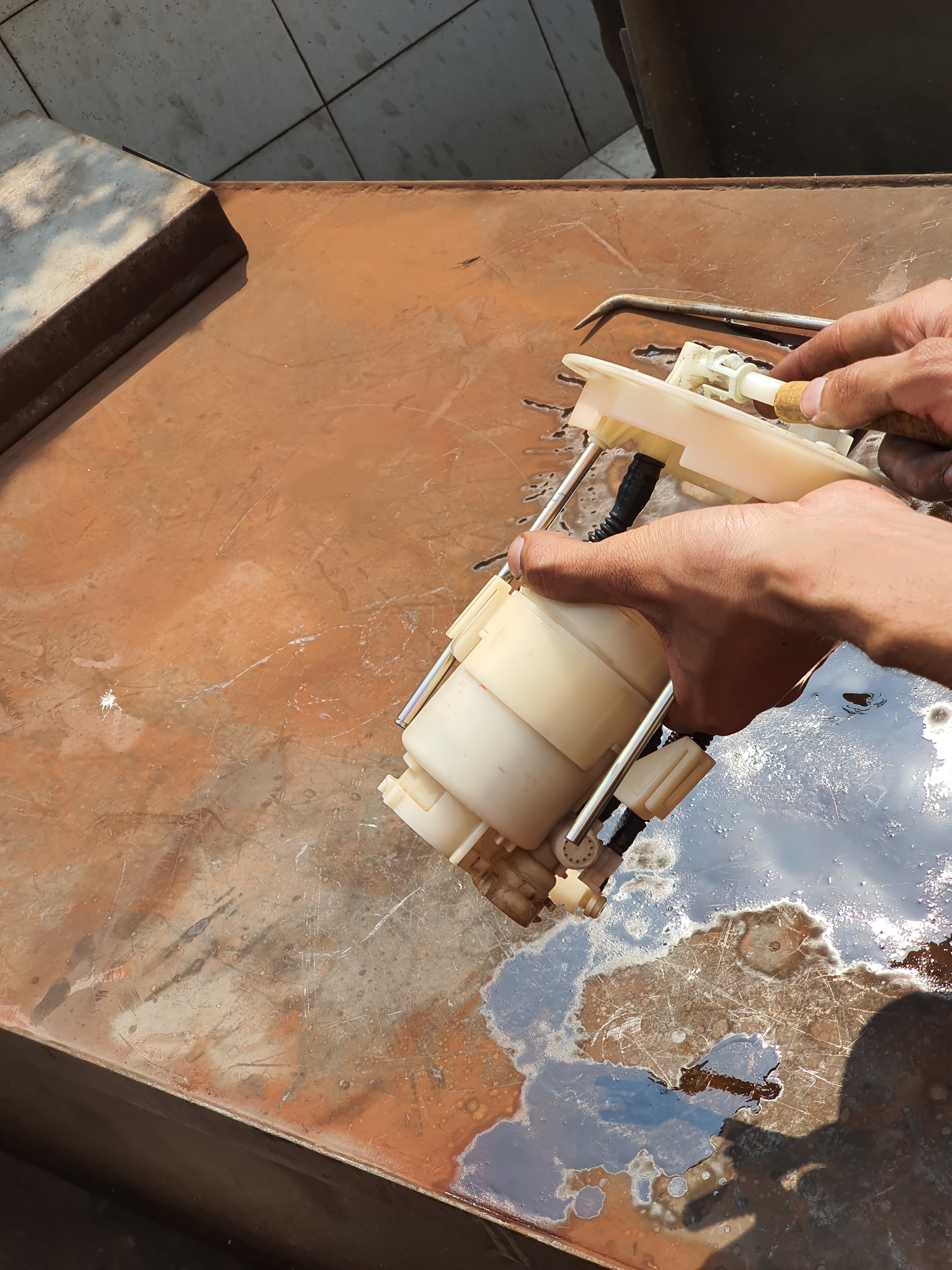

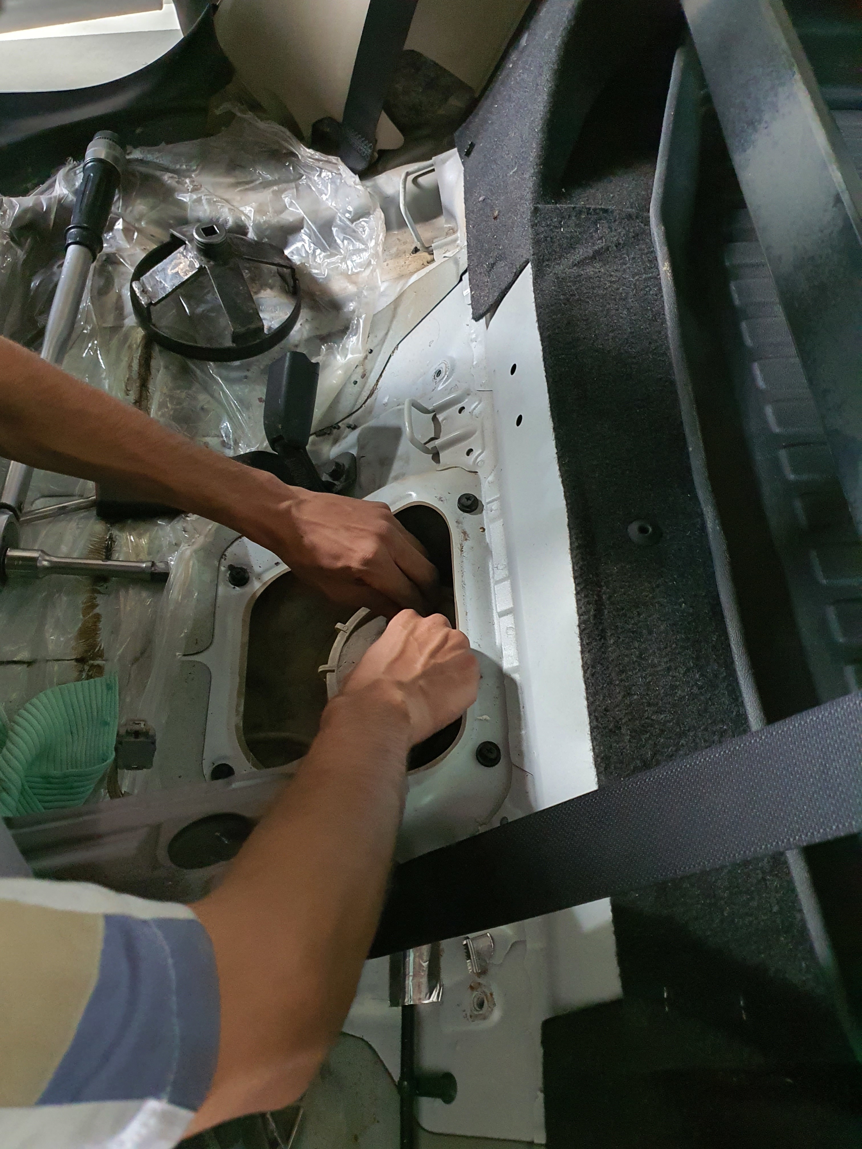

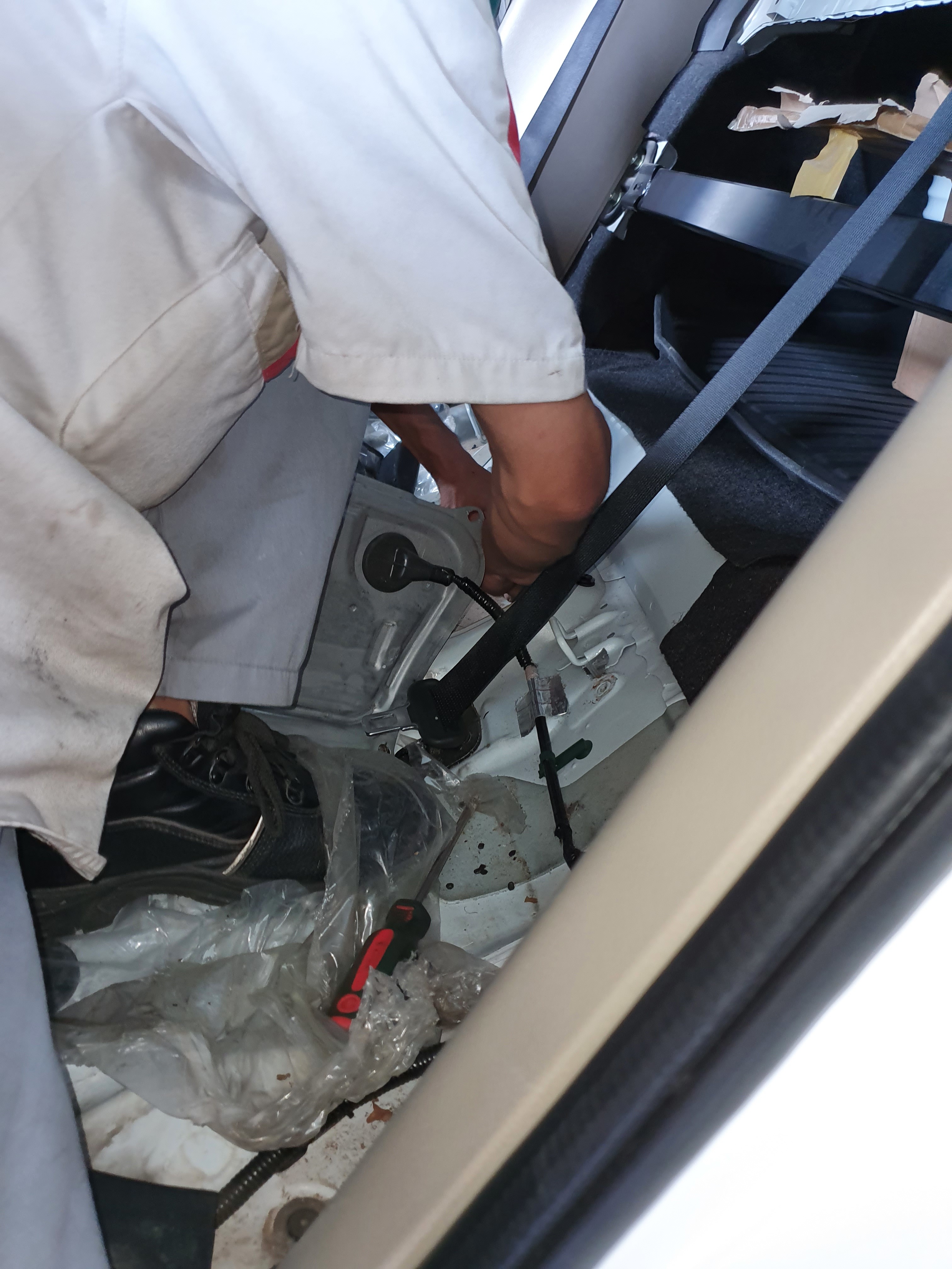

How to clean Honda civic 1.5 Turbo fuel filter.

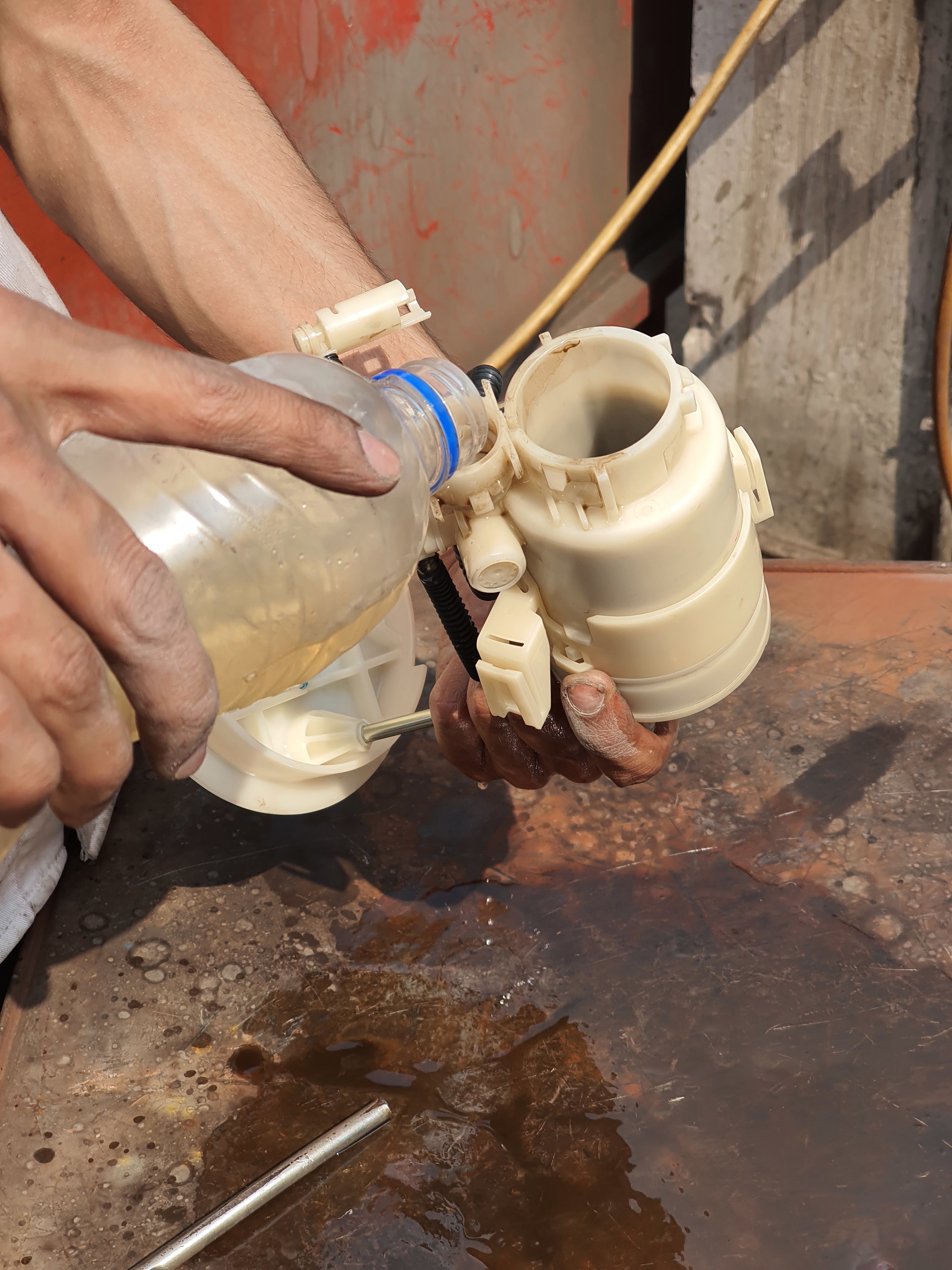

Decide not to replace the fuel filter because of its price.Instead I got it cleaned.

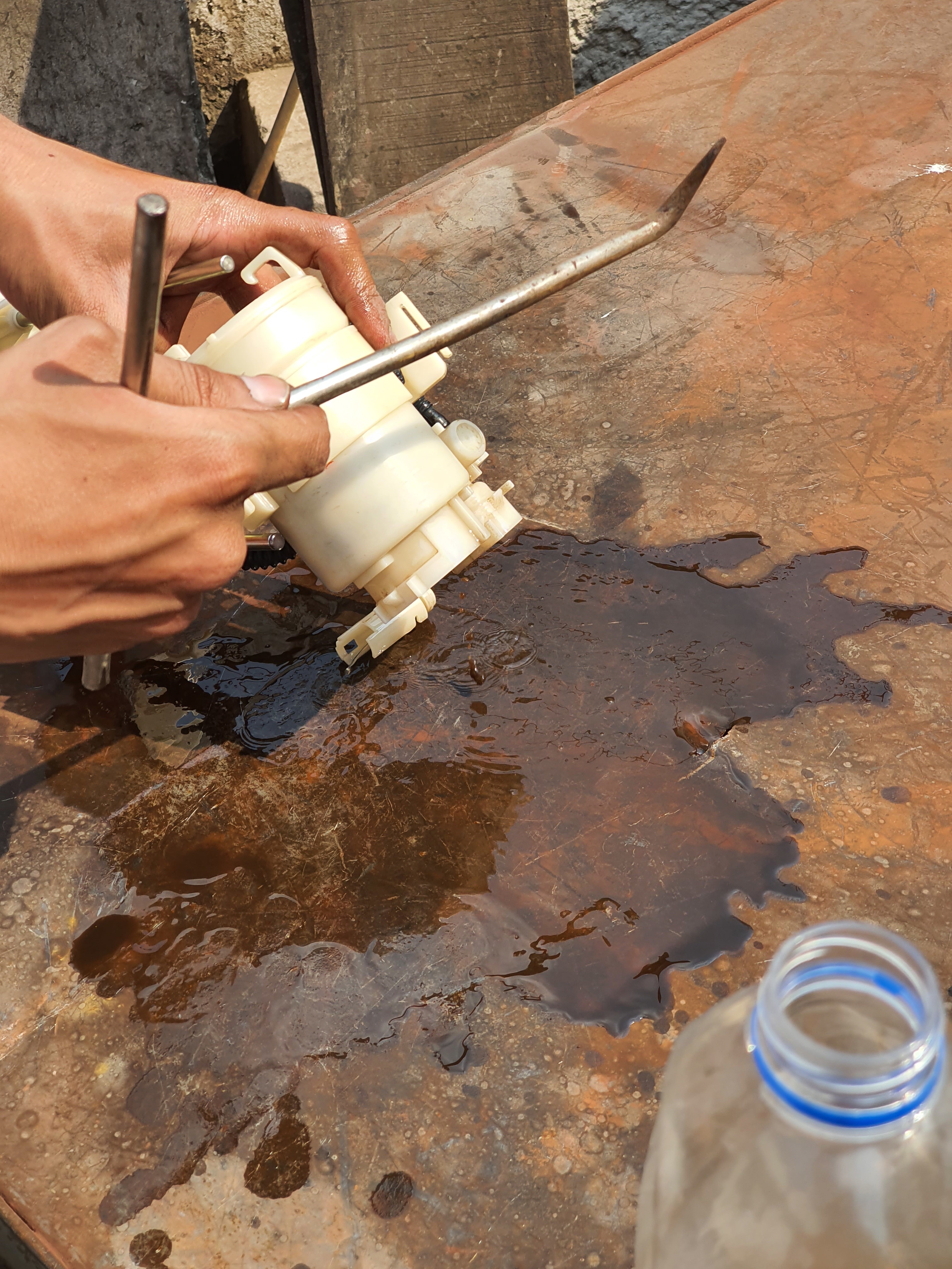

put some Petrol and tap/knock/hit it and then apply back pressure using air pressure
We repeated this process for about 15 times unless the fuel that was passing opposite direction got almost clean.

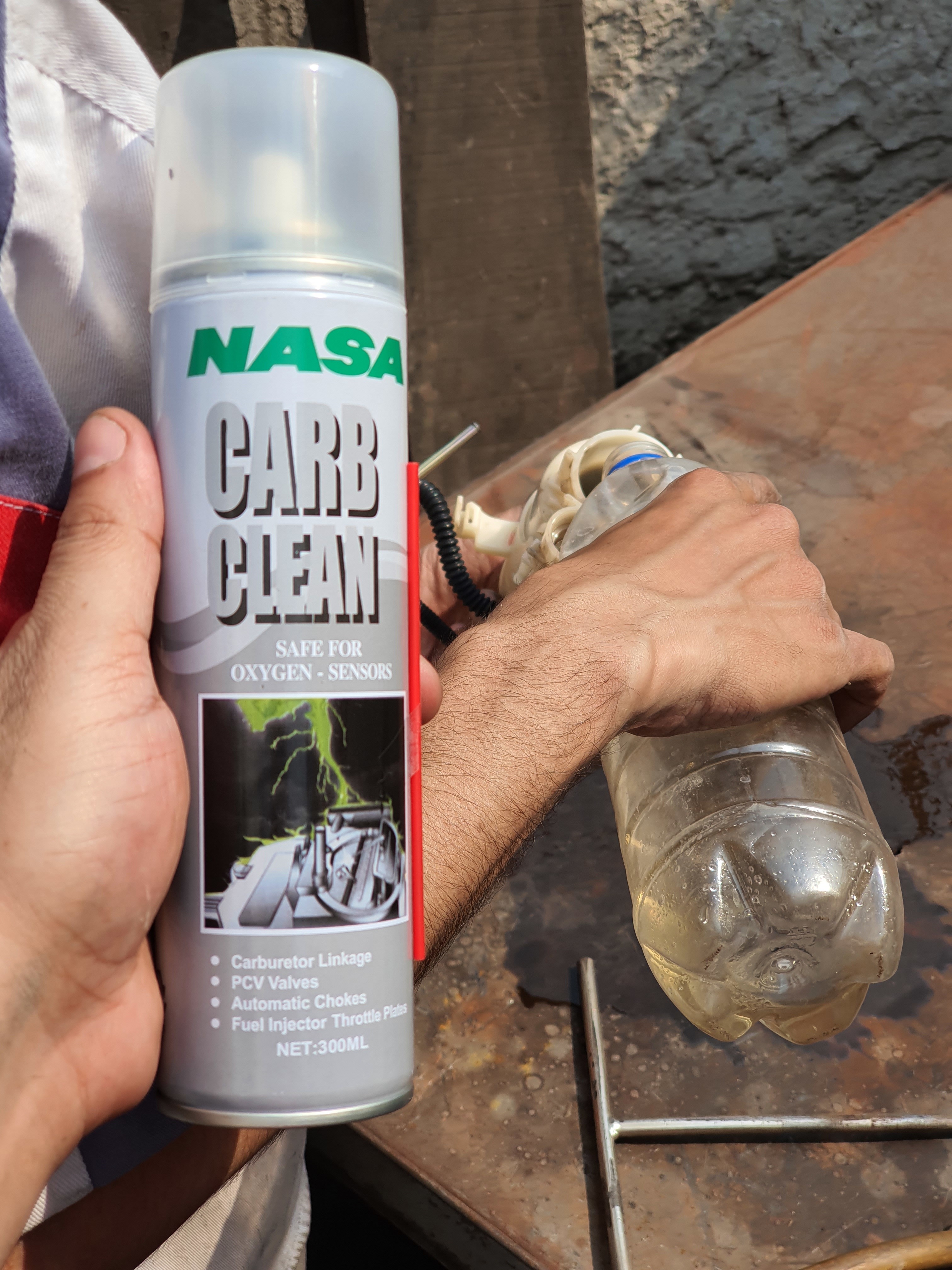

Then I repeated the same procedure for about 3 to 4 times but this time, I used carburstor cleaner spray.Now the fuel filter is as good as new..This whole process was a lengthy one and took about 45 mins only in cleaning..Pouring fuel from outlet side
Applying pressurised air from outside side .
Repeating the same procedure using carburator cleaning spray.

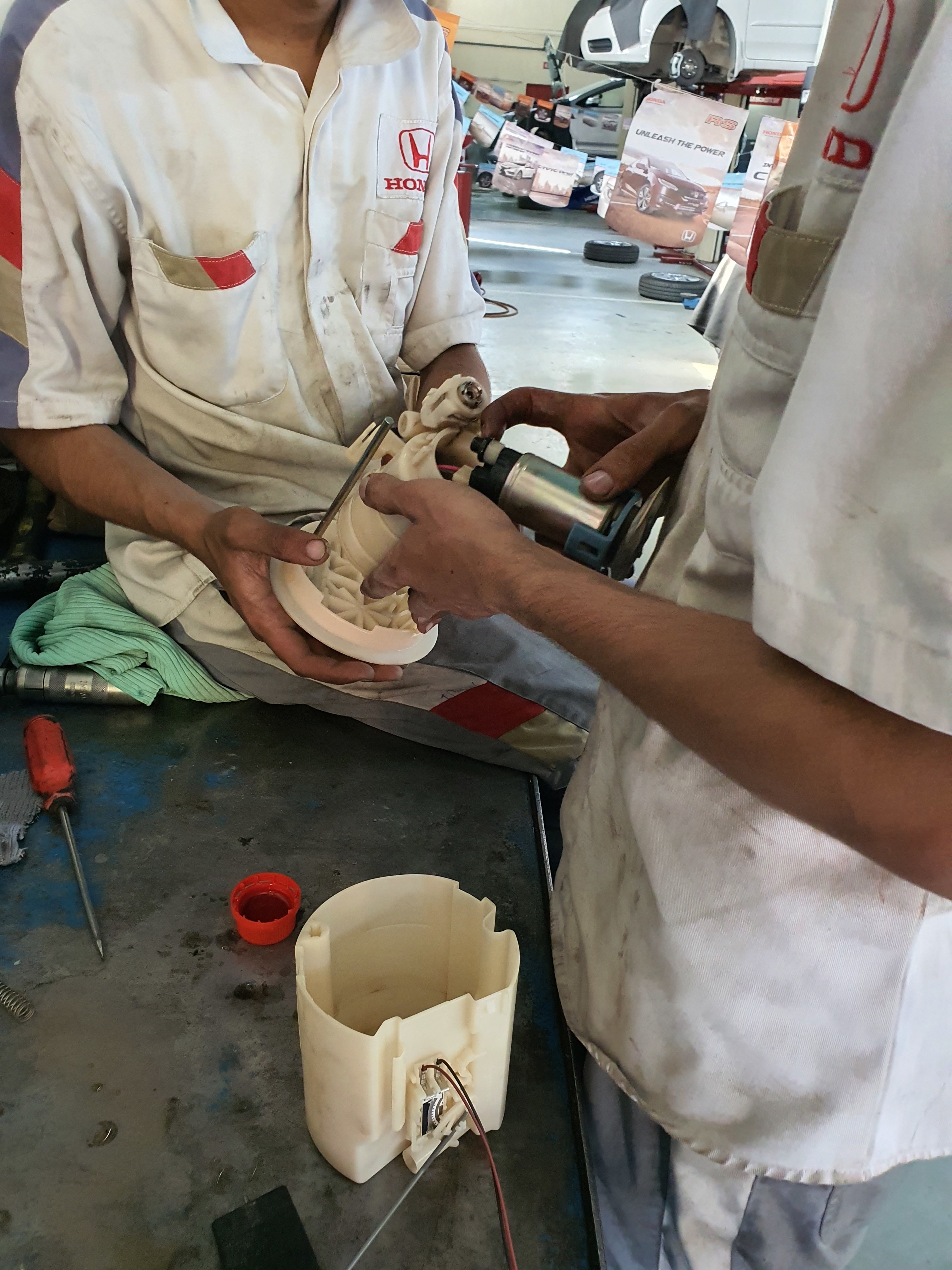

Assembling of fuel filter and fuel pump assembly.
