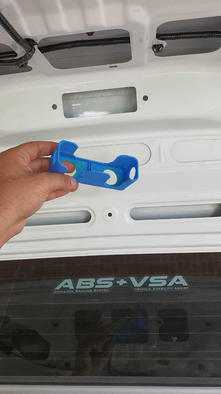

I am making a part to find the dead center of trunk.I made this CAD drawing.Round holes are just to reduce the material nothing else.I just need the shape with the slit in the center.
now 3D Printing it .

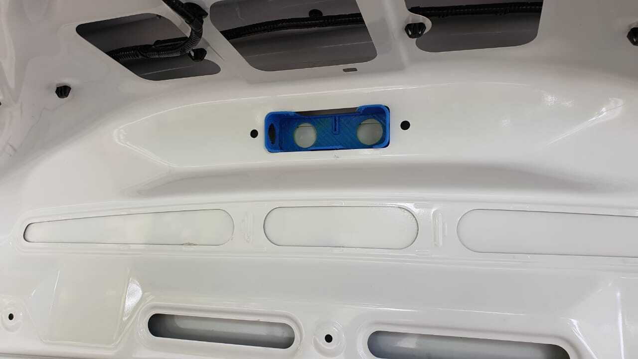

I will put this part in this sectionand the slit in the center will give me the center of the trunk.
I have not done it before. but logically I think I will achieve my goal

Ehtesham bhai is piece say hoga kiya? it's only for finding the dead center ya koi aur bhi purpose hay iska?

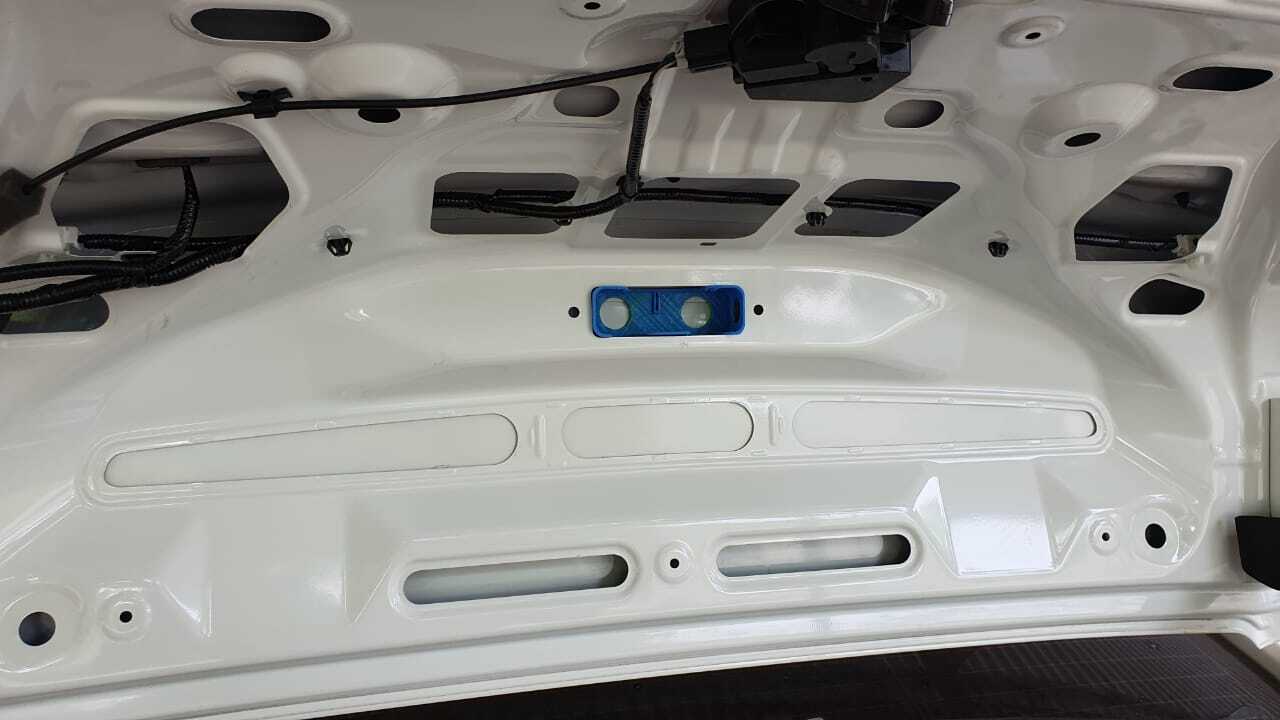

only to find the dead center of the trunk.so that the spoiler is not to any of the side..This part will help me to find the center by an accuracy of +/- 0.1mm

its worked perfectly.
it was sized to perfect fit the slot.

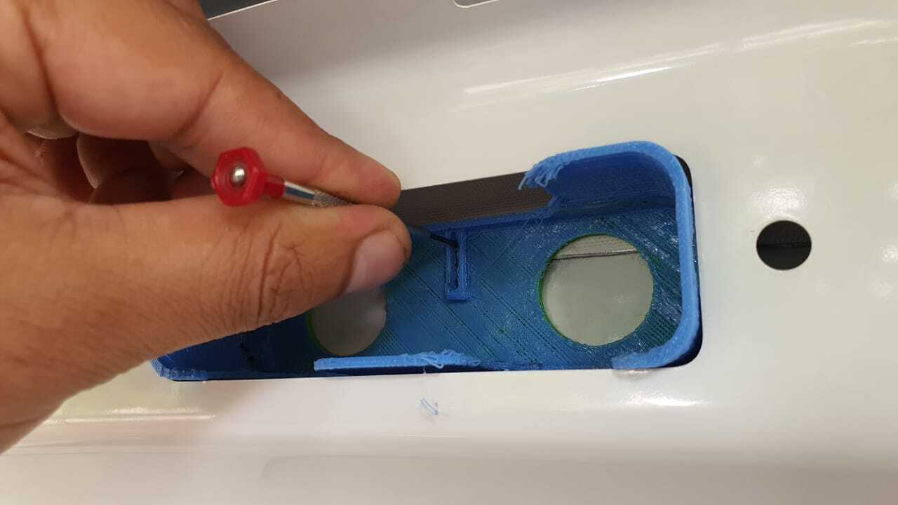

The slit on the center of the CAD designed part will give the centerThe slit is only 1mm wide, so I have to use the smallest screw driver to mark the center..
