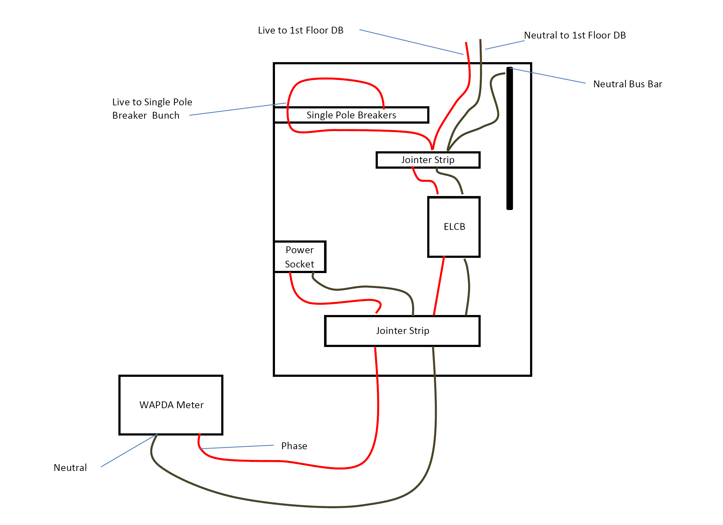

Case 3:
When you have plan only for 1 ELCB in house
1- Install ELCB at ground floor DB not in 1st
2- If 128 AMP ELCB available then go for it if house load is expecetd to >63Amps.
Follow below points for this case;
a) Wires from meter will come to 100AMP jointer strip 1st
b)there will be 2 outlet of jointer strip, 1st will serve as input for ELCB and 2nd will serve as input for power socket
c)Wires from ELCB outlet will again go to jointer strip. Jointer strip outlet again have 2 points, 1st will be supplying electricity to ground floor DB circuit, 2nd outlet option will supplying current for 1st floor bunch. This whole circuit will be of 7/64 or 7/52 as per requirement. Dont go for 7/44
Pic also described below;
