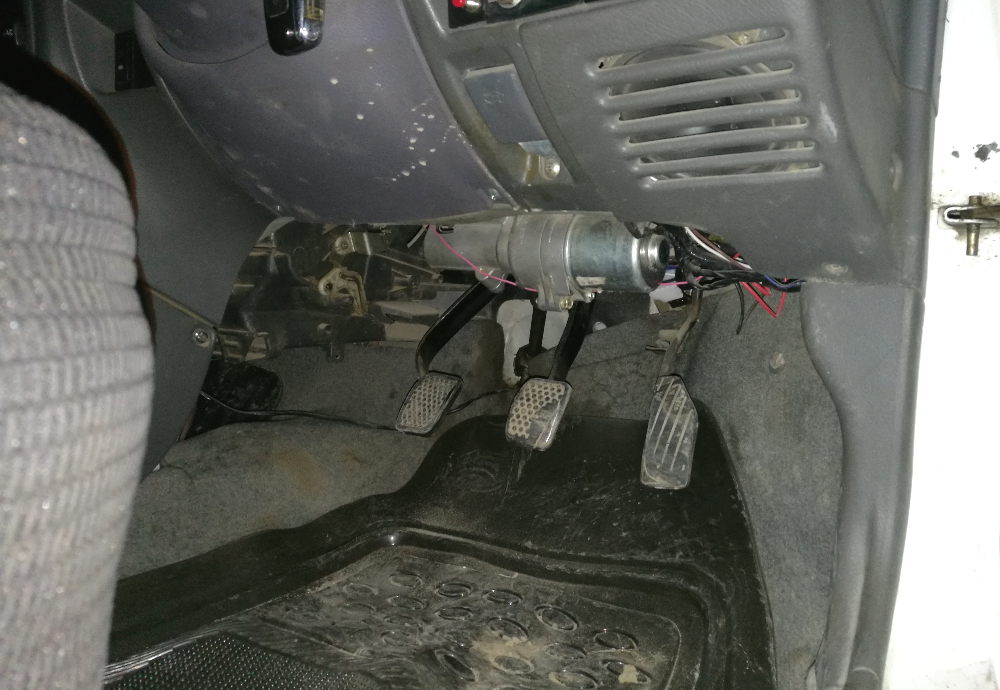

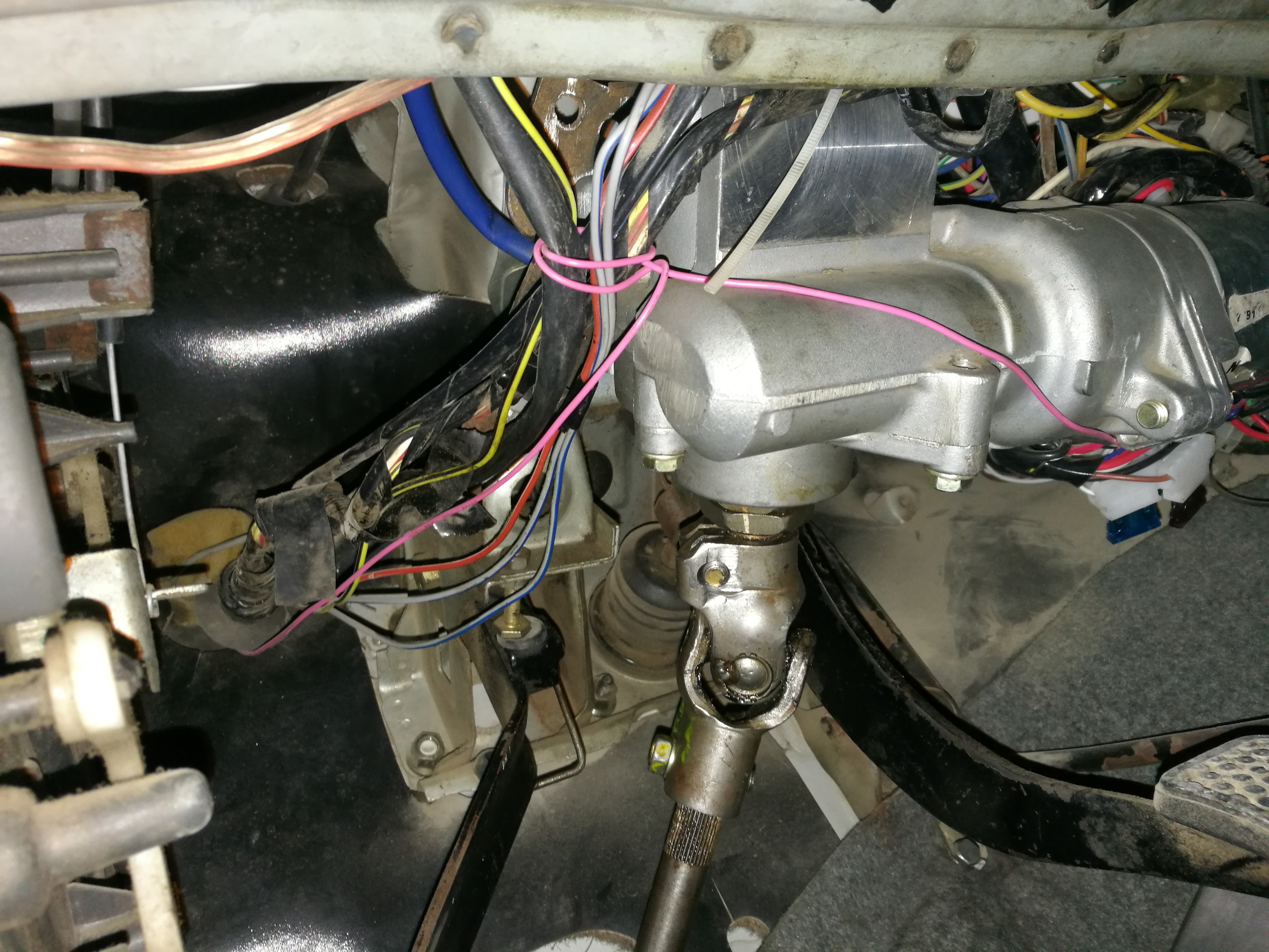

can you share pictures of installed setup?
didn't find any of installation time. Here are some that I took right now. (ignore the wiring mess, these are of security system+centralized locking etc).
