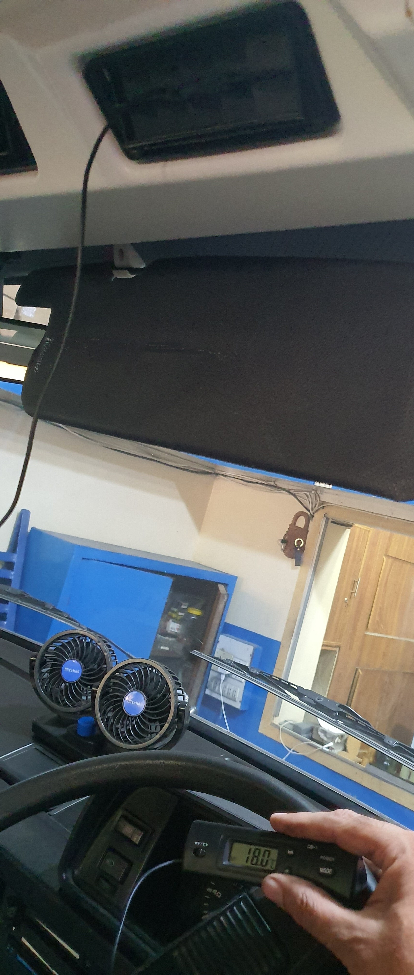

I restored a 1985 VW van. This car had R12 refrigerant which has become illegal since 1997. The van ac system had to be converted to R134a. Much work was done and in the picture below you can see me checking the ac temperature using a digital thermometer.
Click on the picture to see full image in this picture temp is 18 degrees which on the test drive dropped to 8 degrees.
