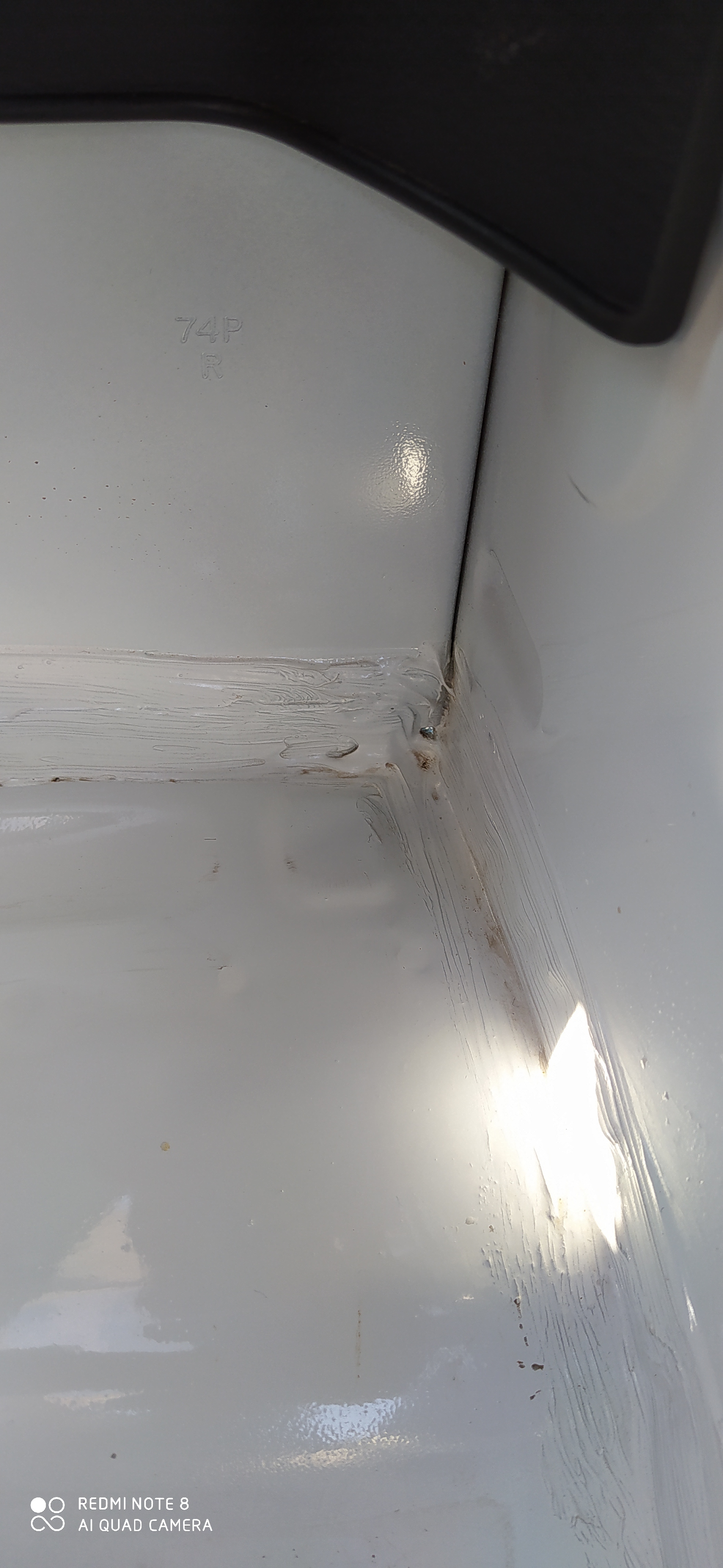

Improper insulation in the trunk leading to perforation of water inside.
Where is this???? Post proper pics. What area of trunk?
