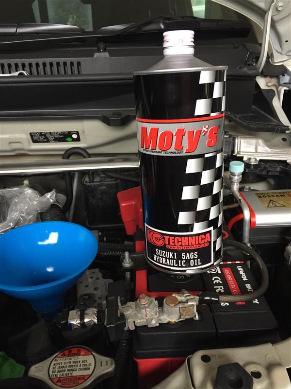

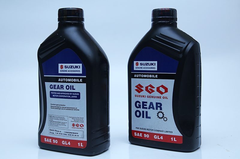

don't do that, just waste of money, always pour correct grade when it's availabe
Nop, actually 75w is not available in other brands, if you need 75w urgenty, I know owners who have 75w in opened packing (cultus owners with 1.5L remaining oil in pack) you can purchase from them also save bit of money by not wasting 0.8L
yes recommended grade for wagonR is 75w80

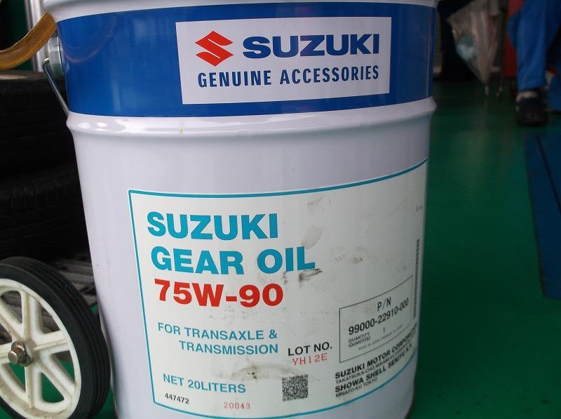

for alto and cultus and swift manual it's 75w90

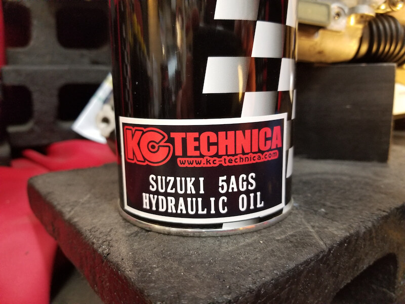

for alto ags and cultus ags it's 75w
yeah, told you earlier, pouring wrong engine and gear oils is their job...
