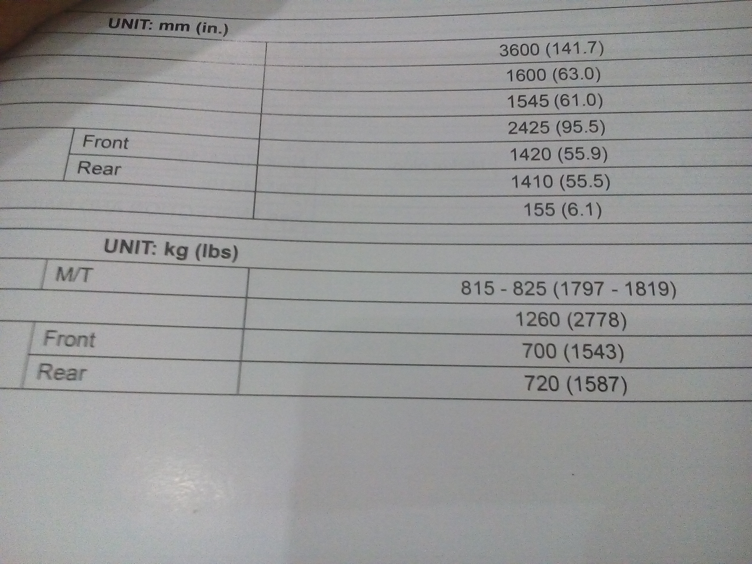

Dear kafi Research ki jaisa k ap janty ho..................
Cultus Euro 2 Engine Specs
Engine type G10B (SOHC)
Cylinders 4
Bore 72.0mm
Stroke 61,0 mm
Compression ratio 9,5.1
New Celerio AKA Cultus
Engine type K10B (DOHC)
Cylinders 3
Bore 73.0 mm
Stroke 79.5 mm
Compression ratio 10.0.1
