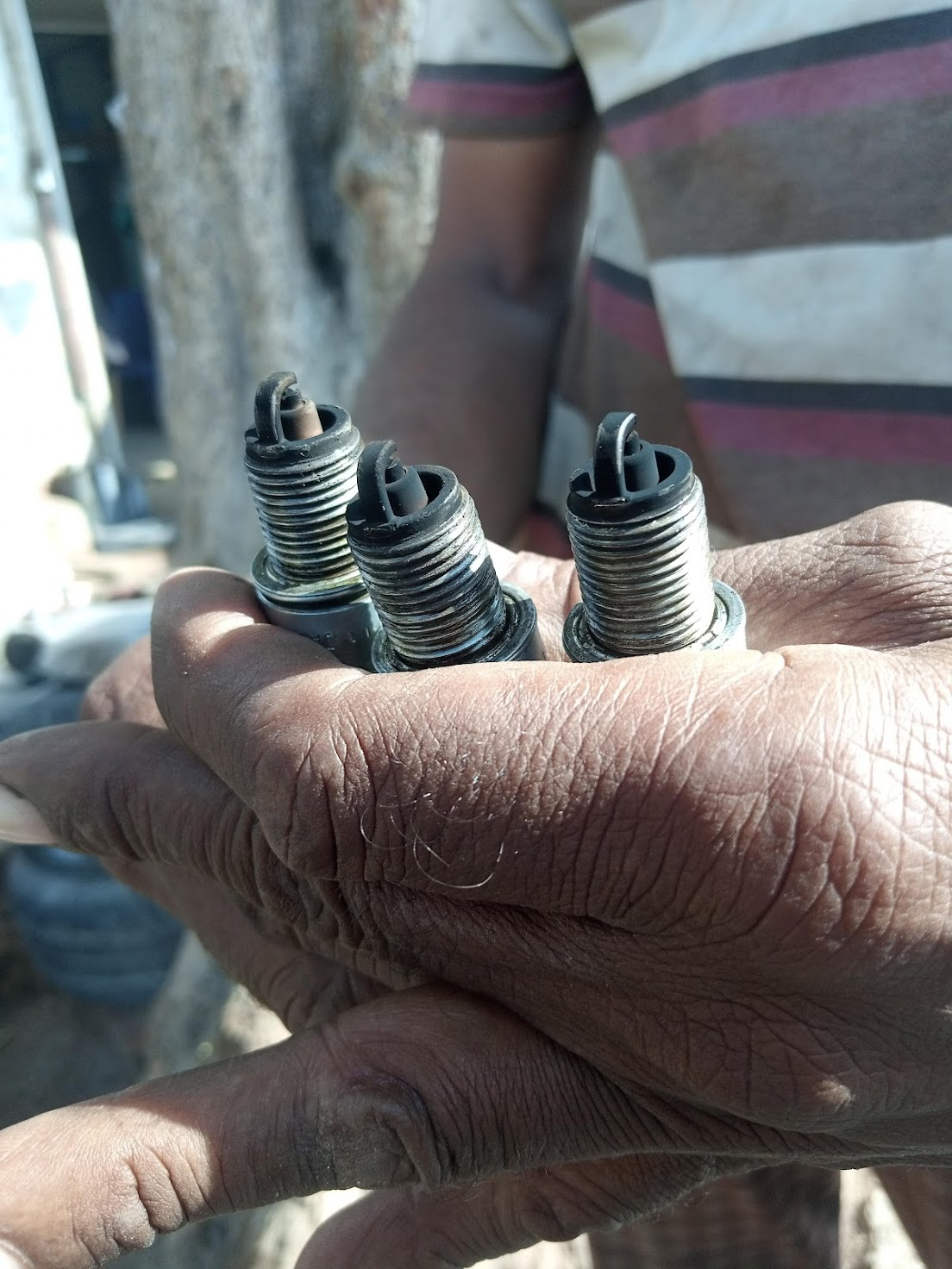

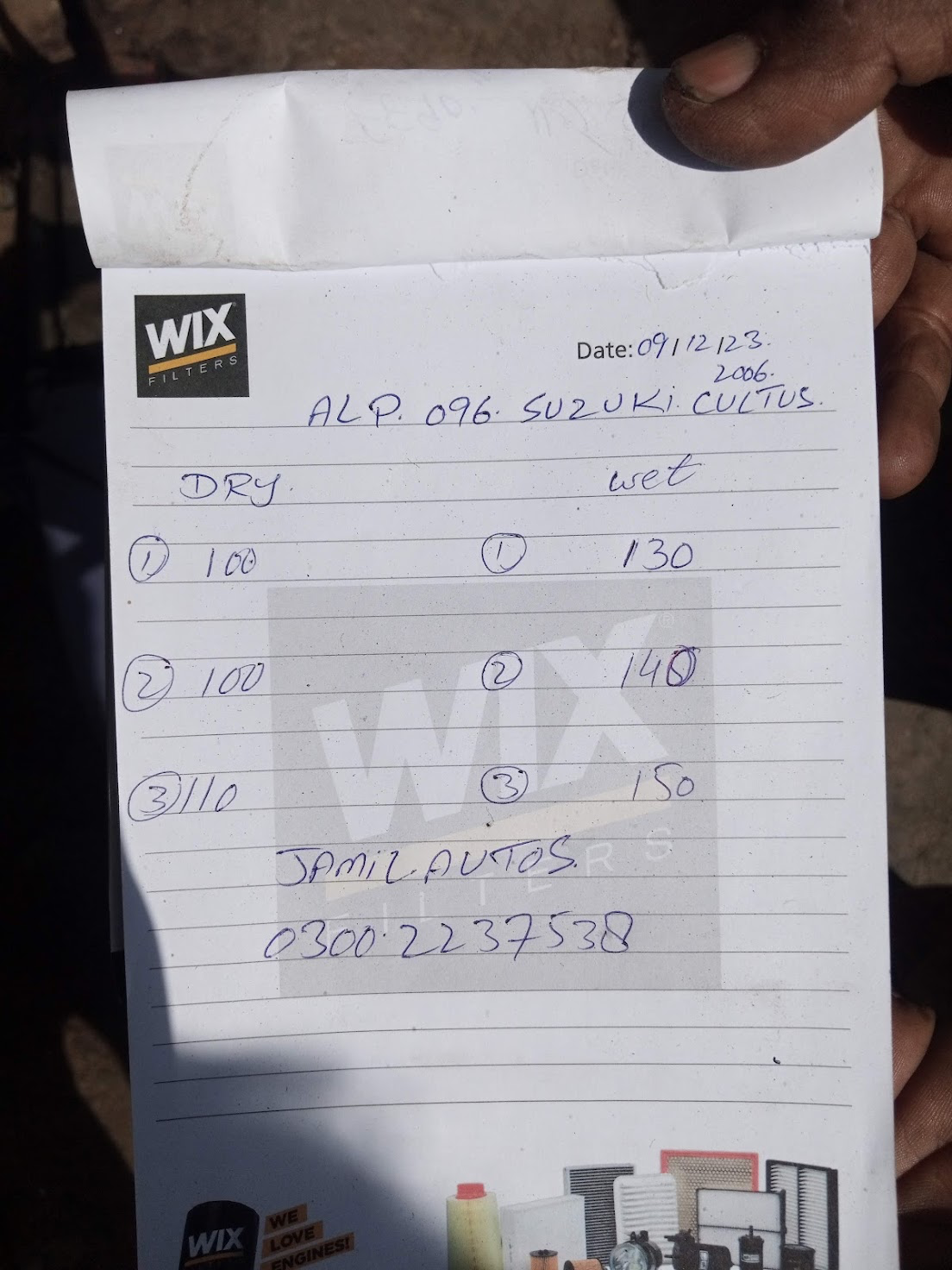

Went to Jameel Autos, met Irshad, who conducted a compression test and timing check, compression test was alarming, have a look for yourselves. Plugs were blacker than the night, but had them cleaned to put back in.
During the wet testing, the compression numbers were much higher than dry testing, but something I noticed with all cylinders during wet testing were that as soon he'd stop cranking, the needle on the meter would begin to fall, he did each cylinder twice for dry and wet, so the second time for the wet test of the cylinders, the needle would loose compression a little slower than the first time when he would stop cranking the engine.
He did say that engine will need to be opened due to weak piston rings, and we should be prepared for a decently hefty expense. But for now, if there is no oil reduction, we should be fine for now. As fuel average being a main concern, he said with this adjustment I hope it works out, but if it doesn't, then come back and ill have a guy take a look.
