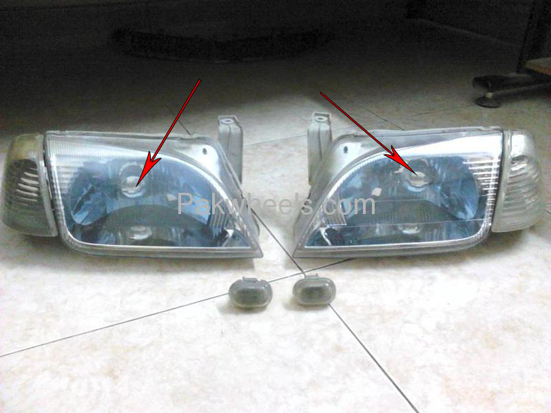

Your Kenchi seems fine(or atleast seems fine in pic) but anyway u replaced it.BOL:)
90/100 Watt bul brand u mentioned is crap. Cultus wiring & fuses are not capable of supporting 90 watt(Even if relay is installed) or other option, install heavy wiring for 90 Watt bulbs
Cultus original wiring can maximum support 60-65 Watt
USE ONLY PHILIPS 60/65 WATT.Their light will more luminous than 90/100 watt koito/koyo/bosch/Lambda atc.

Light Assembly is broken yet.Found no one to repair it
