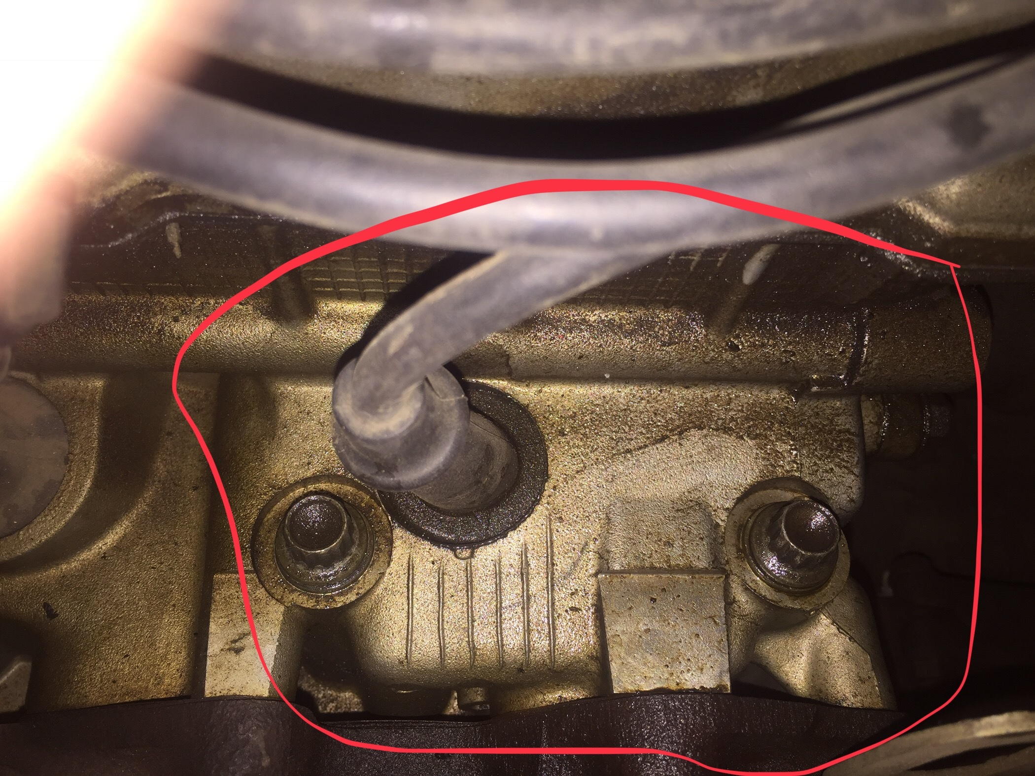

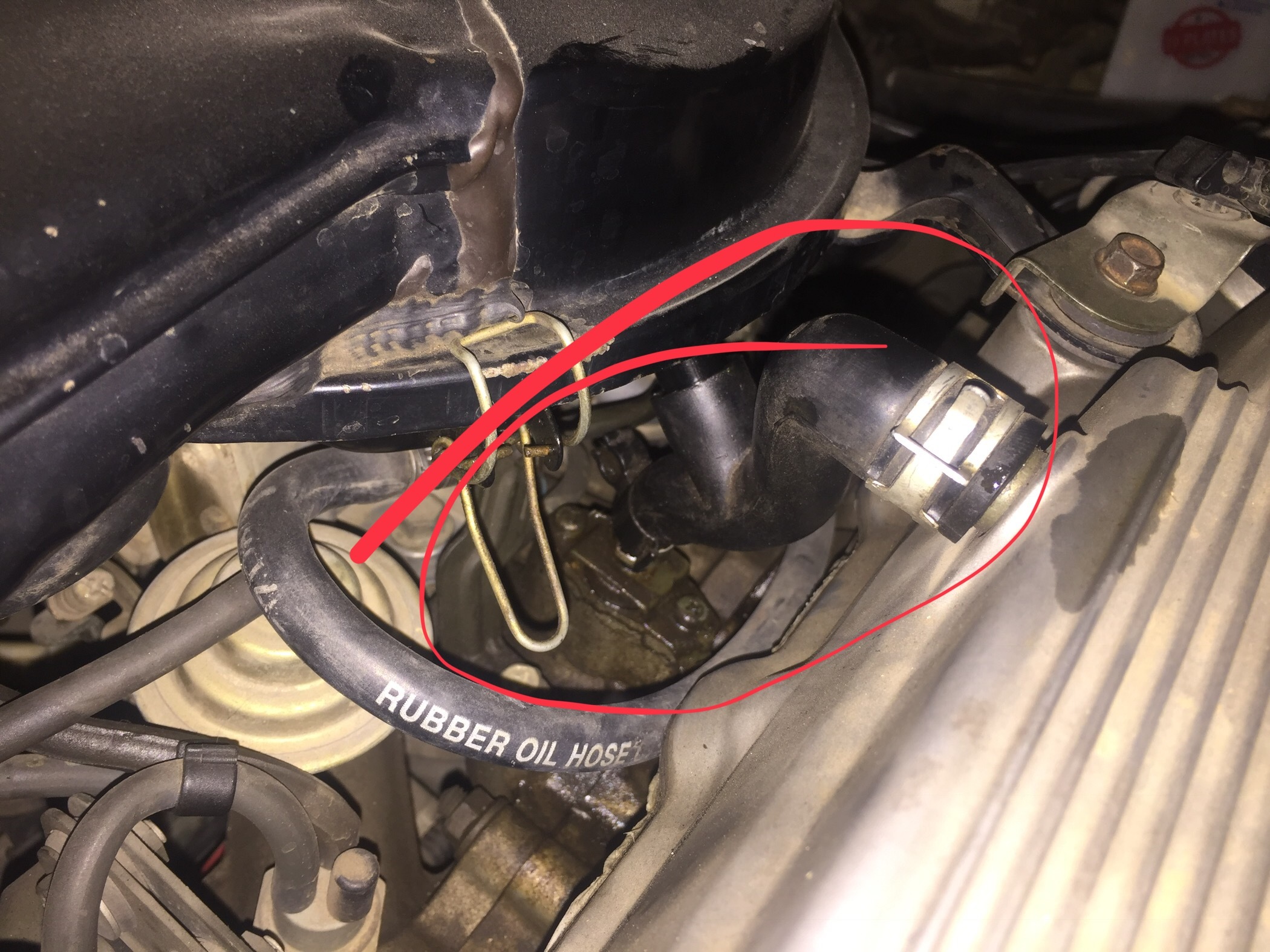

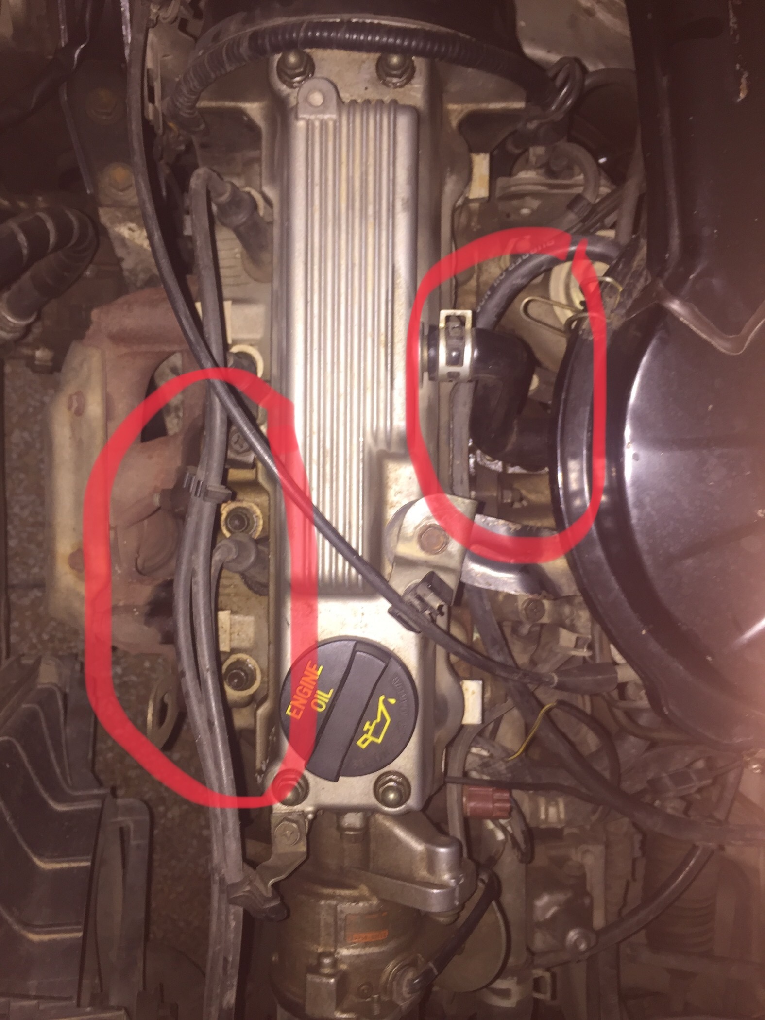

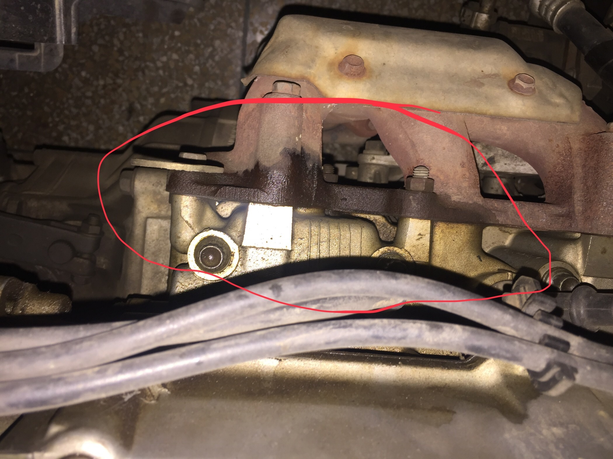

I have cultus 2005 which has 80k on the odometer.Today I open the bonnet to check the liquid levels & I found traces of engine oil on two places as mentioned in pics.can anyone guide me from where engine oil leaks?
Valve cover gasket is leaking.
Usual problem of Cultus engine. As per my experience,this happens when oil gets thick/dense/old
