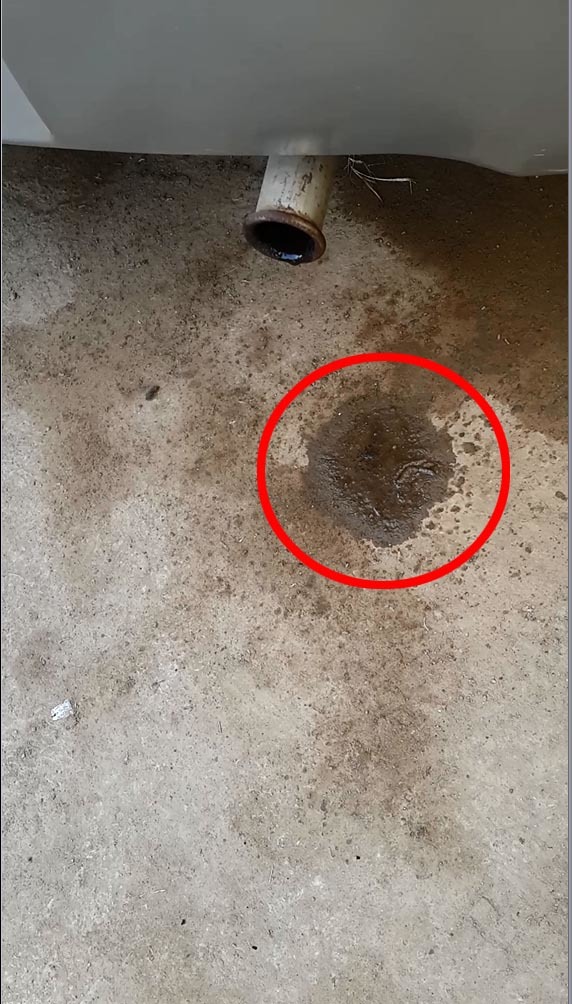

Just want to know if a mild white/greyish smoke is a sign of blown gasket? Bcz this morning after a jump start i saw a mild whitish or maybe greyish (couldnt figureout exact color) smoke for some time. Also car threw some quantity of water from exhaust pipe while accelerating 3 to 4 times.
Blueish or greyish?
Sir i couldnt judge the exact color. I think it was higly likely whitish or greyish

Gasket is blown only if you see radiator is reducing water and engine oil is polluted. Exhaust smoke does not tell anything about that. White smoke could be due to water vapors produced during combustion.
Thanks sir,Water is almost full in radiator and reservoir.
Can u tell me how to treat/stop these water vapors producing in combustion?
ok i attach a pic of this morning. you can see water on the tail pipe and a mild smoke. i feel the smoke color is a bit whitish or greyish. please tell if there is any cause of concern? i wanted to upload a video but cant.
