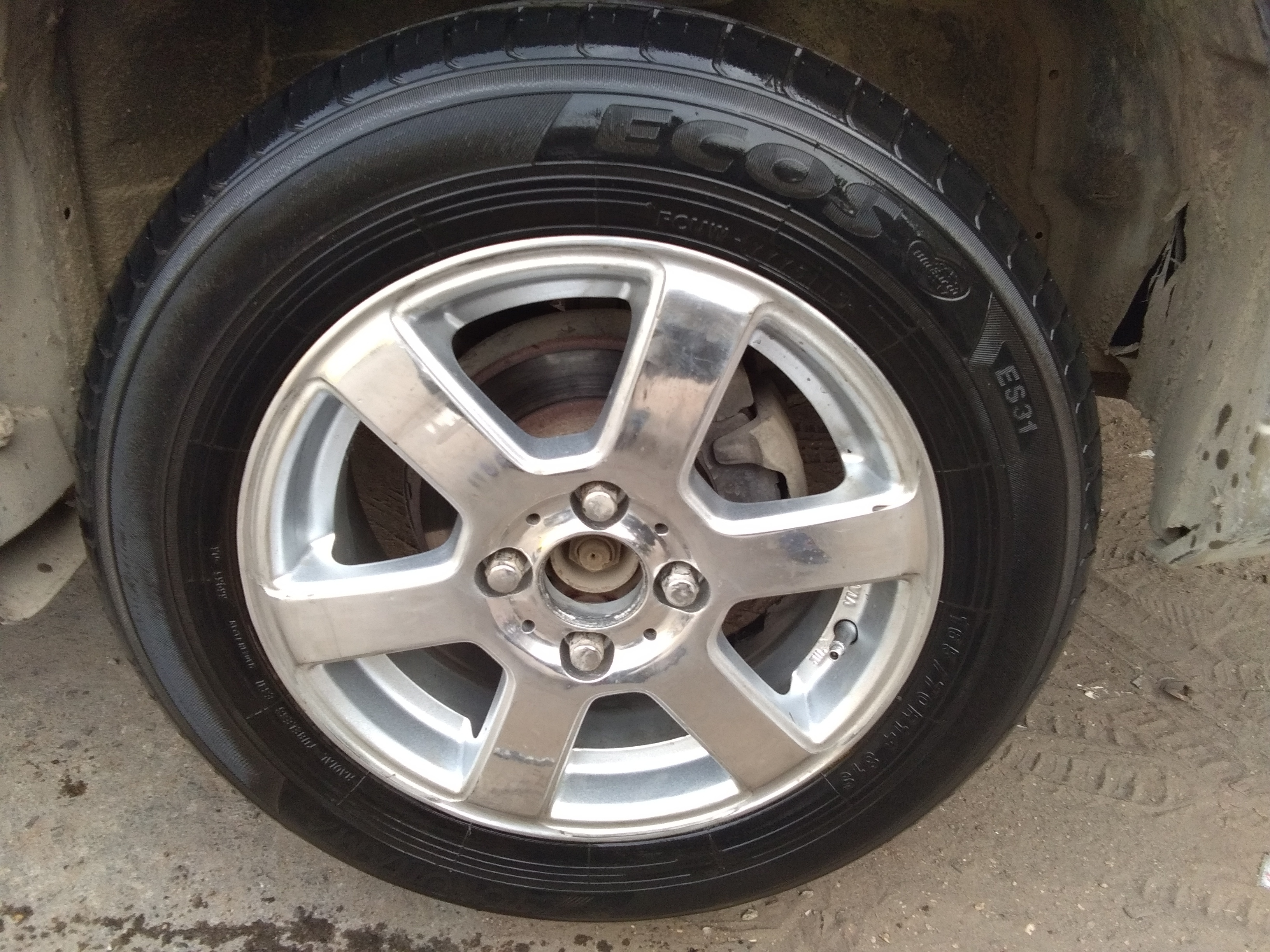

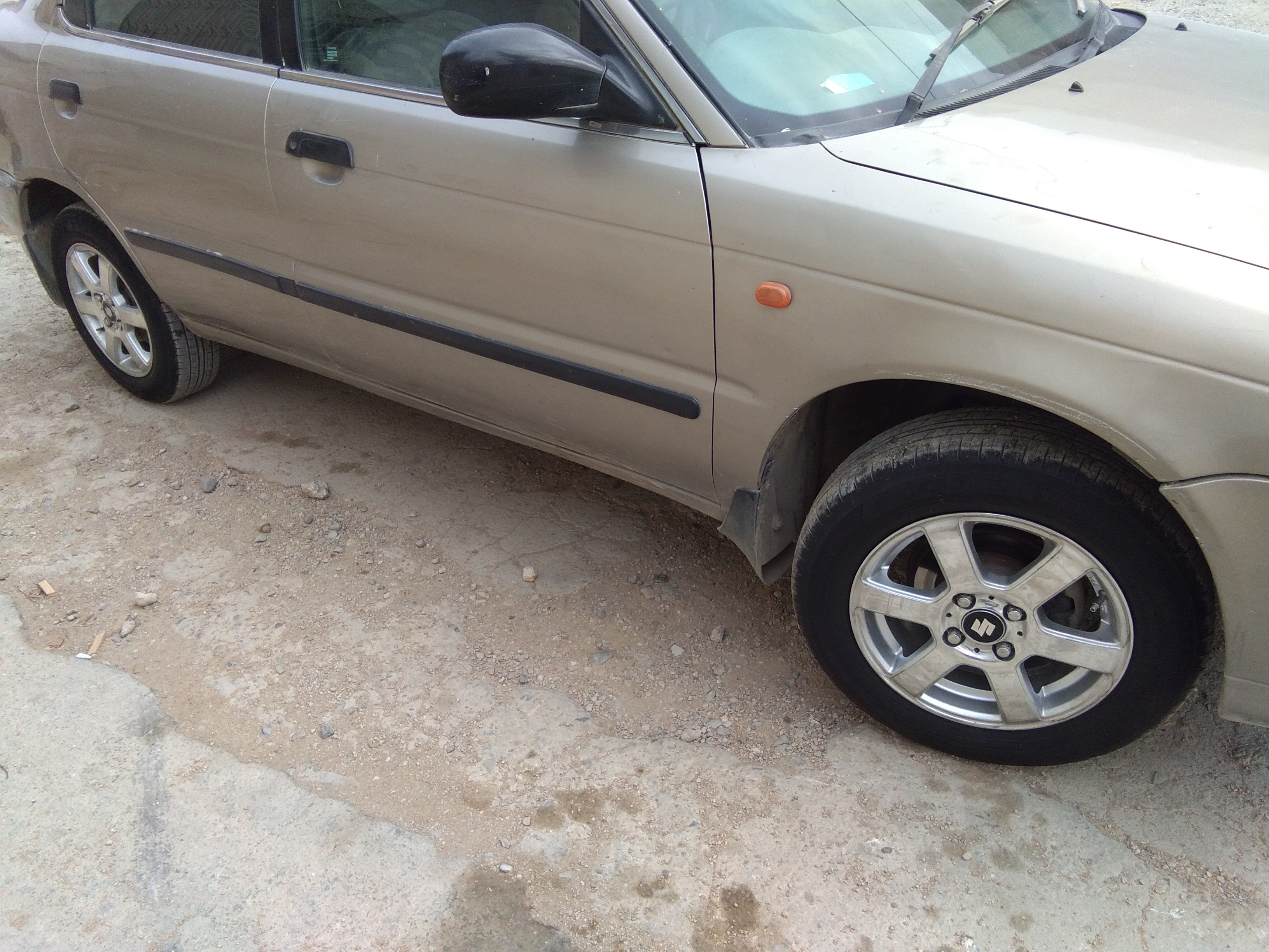

1. Can you calculate in 13K, how much your old "Original Rims" went away and in how much your "old tyres" went away.
Abid bhai jan, i am thinking to change my cultus original rim/stipney with VXLi type Alloyrims, Tyres recently i have added so no need to swap them for next few months. Can you guide how much will be cost if i only replace Alloyrims

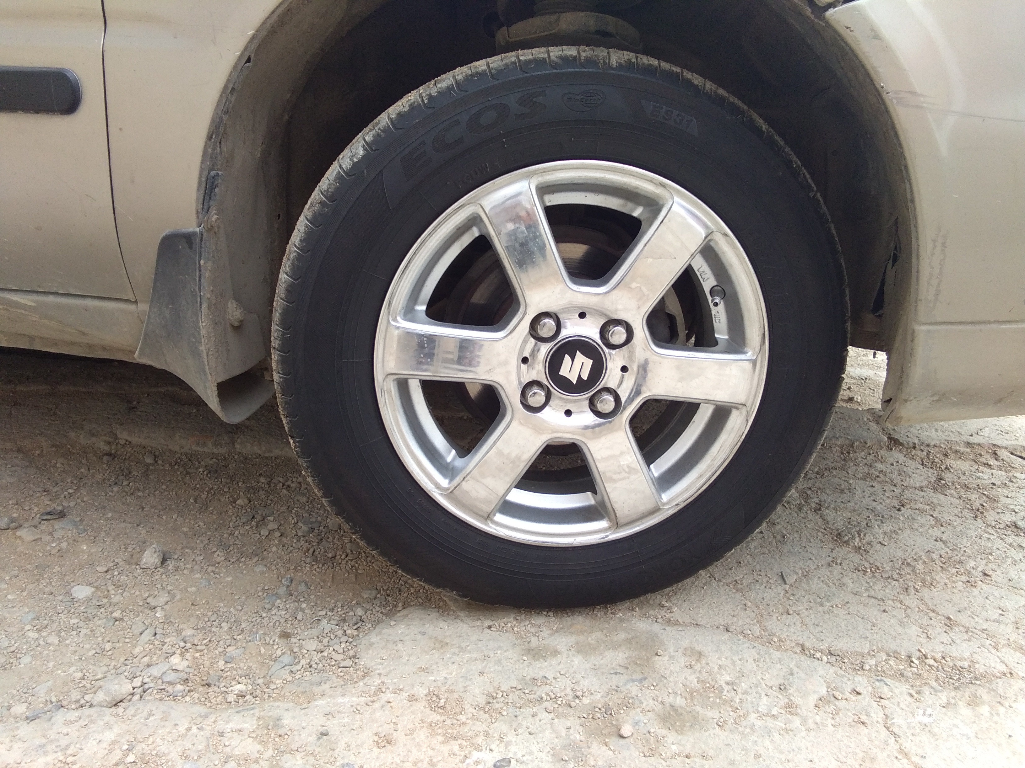

2. In 2nd picture, where is "S" of Suzuki wheel "cap" installed over this Rims.
Btw Masha allah looks nice. Tell us your experience is this 14 incher causing any touch during curve or speed breaker. What is difference in height of car now?
Can i try experiment of 14 incher in my cultoo
after seeing your ones
