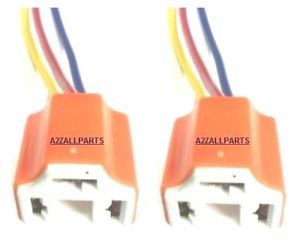

using a 100/90W bulb isn't really dangerous for the wires, the main difference comes with the BULB HOLDERS, more the current passing through it, more they will get HOT and eventualy the low quality bulb holders MELT DOWN.
