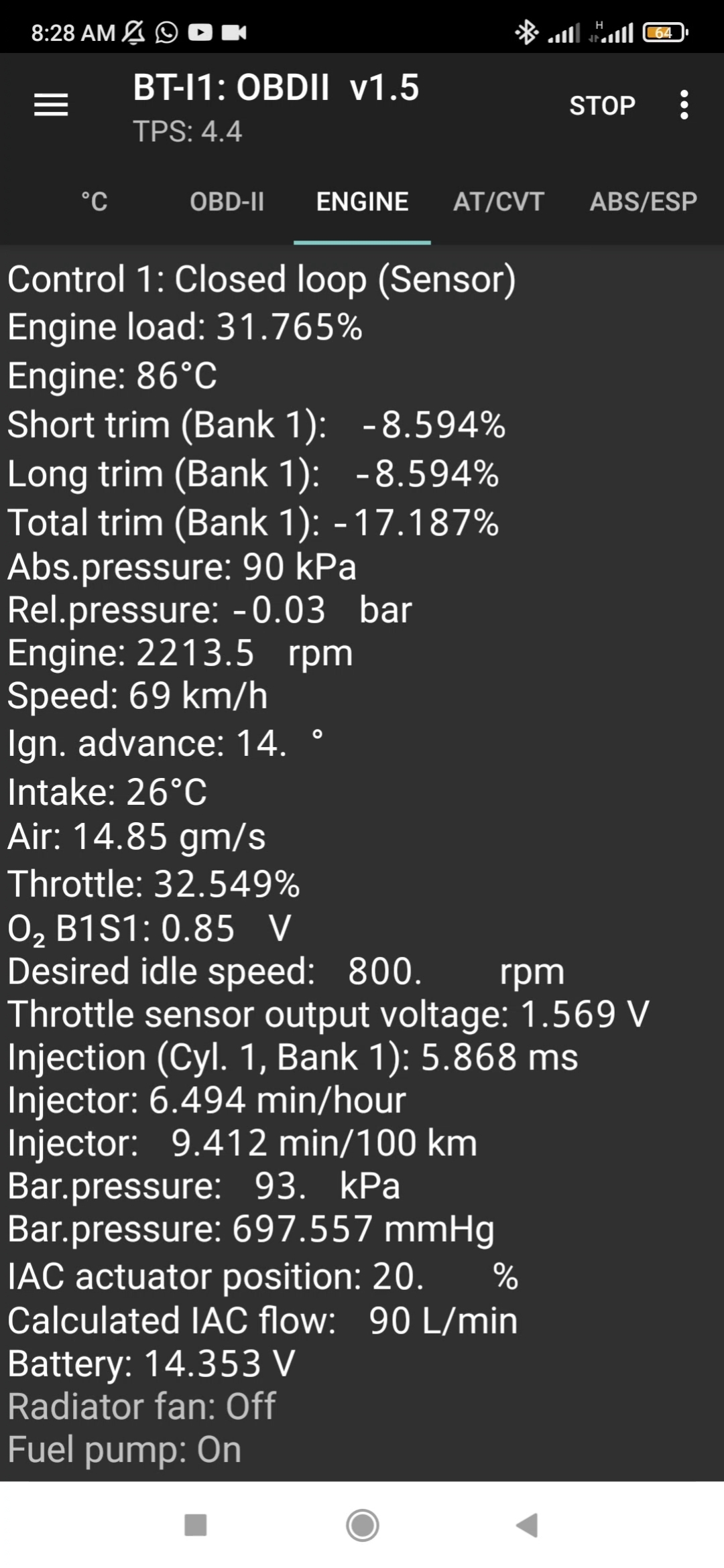

I got mine repaired recently as part of a carburetor service. Car still does not start on first self (like it does but immediately stalls because of no rpm, unless I start with slightly pressing the accelerator ) When it does, it idles pretty smooth on cold starts too but idles on 1k rpm, unless I slightly accelerate to 1.5k rpm which is where it idles, but that doesn't automatically disengage when the car warms up, I have to flick the accelerator so it manually disengages. Not sure what the issue is now?
What I really wanted was it to act like any other car, self start on first self, idle rpm slowly rise to 1.4k rpm and then slowly come down to idle as engine warms up. So far, it ain't doing none of that. Justing cold start idling at 1.4 manually, (I have to get it up there and get it down)
