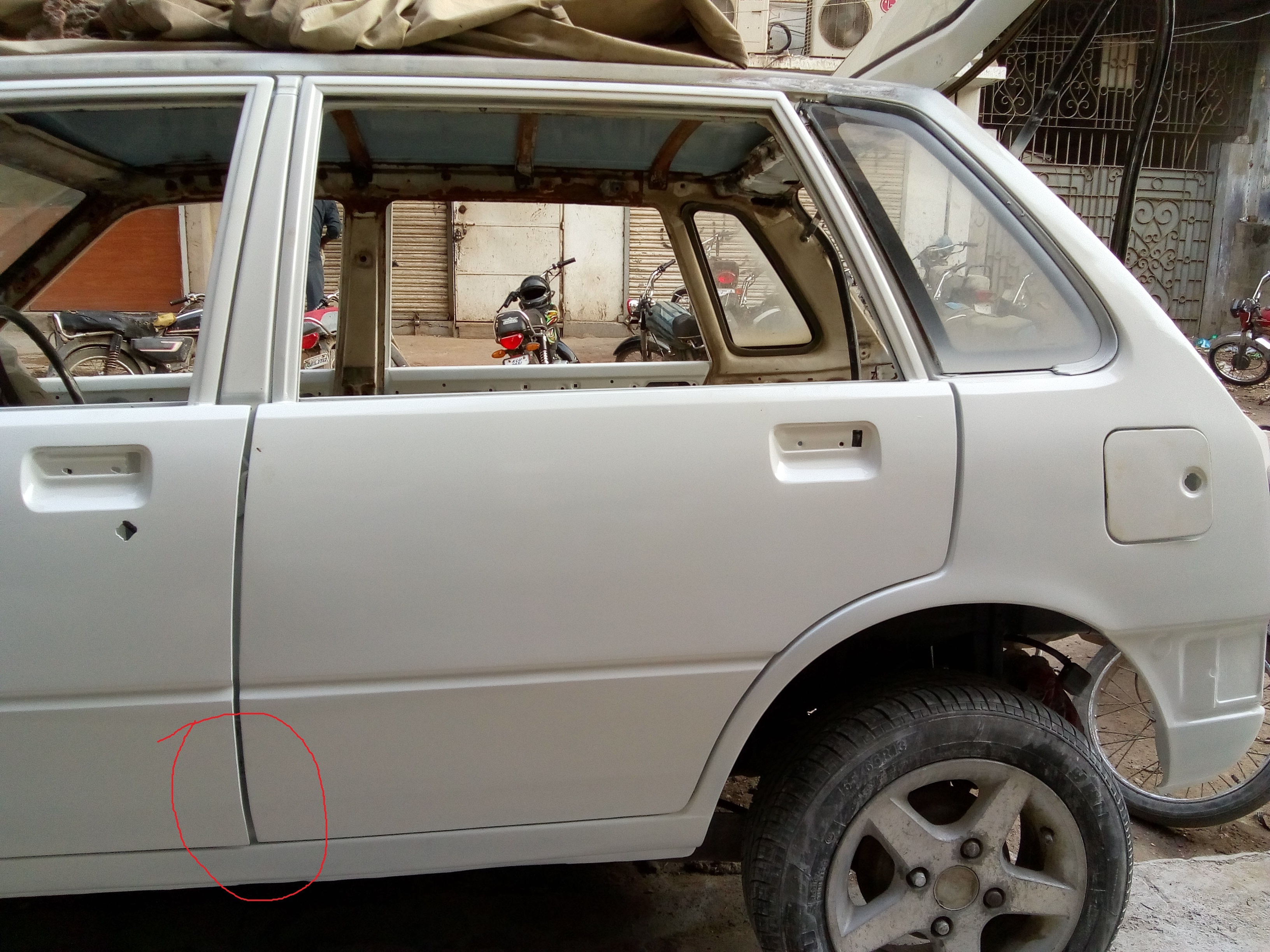

check the pic, the circled area needs correction.
