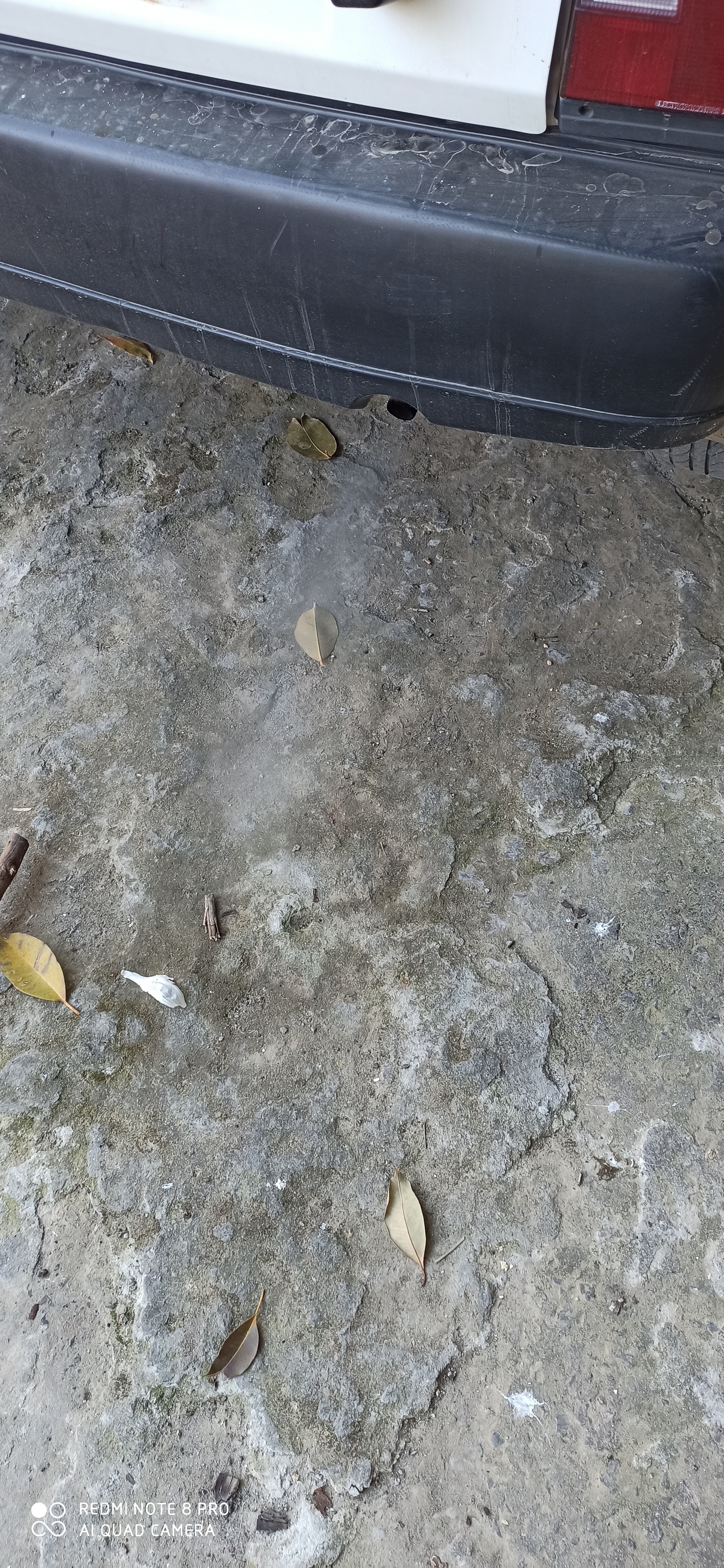

Now, when car will complete 1000km of its running period, i will change oil.
Uptill now, i have been running it under 60kph, and max with 1 or 2 passenger. there is no reduction in oil. Even there is no change in color of oil(red, havoline 20w50) after 550km drive.
Previously it turned black after 200km drive
