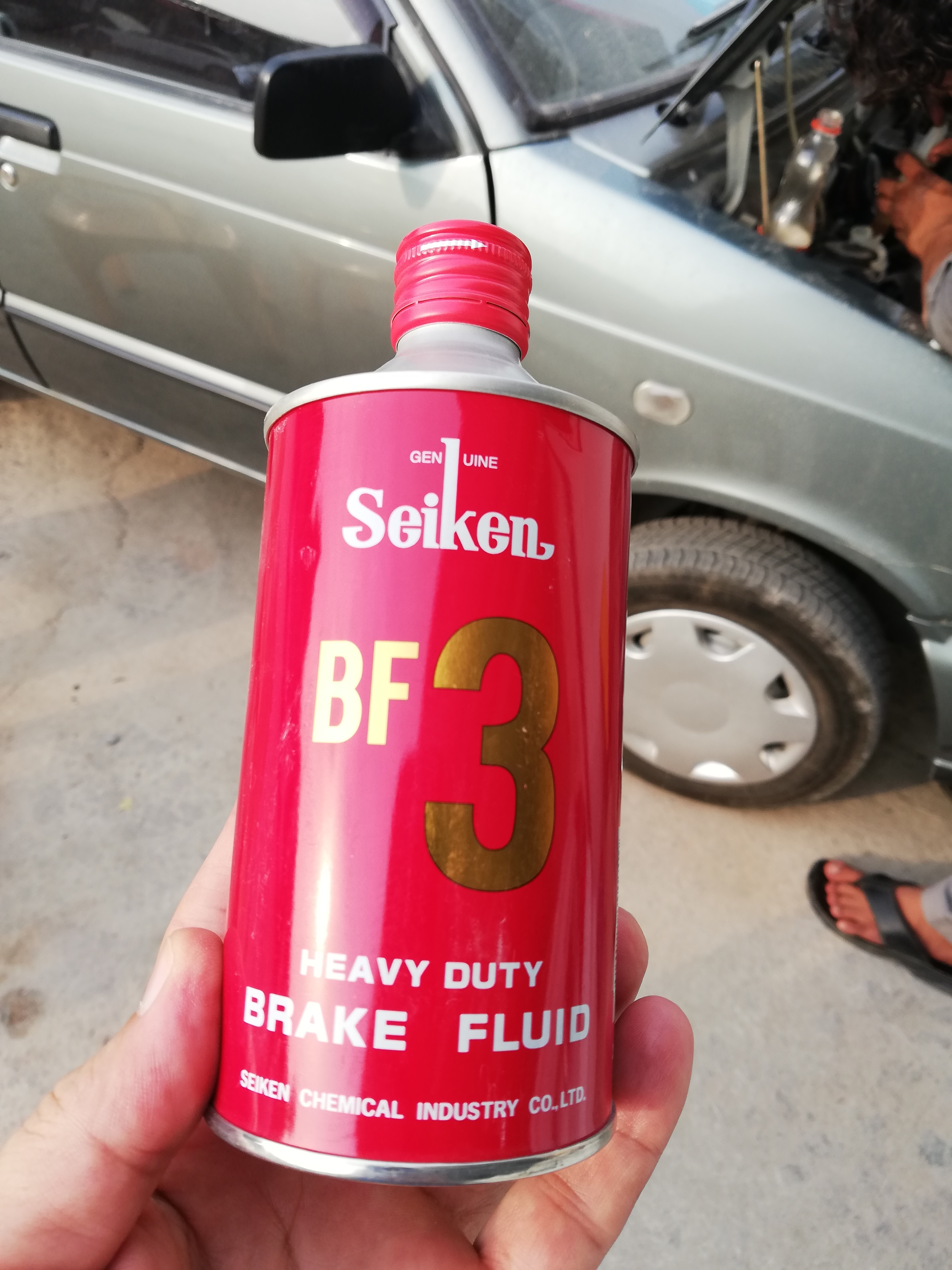

Got transmission and brake fluid replaced after 7.5 years. One axel seal replaced as well. Plugs checked, were OK, cleaned and put them back Total cost 5,000 rupees from Burraq Autos, PWD-Police Foundation behind Attock pump. Odo 20800.
5000
5000 is not expensive keeping in view.....gear oil and brake oil he 3000 ka hoga coz sieken is expensive approx 450 per bottle. rest will be the labour misc parts i guess.
Yes axle seal was leaking it was also replaced. Plugs also checked and cleaned and put back as they were fine. Gear oil 930 per liter, 2 bottles used. 1,800 labour charges. So keeping in view the jobs and fluids and spares overall bill is very reasonable.

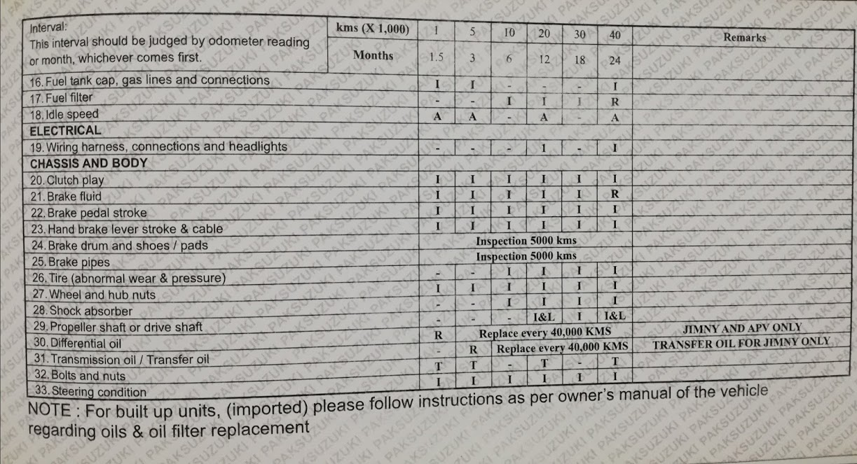

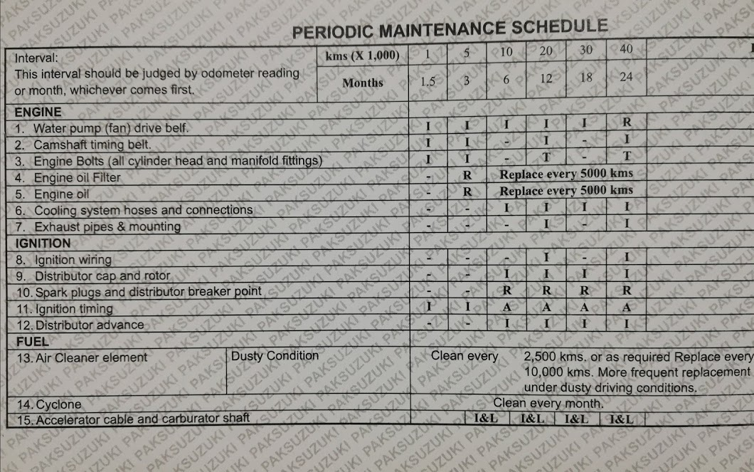

Mehran maintenance schedule.

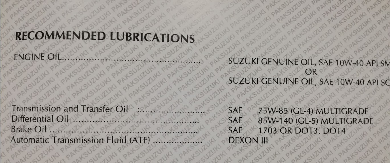

"Automatic Transmission Fluid" what's that and where is it used?
Its not used in Mehran because mehran is manual transmission car.
This is generic recommended Lubricants for different suzuki cars.
