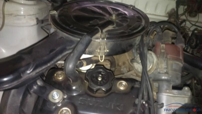

It is a dumb question but I want to know if Carby Mehran has PCV/Breather/Blow Valve?? i am asking this because few members said that it does not have pcv while rest says it does... can i DIY by cleaning it and put it back? I know the function of it, all i need to know if i can do this or not?where is it located? price?I have seen several you tube videos on how to clean or replace PCV valve.. as well as to inspect every 2-3 years to ensure it is not clogged or faulty. would be grateful if someone uploads a pic for clear understanding.

Mehran does have a PCV valve it can be cleaned using Carburetor cleaner.It is a metallic valve located on the intake manifold. Follow the pipe that is comming out from valve cover and going into air filter housing that pipe has another pipe attached in between that goes to PCV Valve.
Thank you soo much for you quick reply, will do it on next weekend In-Sha-Allah! any precautions to be noted before DIY?
Once again Thank you.
You're welcome.. Just spray carb cleaner in it with the engine running and when this PCV does have vacuum (sucking the air in).

I did it Finally as per the instructions, i could feel the vacuum after thoroughly spraying it, I even cleaned the inner pipes which was filthy. however i noticed that black greenish oily substance coming out of the exhaust tip dripping slowly. Is it normal? should i have removed the valve and cleaned it then put it back?
That's normal. Nothing to worry about that. You can clean the valve by both methods by removing OR on vehicle. I don't think so that cleaning method makes a difference..
