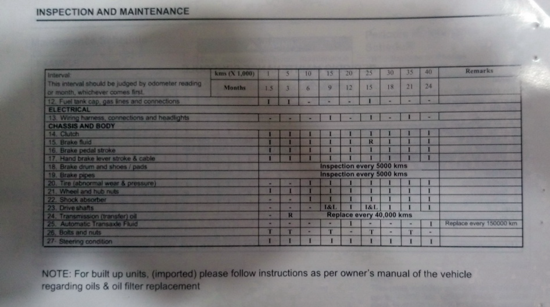

As per the manual, it says change after 150k which I don't trust. I will get my A/T Fluid changed when I get the chance. I just bought the car used so just to be on the safe side. Although the color of my fluid is still kinda pinkish.
Here is the picture from manual
