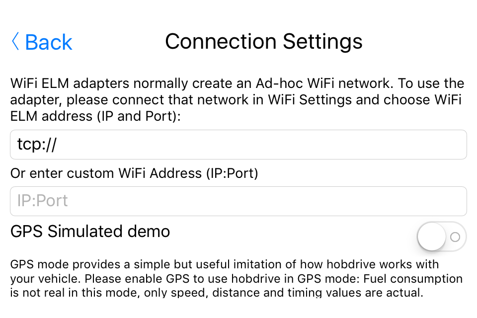

i have tried to connect HobDrive with ELM 327 but not succeed , same OBDII connected successfully using SZ Viewer.
have you tried by changing settings of HobDrive as mentioned by @shariq101
don't know which settings are you referring, if you have any then please let me know.
Unable to find this setting page in HobDrive
Go to ECU Settings in settings page
Screens----Settings---Vehicle settings---Ecu settings.
In the vehicle ECU type, type Suzuki_H27_KWP
My iphone is not showing showing the bluetooth connection, i think i have to try it with andriod mobile.....For iPhone i need a ELM 327 wifi device.....
Most OBD2 don't support IOS. Please check with Android phone.
