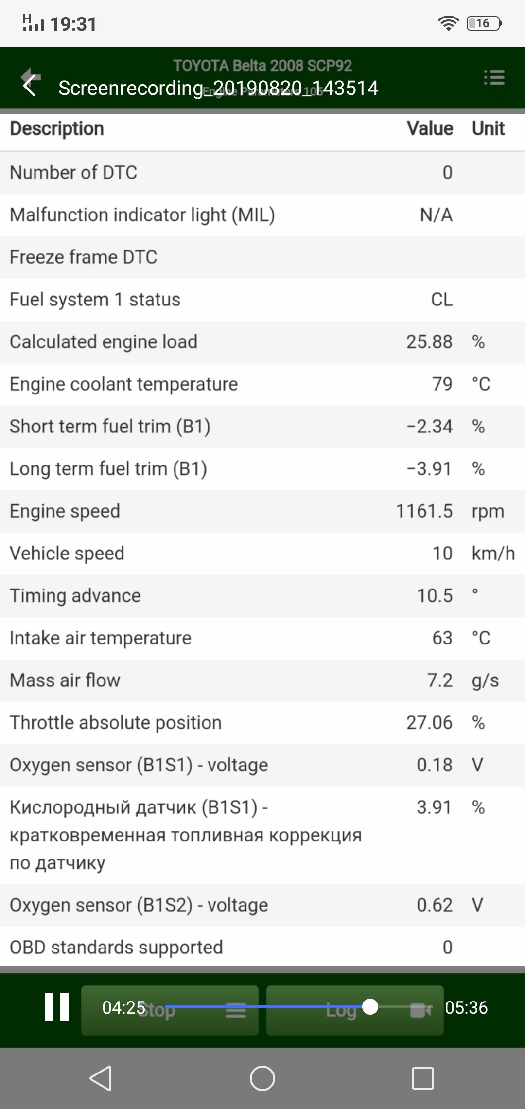

I tried but the app doesn't allow to select PIDs. It only gives all data. So kindly look at this 3 minute video please for fuel trims, O2 voltage, MAF values on various engine speeds.

did you reset your ECU? how did the long term trim get to -3.9% by itself?
I did reset the ECU. The long term fuel trim got to -3.9% instantly after installing O2 sensor, new air cleaner assembly, servicing MAF sensor, servicing PCV valve and servicing throttle body (without taking it off).
Is this value good enough?
-3.9% is perfect
This is on idle.

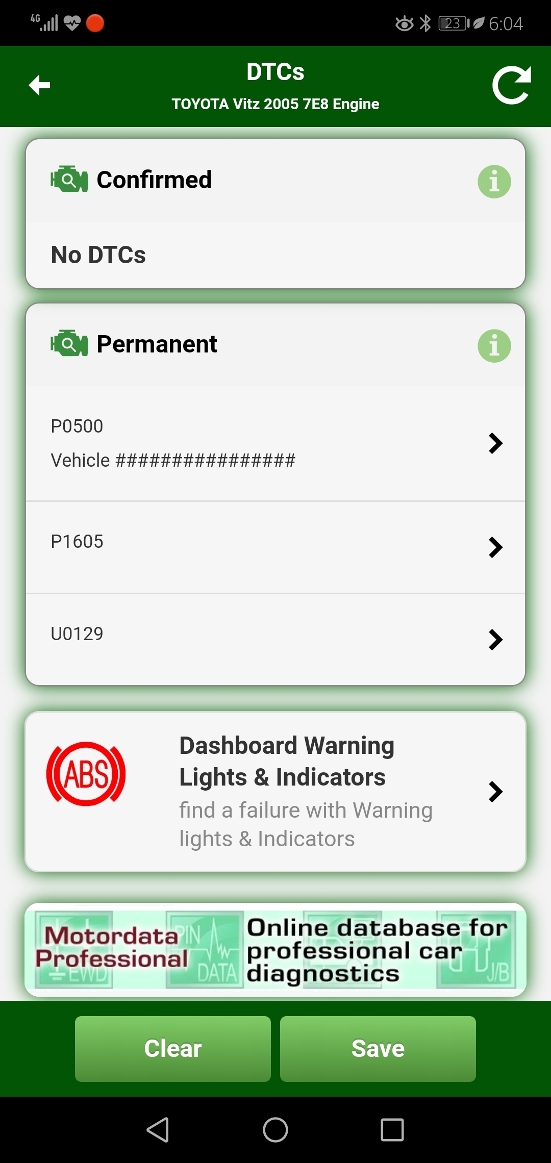

Sorry to hijack your thread @ahmedstudio but @Xulfiqar I need your help Iam getting these codes and randomly the power steering dies while and indication of Gear like D or N goes away in meter and check engine light, power steering light and Abs turns on. Again this happens randomly

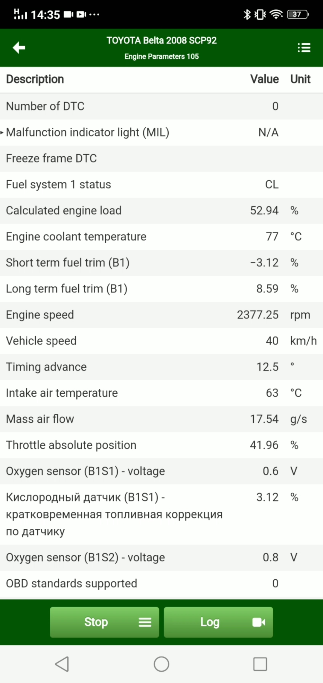

Please see the attached images for long term fuel trim values on various RPMs, engine load and speeds (I rev a lot, heavy foot). Are they alright? Also see the MAF values please.
drive the engine for 50 kms, then recheck the trim values - its a learned value. Do not reset the ecu.
The values I just shared are after driving for 120 km.
good - keep on driving it, its running proper at the moment. and please find a better tool - something that can graphically plot the o2 sensor.
