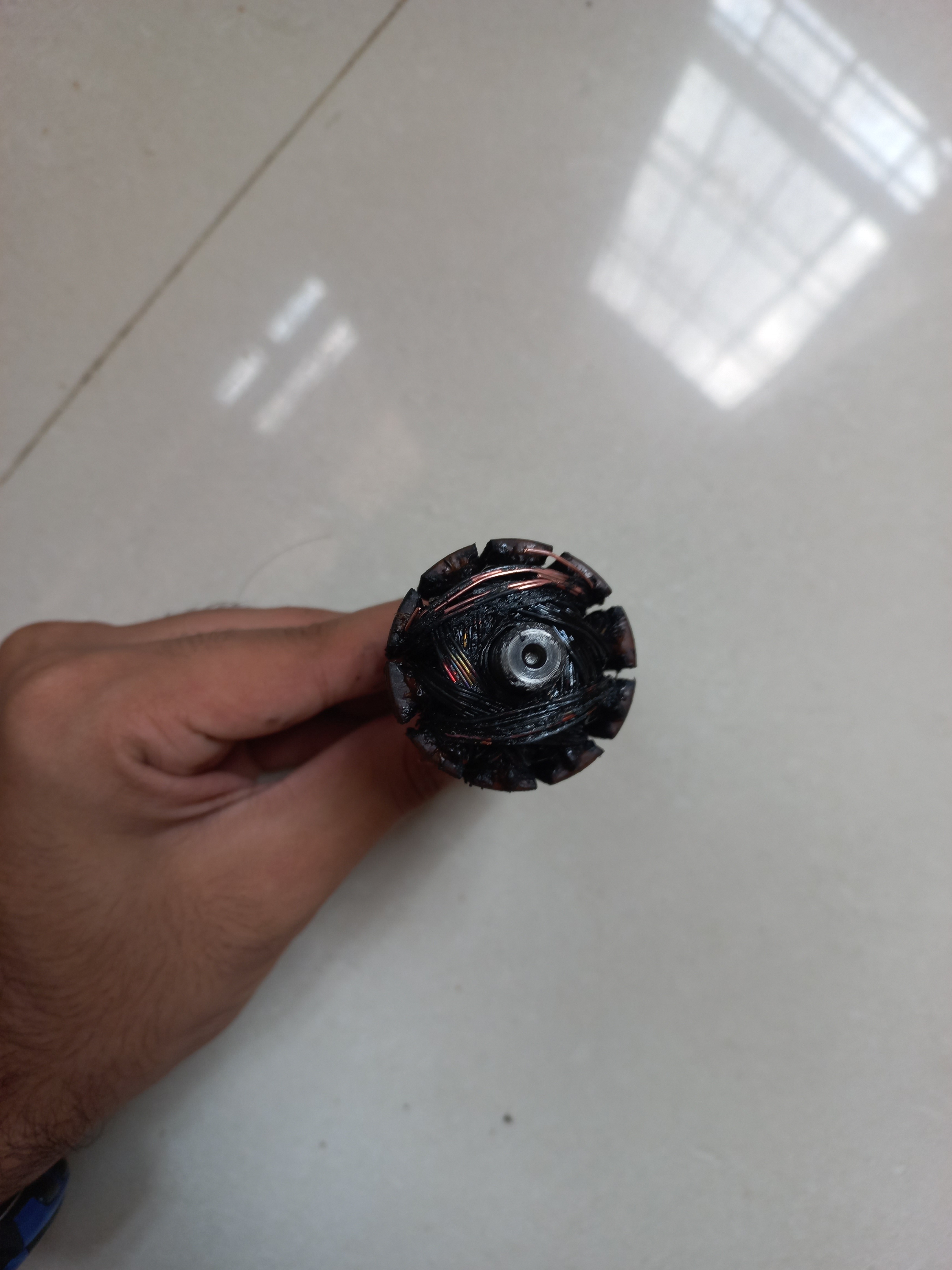

Can someone tell me from were can i remade the wiring of self motor of my 3kva generator?
Current status:
It can be re winded.Or try to find brand new similar armature.

What is better? To buy new one or rewind it?
And what would be the estimated cost?
@helper_learner you are derailing a dedicated technical thread with irrelevant item.this armature can be repaired (rewind) by any motor winding shop or can be purchased from generator scrap market in lines area. rewind cost will be under 1000 equivalent to scrapyard item. make a wise choice.
Ok. Thanks...
