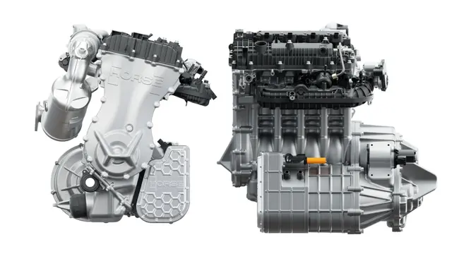

UK-based company Horse Powertrain is preparing to show a compact 1.5-liter, four-cylinder engine-generator that turns battery-electric vehicles into range-extended series hybrids. Described as “no larger than a briefcase,” the base C15 unit measures 50 × 55 × 28 cm and is designed to slide into existing EV platforms with little or no modification, adding liquid-fuel refueling alongside battery charging and extending real-world range.
The C15 is a generator set, not a propulsion engine. It is not connected to the wheels; instead, it runs at a steady, efficient rpm to power an integrated generator that charges the traction battery and maintains the state of charge. The Euro 7–compliant naturally aspirated version delivers up to 70 kW (94 hp), aimed at Europe’s B- and C-segment models.
A turbocharged variant lifts output to 120 kW (161 hp) for larger D-segment cars and light commercial vehicles. Horse says the package can be installed horizontally or vertically and packaged at the front or rear, allowing automakers to convert native BEV platforms into range-extended EVs (REEVs).
Beyond adding backstop range, the company is pitching the C15 as a way to design vehicles around smaller battery packs without sacrificing total driving range, potentially cutting weight and cost. The system is also fuel-flexible: it is designed to run on gasoline, ethanol, and methanol flex fuels, as well as synthetic fuels.
