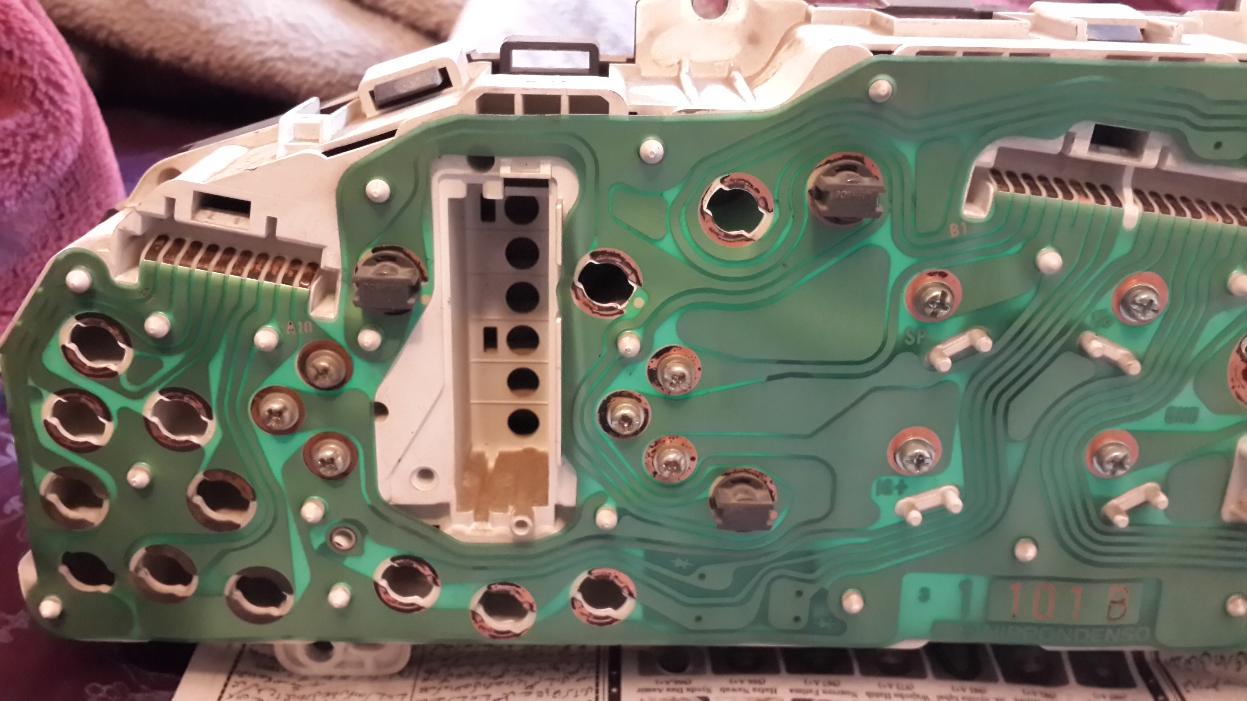

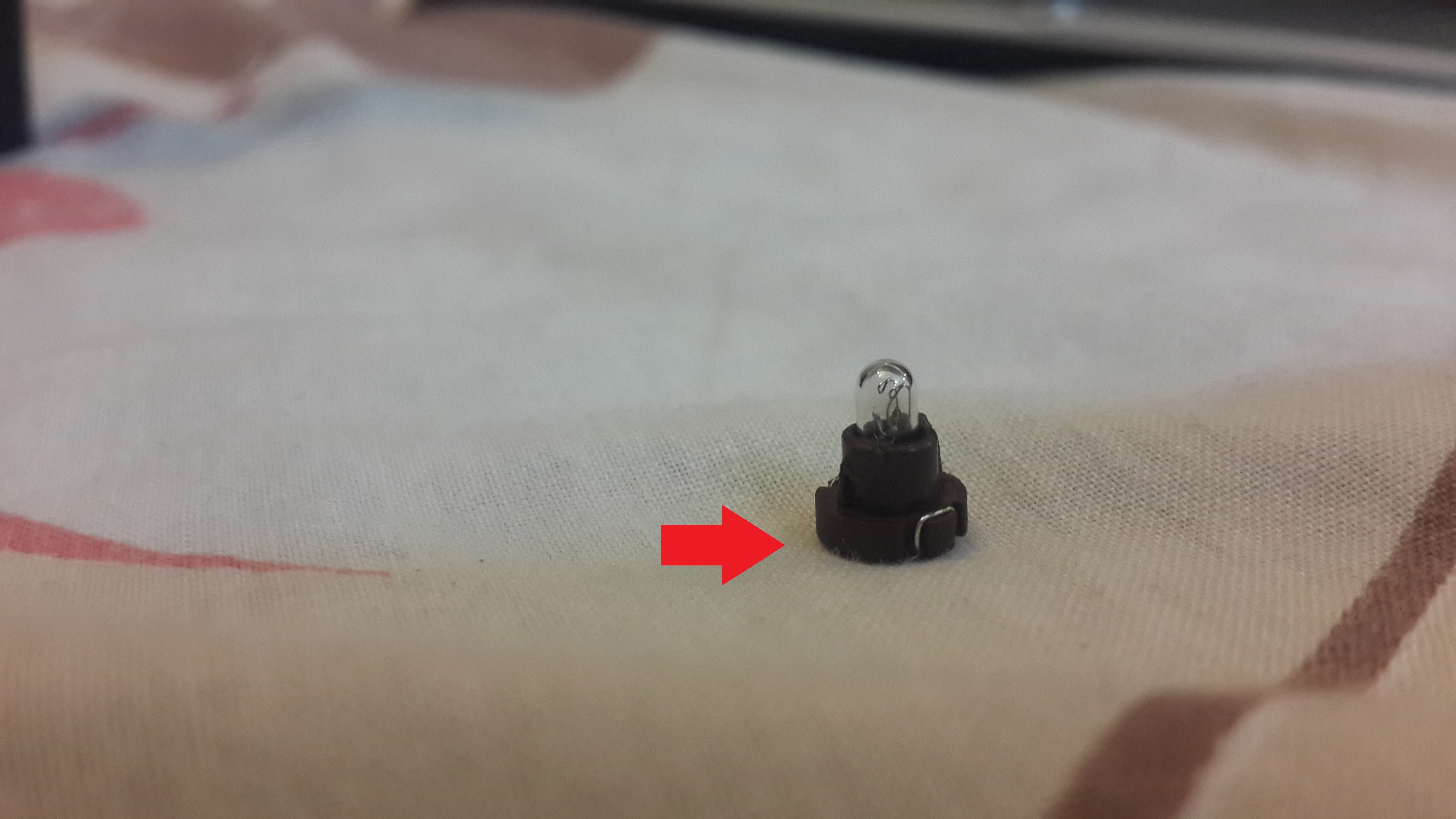

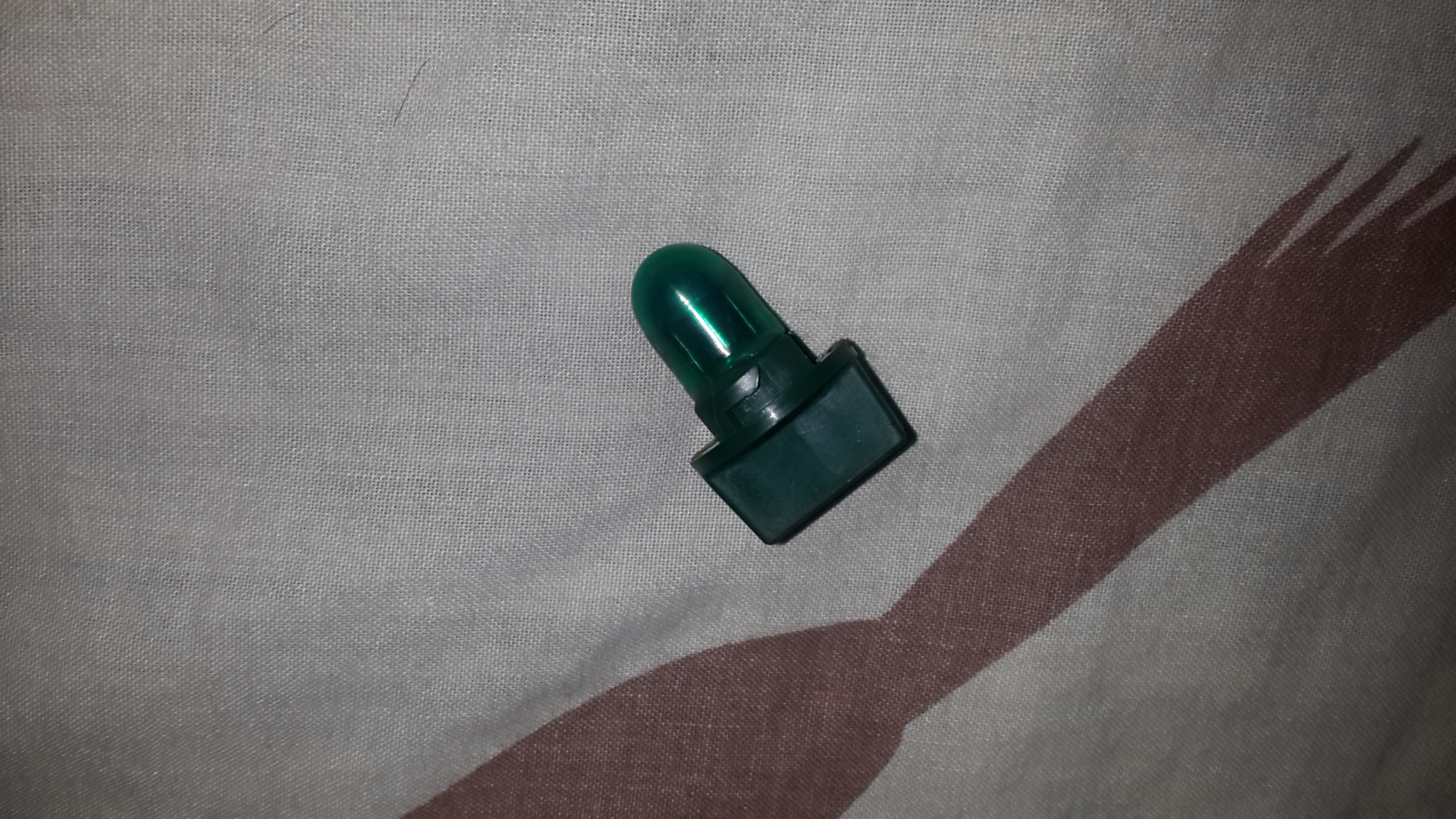

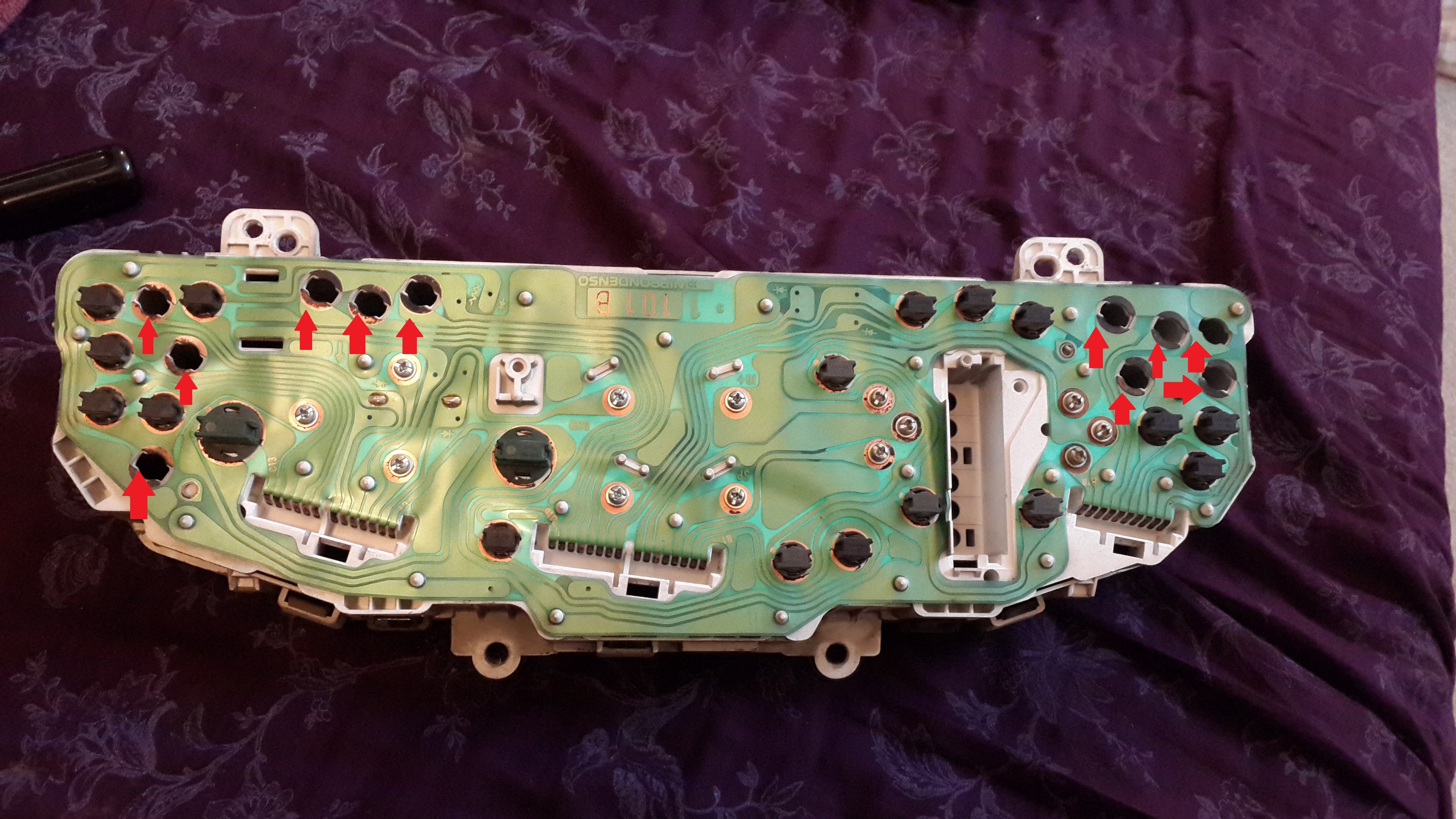

r u finding it difficult to read the cluster? if so then you need to clean the carbon inside cluster/ there main body is made of white plastic and with time it almost turns to black...open the cluster...give it a good wash...check if any bulb is blown...see the green rubber condition... fit it all back and thats all...

P.S. original bulbs have life span around 10 years....these LEDs give away in months...even weeks..you will be pening cluster again n again
