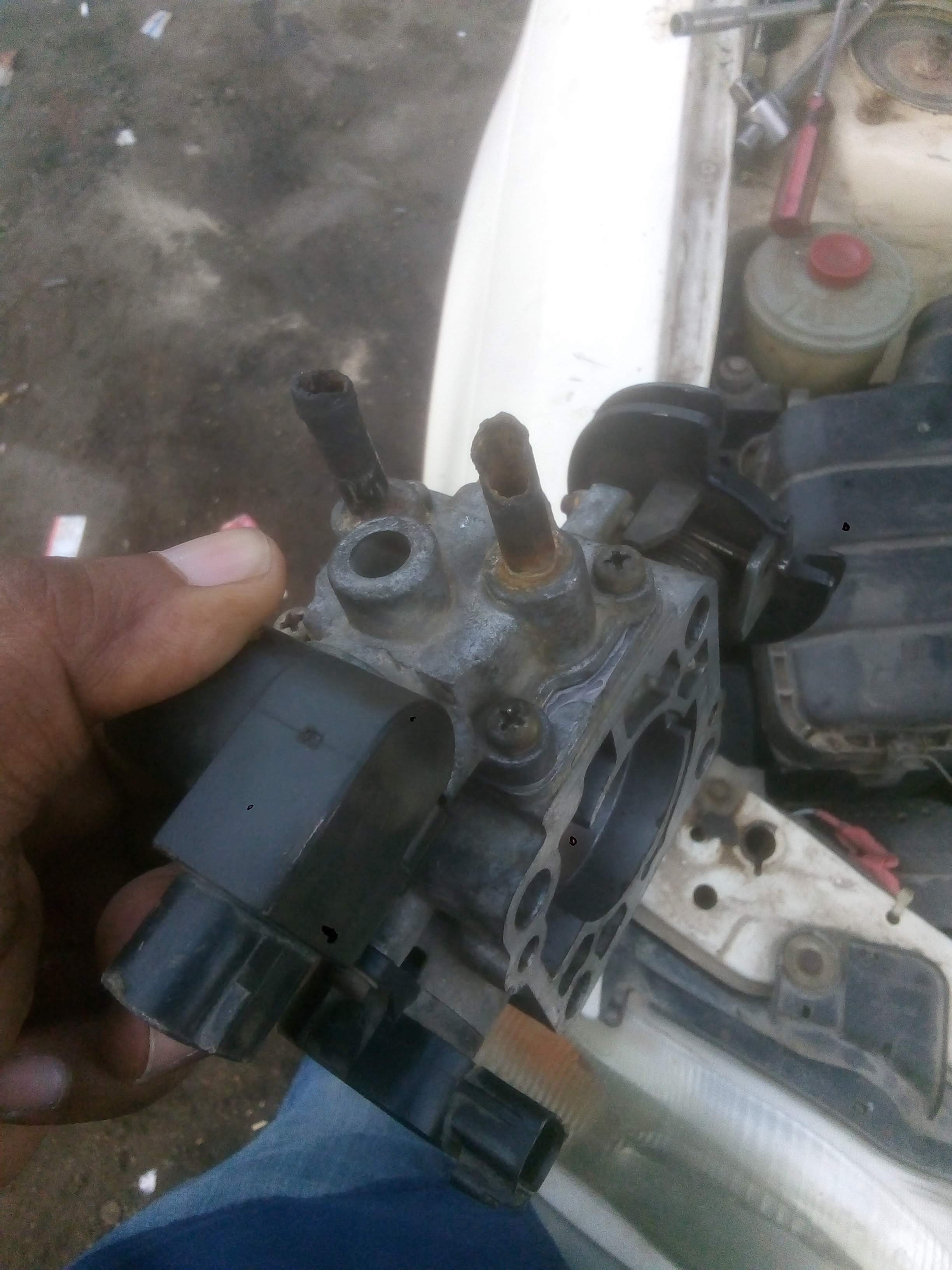

good to know that your problem resolved...

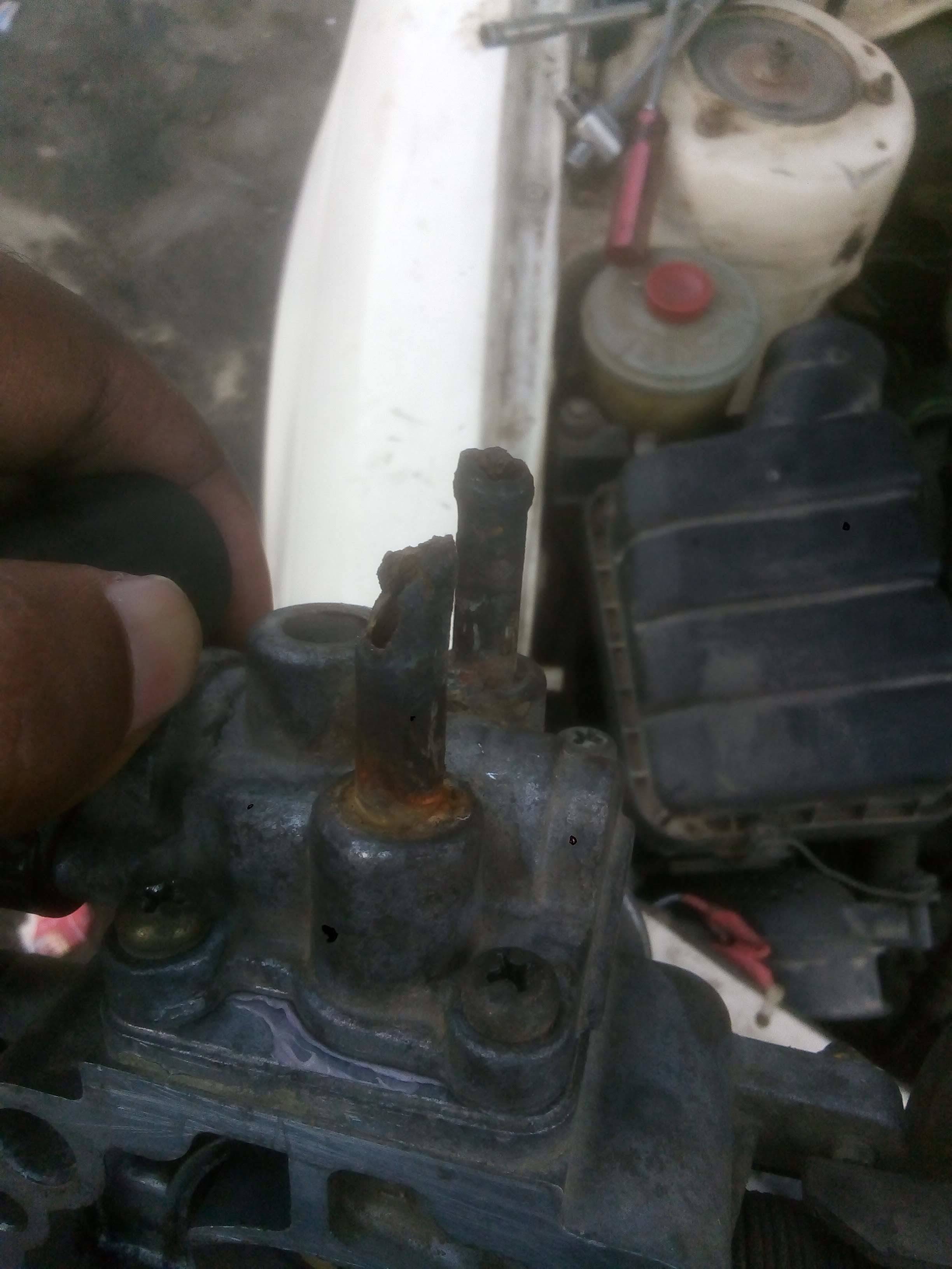

SAD to see the condition of old one...this item is meant to last till the life of vehicle...
to me the cause of this is using tap water in cooling system...the coolant circulation pipes are badly corroded...
my advice is also do consider the situation of other parts of cooling system and make necessary repairs and use a proper coolant from now on...
