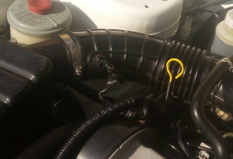

Did anyone know about oxygen sensor in baleno

I have alot of boxes but all of them have simple hole and nothing inside it. And all of them are original air intake filter box (Qabli Box). Where can i find such a filter box that contain the flapper (opening and closing).
Kindly suggest me please.

Oxygen sensor in air intake pipe u can see leads
O bhai ye IAT(intake air temperature) sensor hai oxygen sensor nae
pkdm baleno does not have a cat conv or o2 sensor....rather there is s trim pot under the steering wiring to adjust fuel air ratios.....
cant find one with flapper as international modle dint came with CNG, and flapper is used to restrict airflow while on CNG only.
well that's an air temperature sensor and not O2 sensor. o2 mostly exhaust manifold py lgy hotay hain.
