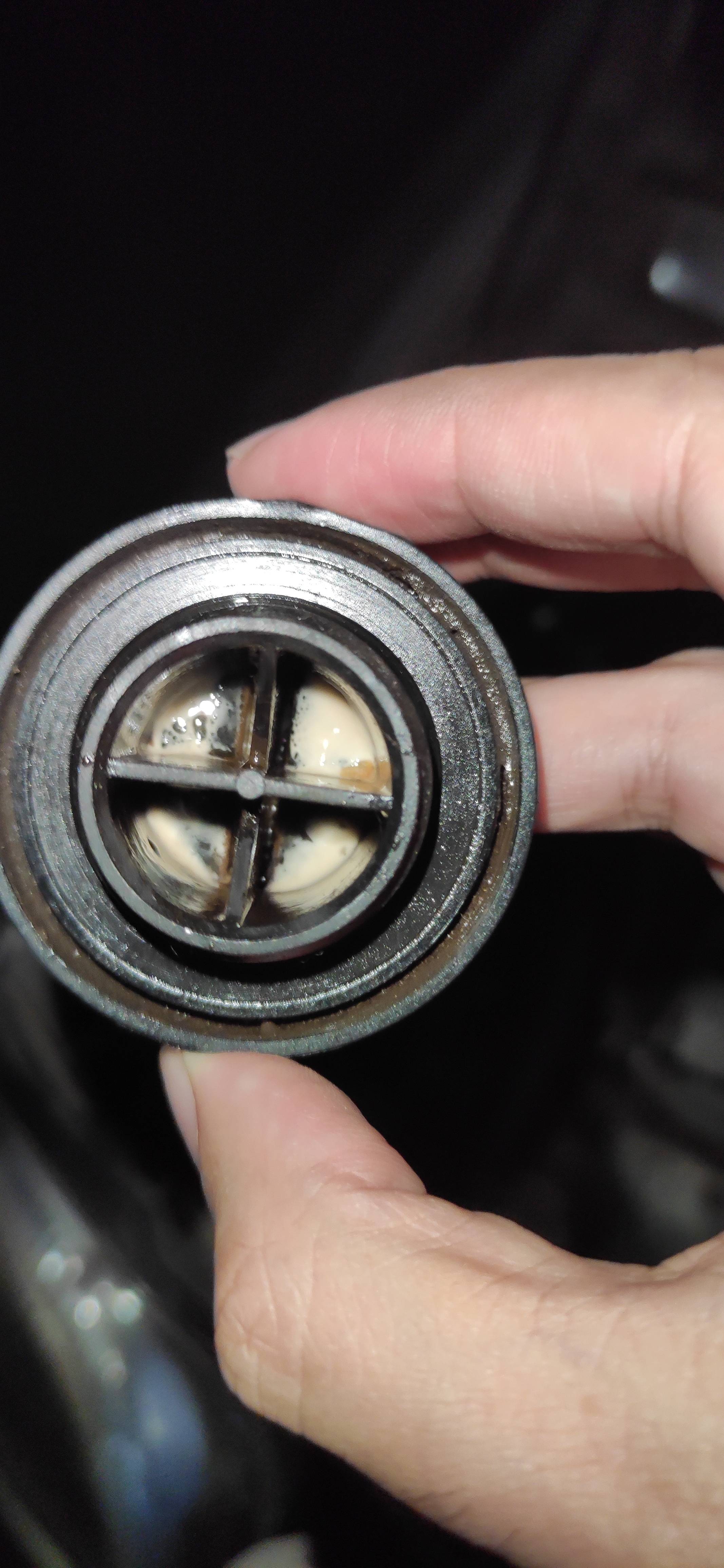

Thank you for your previous reply however, today again car got heat up but i didnt drive it much and shut the engine. Went to mechanic and when he pour the water after few minutes and when i cranked it, radiator was throwing water outside. Now as per him head gaskit has been compromised to some extent so he made the fan direct and told me to refrain from using AC. Now the point is head has been rebuilt twice before, what should be done now. Should the engine be rebuilt? Although there's no oil water mixing no foamy stuff inside engine oil cap silencer is clean as it normally is. How much will be the total expense of rebuilt. Or what other options are available. Please let me know. Thanks.

get it rebuilt from someone skilled
or
try your luck with a scrap engine
both routes will cost you the same.
it can be rebuilt fine, if the head is not machined till the max limit. head can be replaced too
but first of all, spend some more time on diagnosis..... maybe it is something stupid.
Like a bad fan switch, or a corroded water pump impeller.

A proper rebuild can cost you almost 100k
there is a chance though that your cooling system is weak, get a proper diagnosis.
looking at the real situation sometimes gives a different picture

So this is what I checked myself the radiator and the foam inside engine oil cap. Now should I drive it to Suzuki Olympia motors in Gulberg from Valancia or should I tow it. They are giving the same 100k estimate over the phone for rebuild. @xenerking
