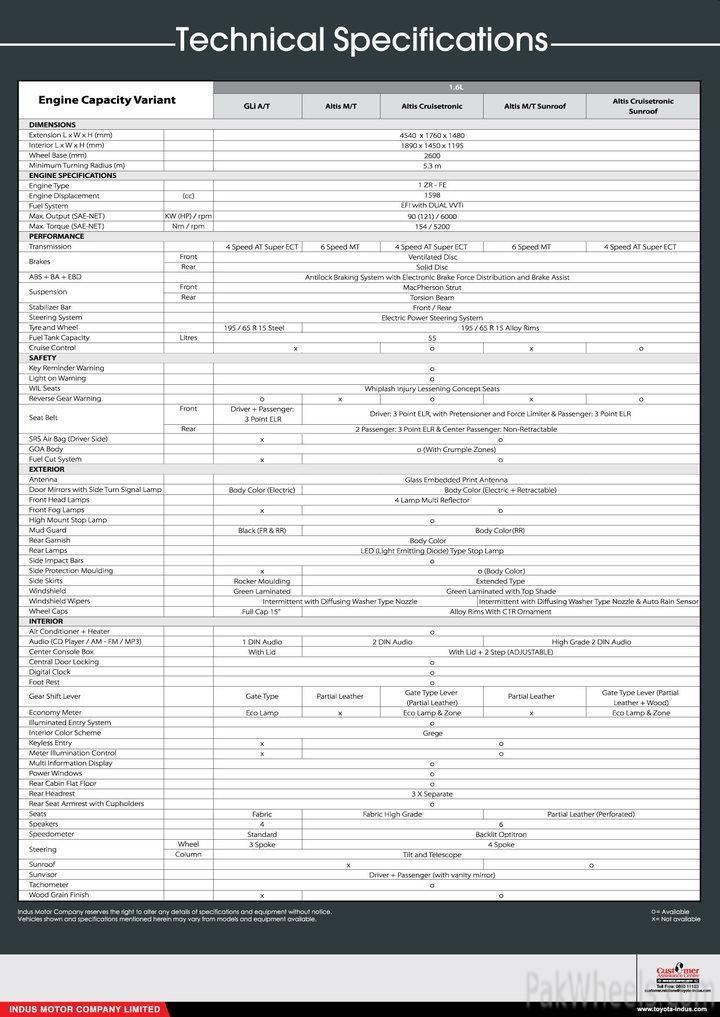

The facelift for the Corolla was launched on 11 April 2011. Initially only the XLi and GLi trims were available, with modifications to the front and rear lights, front grill, and bumpers, along with a revised interior colour scheme. The 1.8L Corolla Altis with 1ZZ-FE engine was suspended replaced with the 1.6L Corolla Altis with the 1ZR-FE engine producing 124 bhp. The facelift Altis was launched in May 2011. The Altis comes equipped with sideskirts, wooden inserts in the interior, optitron speedometer, 5-spoke alloy rims, fog lamps, power windows, ABS with EBD, driver side SRS airbag and a 6-speed (forward) manual transmission. Optional on the Altis is a 4-speed super ECT automatic transmission and sunroof.
The GLi is also offered with a 4-speed super ECT automatic transmission and the 1.6L 1ZR-FE engine, the same on the Altis. This version of the GLi is the same as the 1.3L GLi, albeit with the 1.6L engine and the 4-speed ECT automatic transmission, hence making it very similar to the Altis, save for the alloy rims, side skirts and the wooden inserts in the interior.
