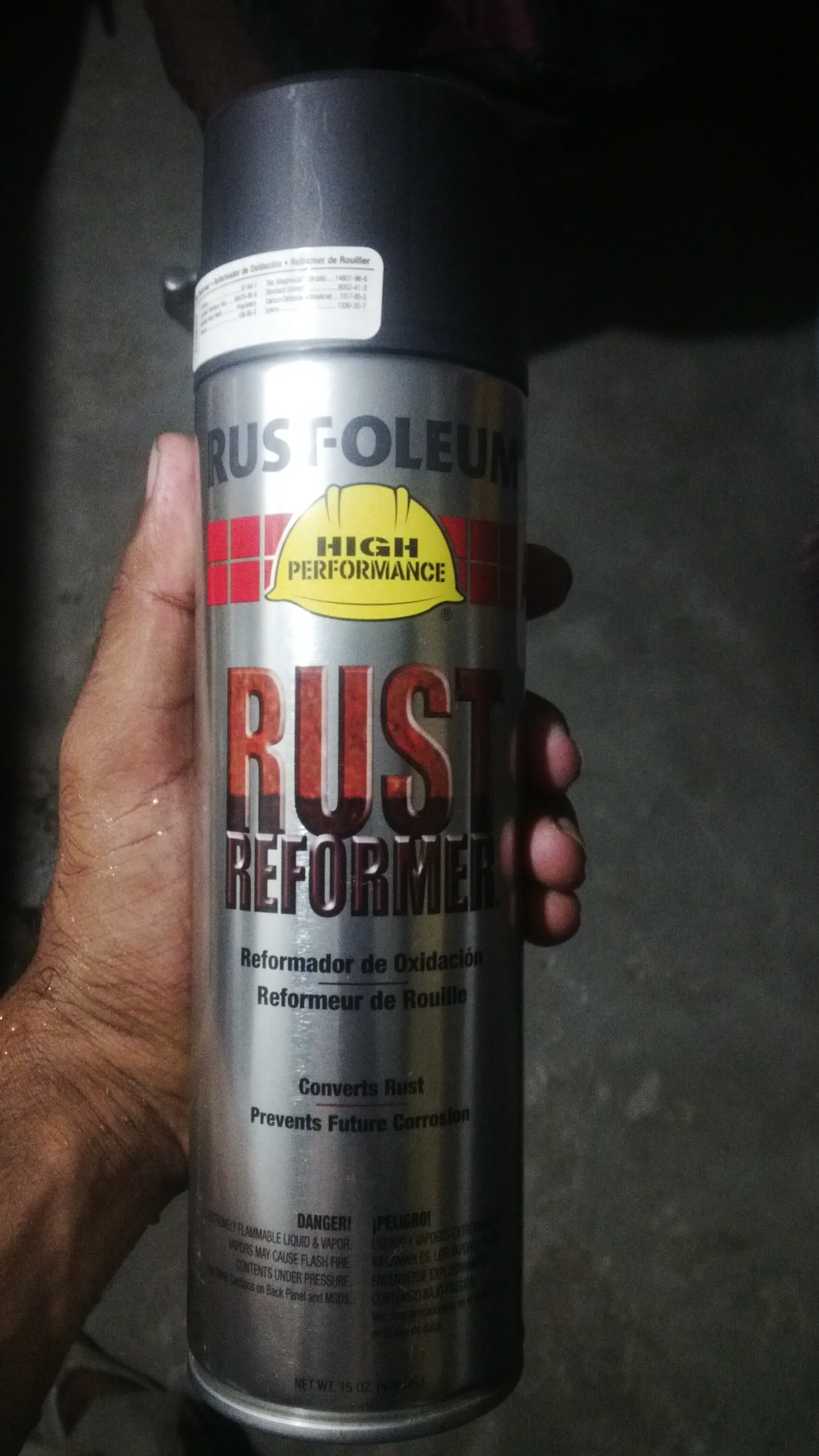

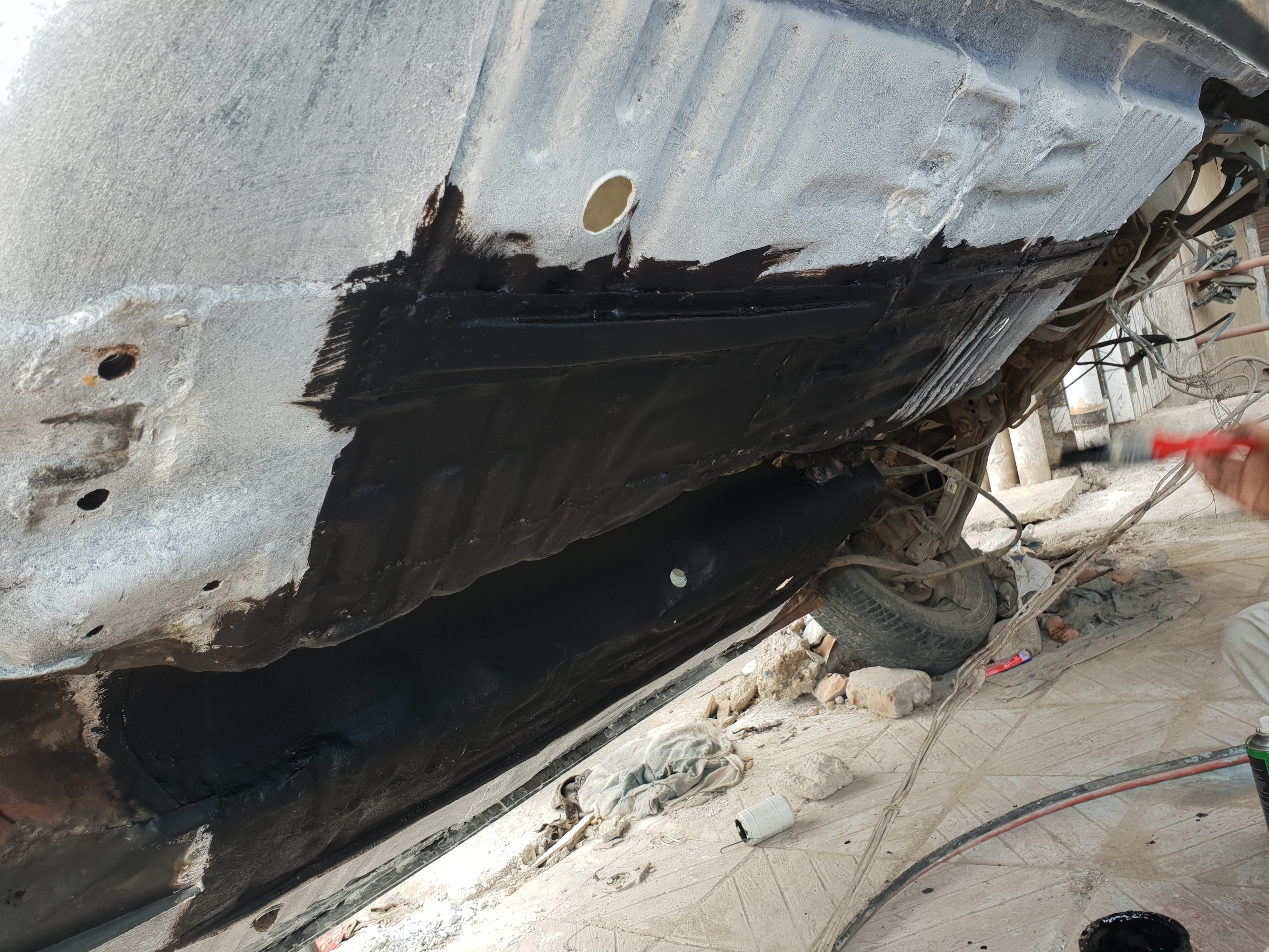

If you're friend is selling these you should try before buying.
In market it's price is 1500 something. I get it from Auto hub website. Cost 1k with delivery. Full name is Rustoleum Rust Reformer. But it will not work on a painted or bare surface. Only on rusted surface. Just remove the rust from wire brush and spary it. Also paint upon it if needed. Has a matt black finish.

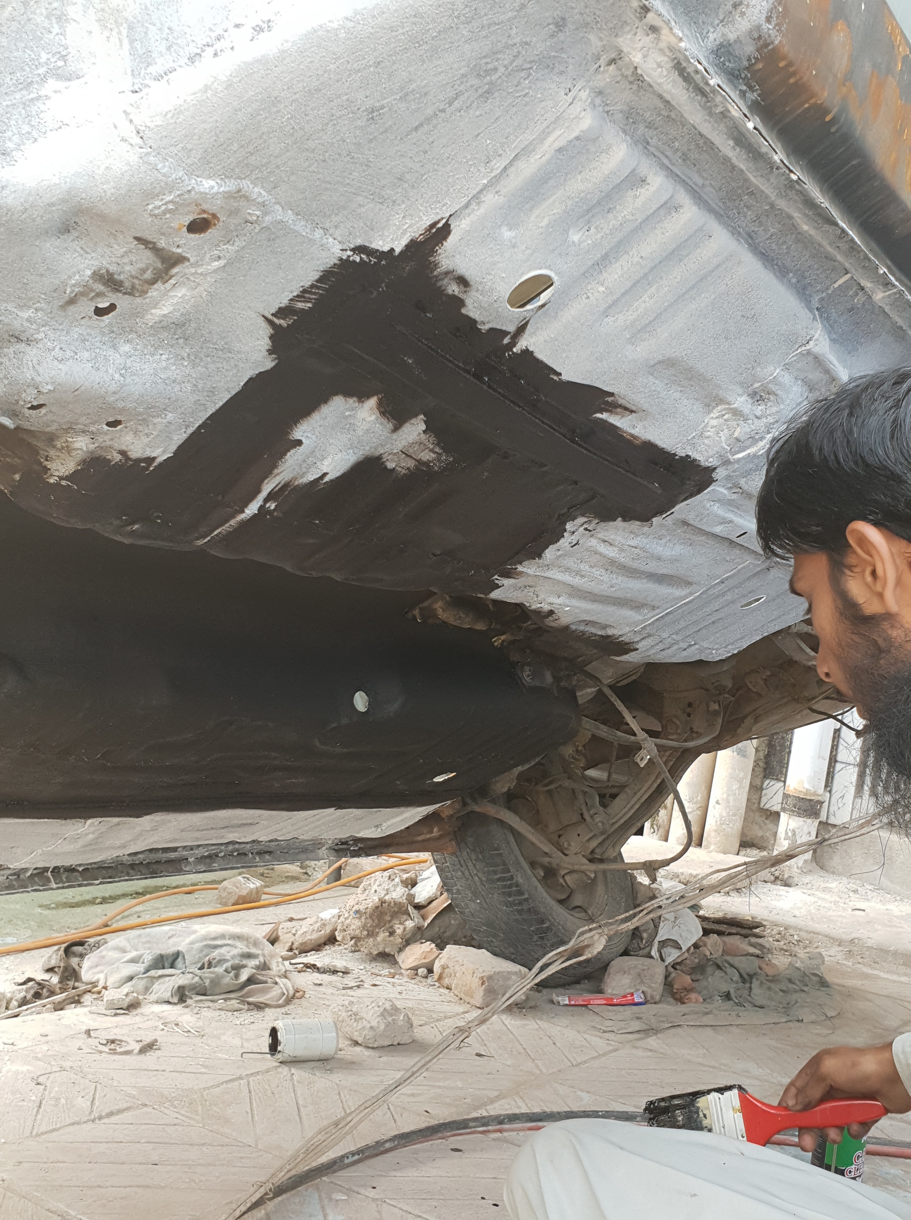

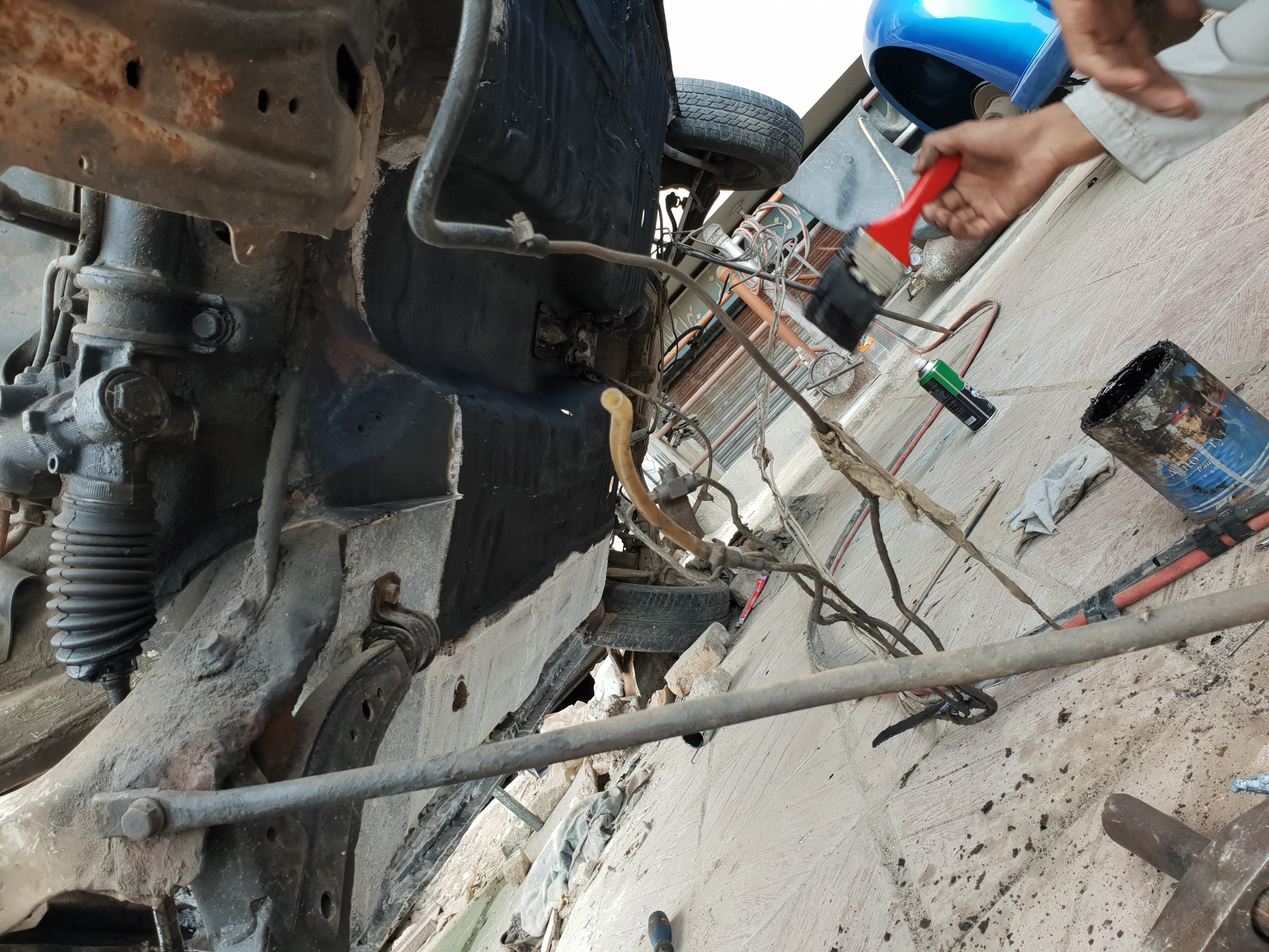

and lets see when my denter finishes the job as now i am getting frustrated because of him the whole project is on a halt
This work is frustrating. My car was in workshop for more then 3 months. Denter just wasted time. I had done Half of the work. And still doing.

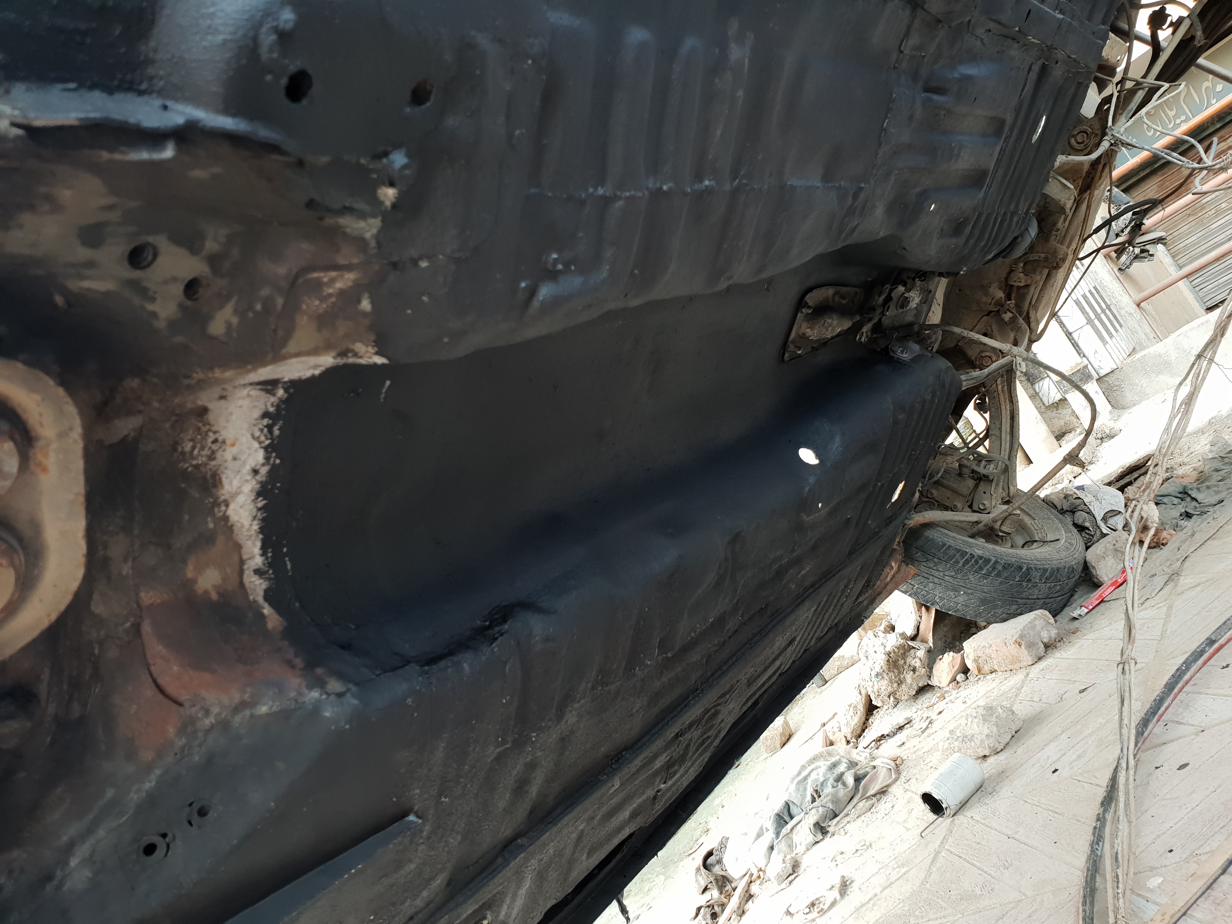

Try it.Work well for me.Normal paint on a rusted surface never works. Because rust continues to penetrate.I spared it on a rusted piece of metal i removed from my car while working on car body. And put it out under the sky. So weather effects it directly like rain or moisture. It being there for + 2 months. I didn't seen any further traces of rust and then someone through it away I usually do these kinds of experiment so i know what i'm doing

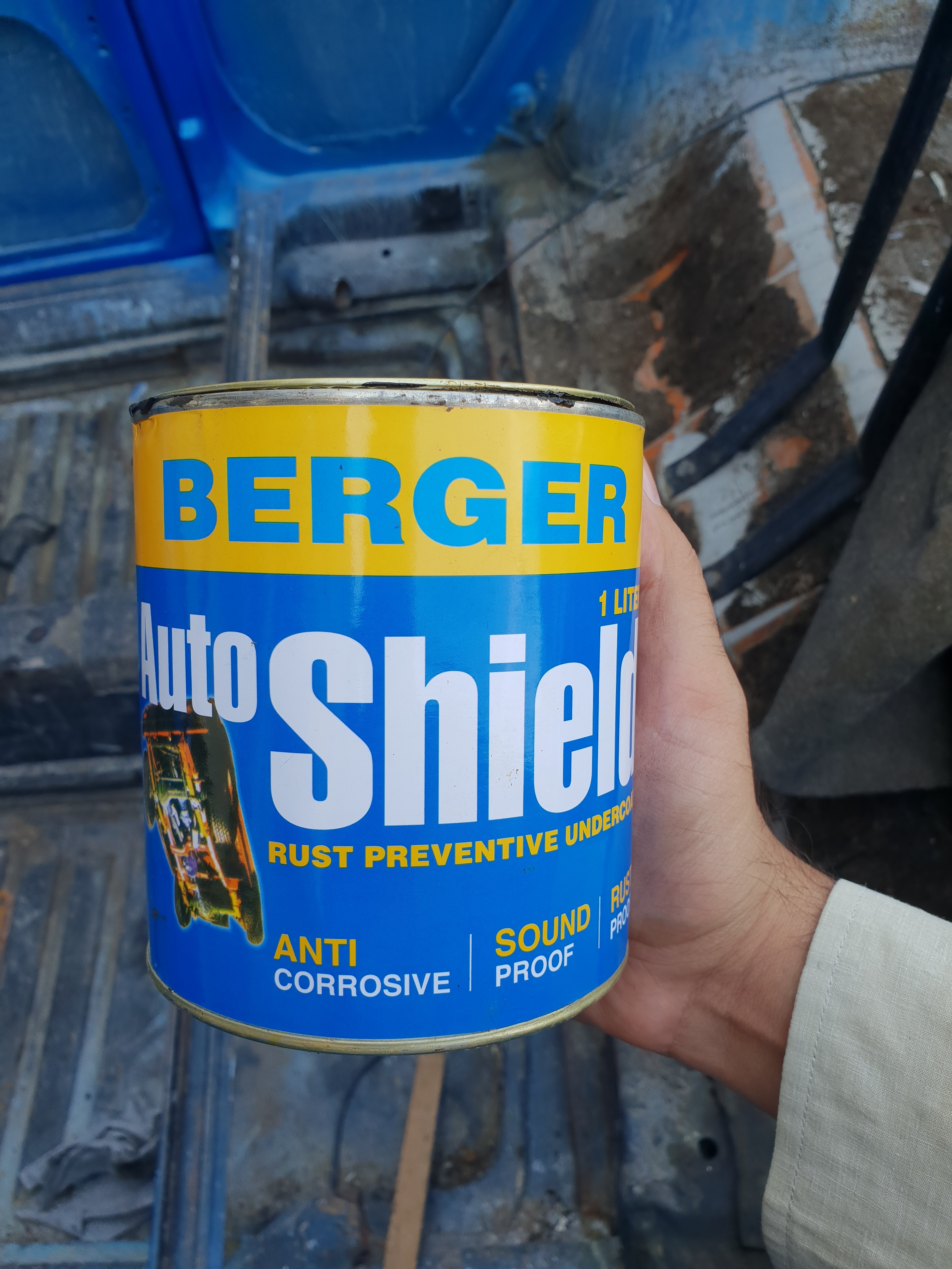

done with auto shield now time to drop the car down anddo the remaining work and swap that ZZ
Great.For how much you bought that paint?Bhai remember to get 2zzge of celica or fielder. Because there's also XRS 2zzge available in market. XRS 2zzge is rated 160hp. Internals are similar to others but restricted from ecu.
yes i will get the japenese one , and this paint cost me 400rs plus add some petrol 1:1 and you are good to go brush it or spray it and you have to wait 24 hour to apply the next coat this is the most difficult part of the process

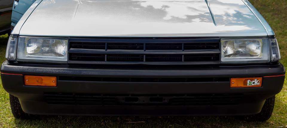

Bhai kia ap bta skte han ye grill kahan sa nd kitna ki mile ge ya simple ya wali
not available in Lahore when i asked, should be available in peshawar and pindi.price would be 2~4k.
Bhai the blacked out pillars look amazing
