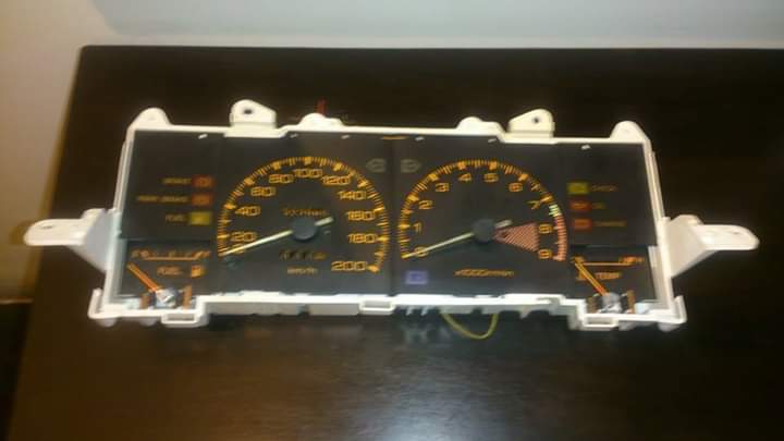

prefer OEM cluster, nothing compare to it's look.

Have made this for and from my meter, might help someone!E80 GT Meter Pinout
