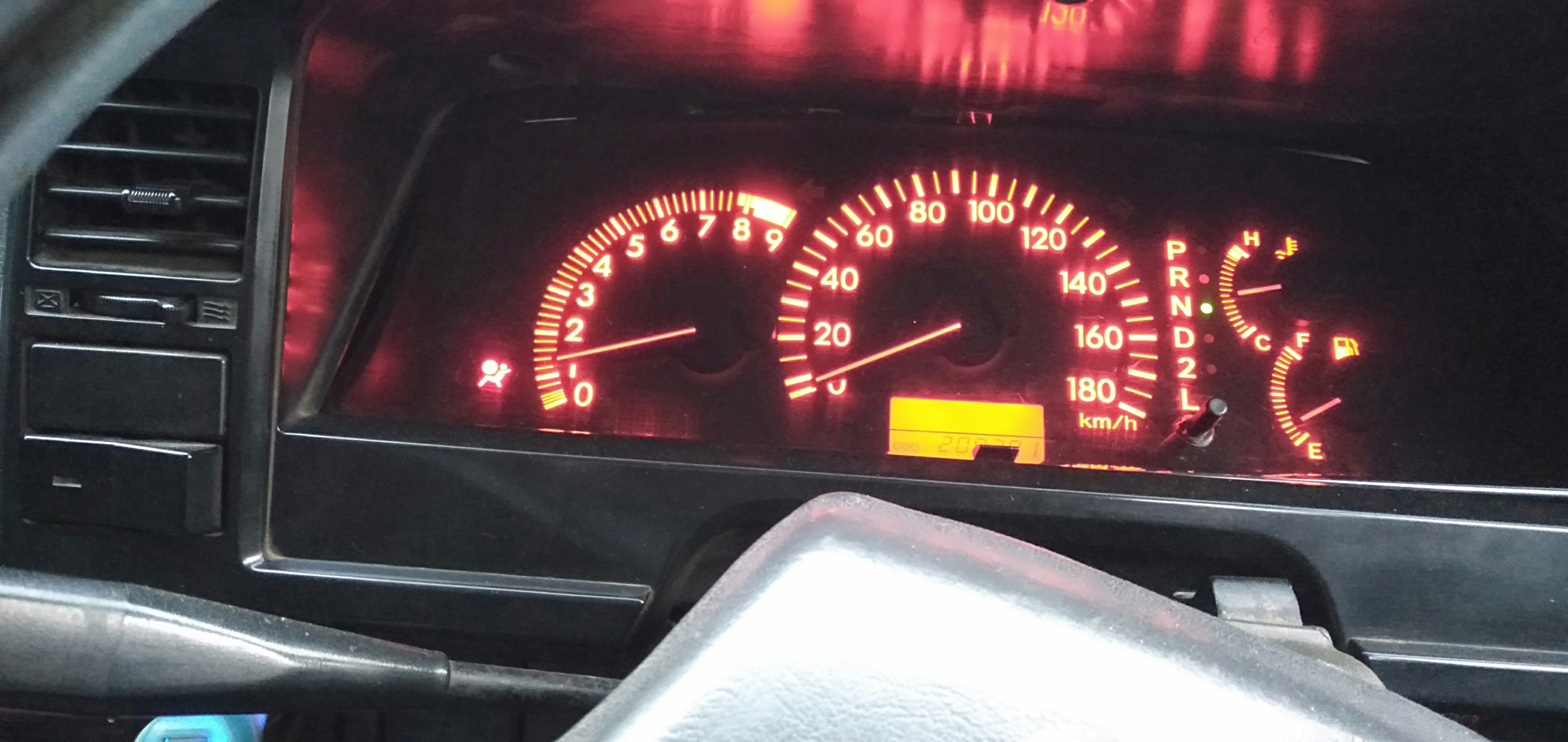

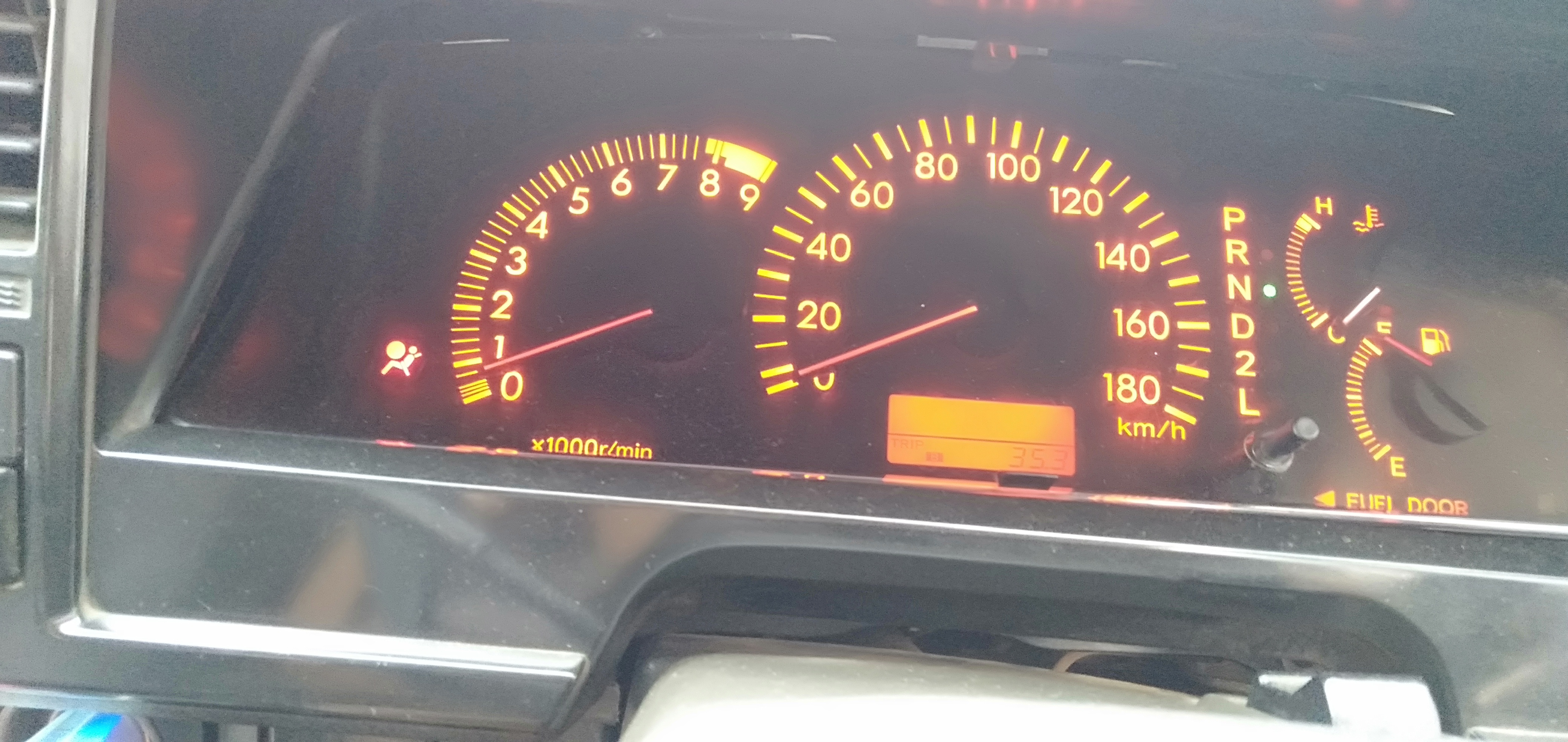

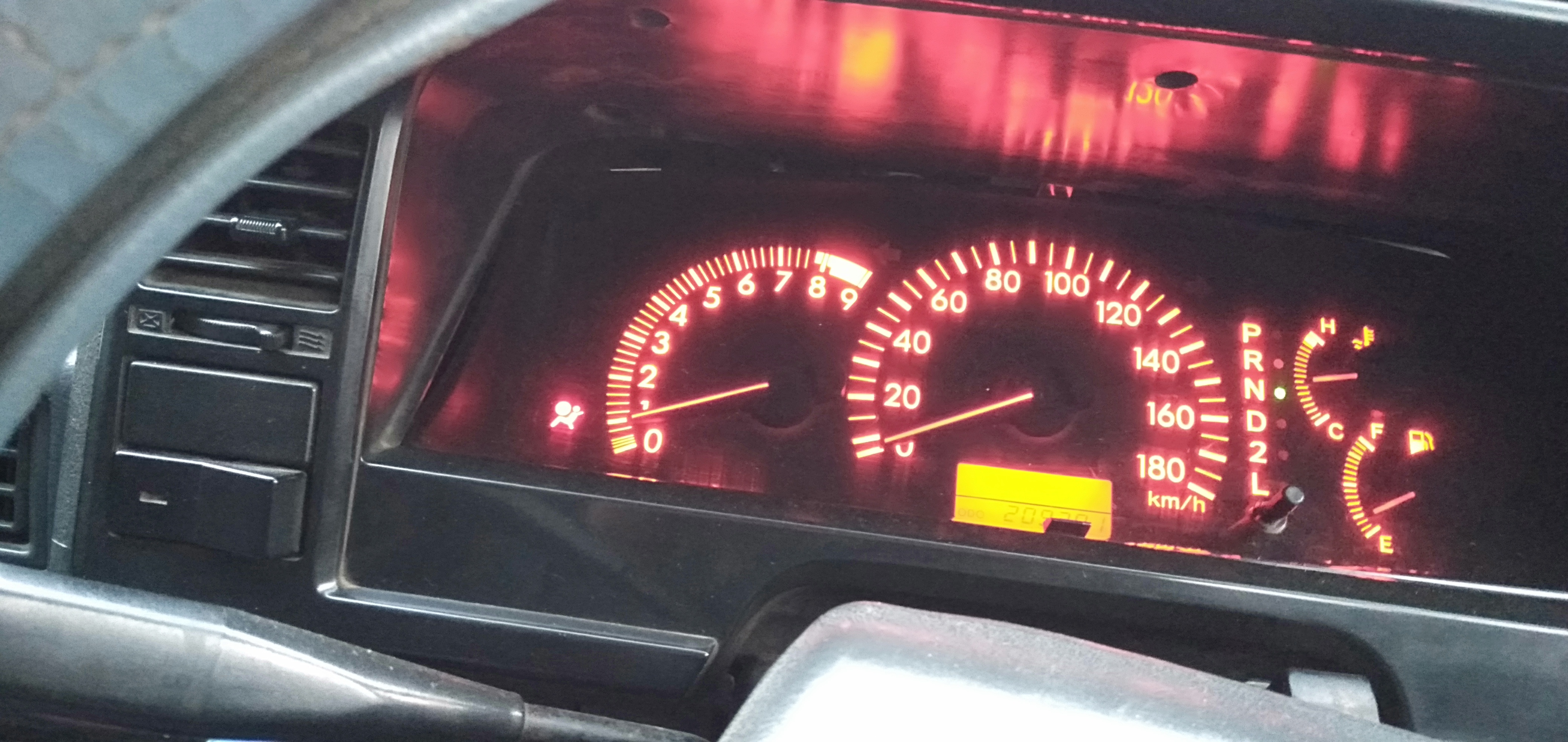

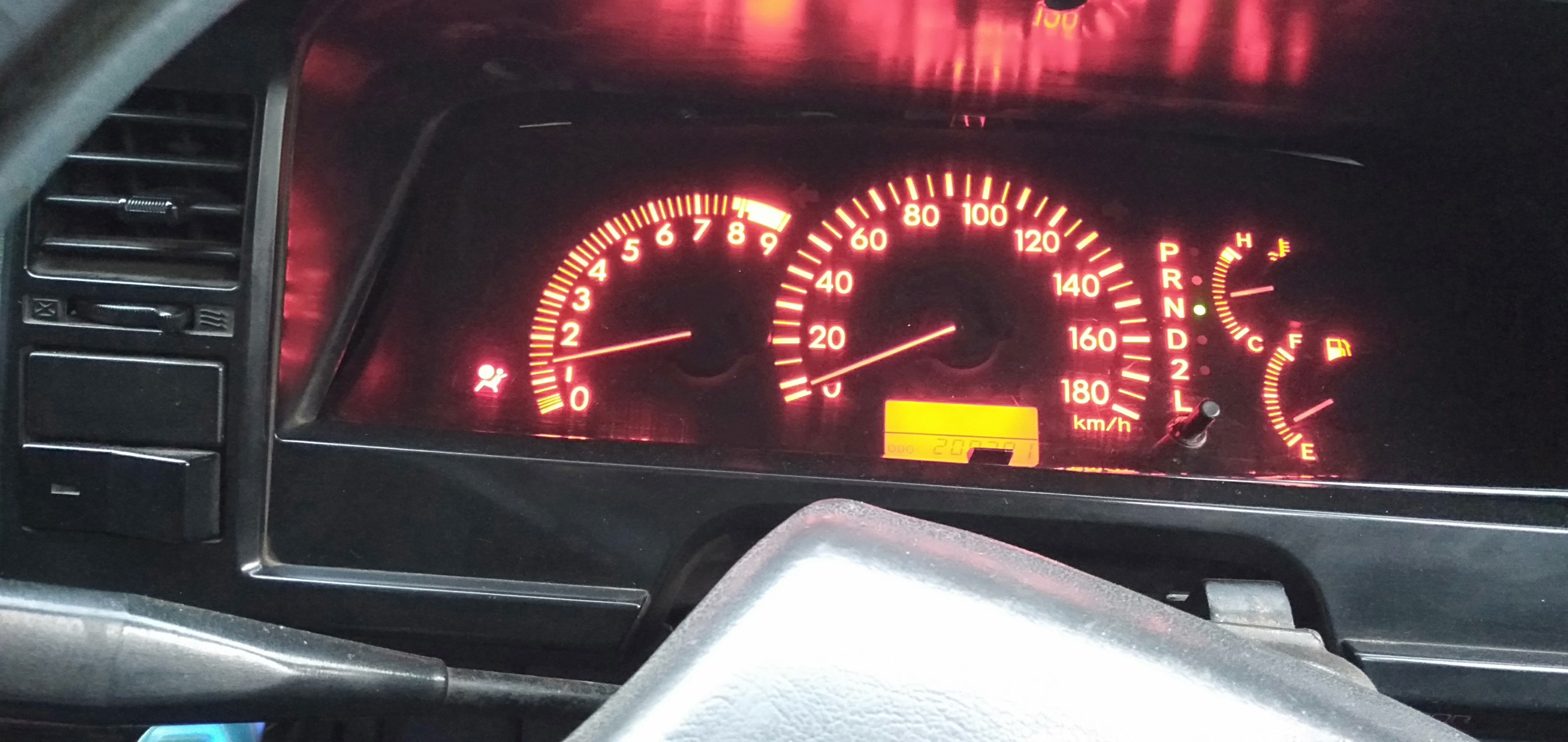

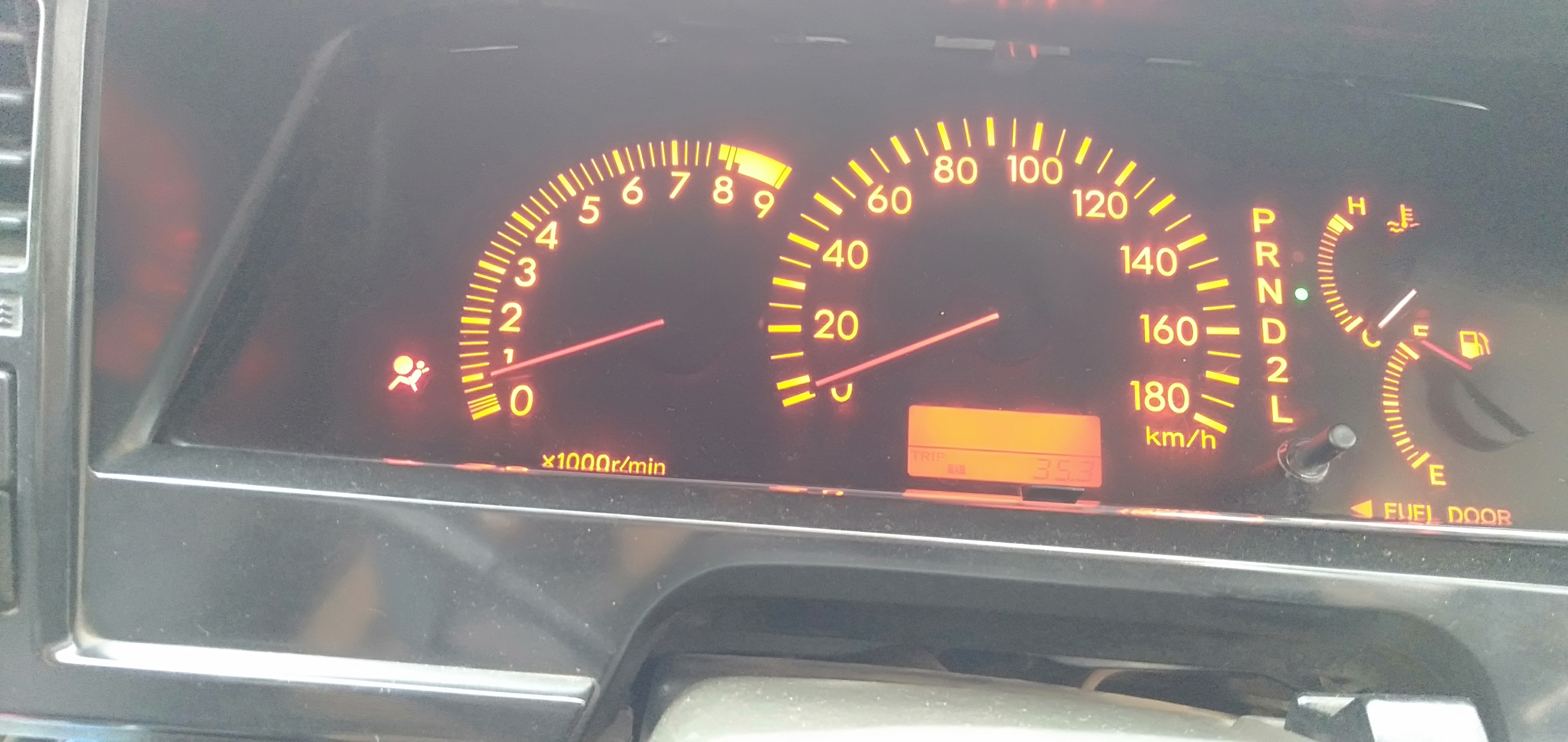

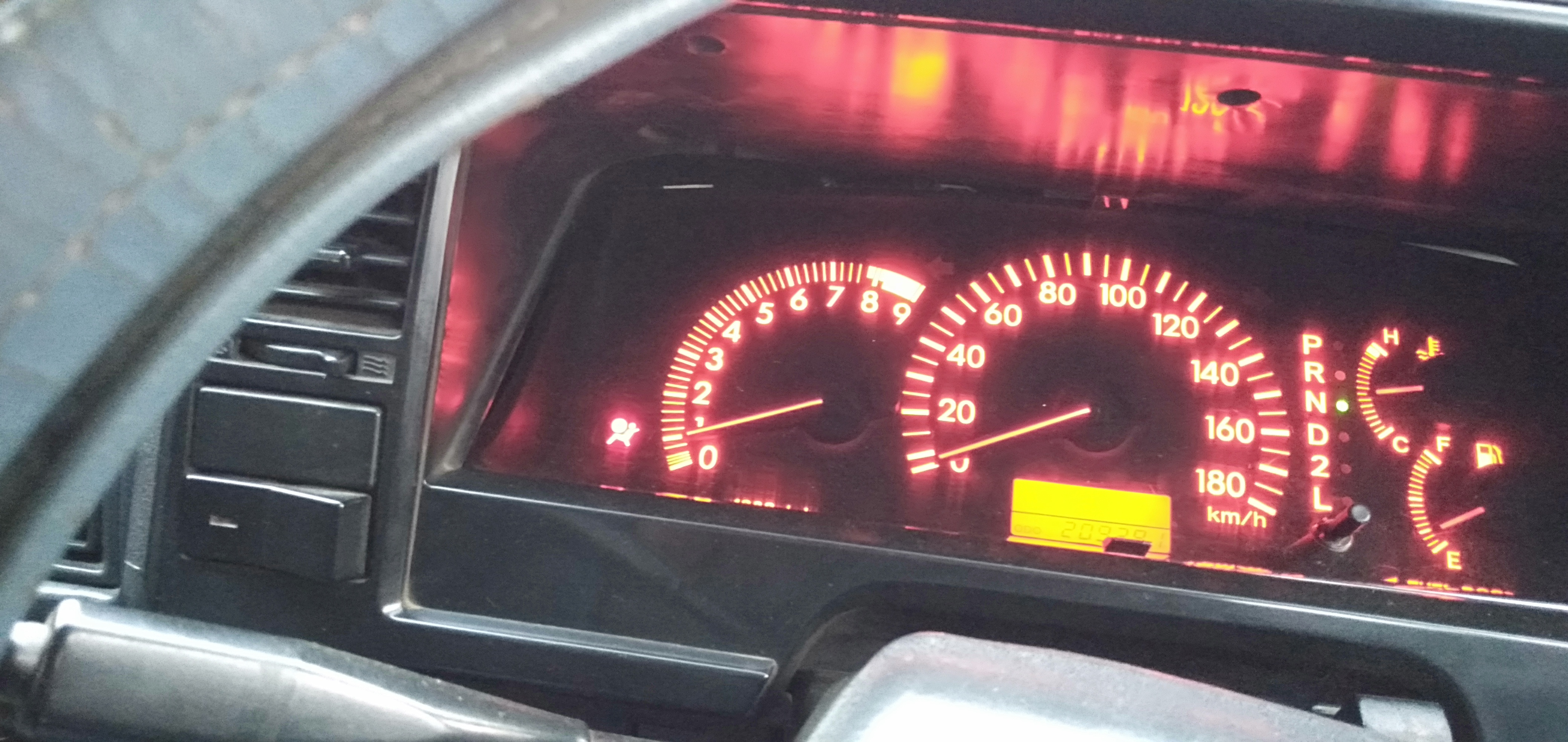

1200 rpm zeyada hai petrol pe. Drop it down to 800-900.
Aor cng wala ok hai
Vo 1k tak hai. Ager thora low ho jae tab bhi sae hai varna rehny daien.
Tnks bro
No problem.
Salam bro kaise hai apAj mainy apni 1nz ki rpm setting Karli cng pe 1000 pe chorr diya or petrol pe 900 pe..Mere problem to ab solve ho jayege na
Wailaikum Assalam.Ya ap check kr ky btaien. Petrol pe jerk hai ky nae.
Filhal to jerk hatam hai Bhai
Ye aaj subah hi chk kiya ta bro
Sae ho gya congrats.Vesy rpm jitna cng pe hai utna hi ap petrol pe kr do.
Tnku bhai
