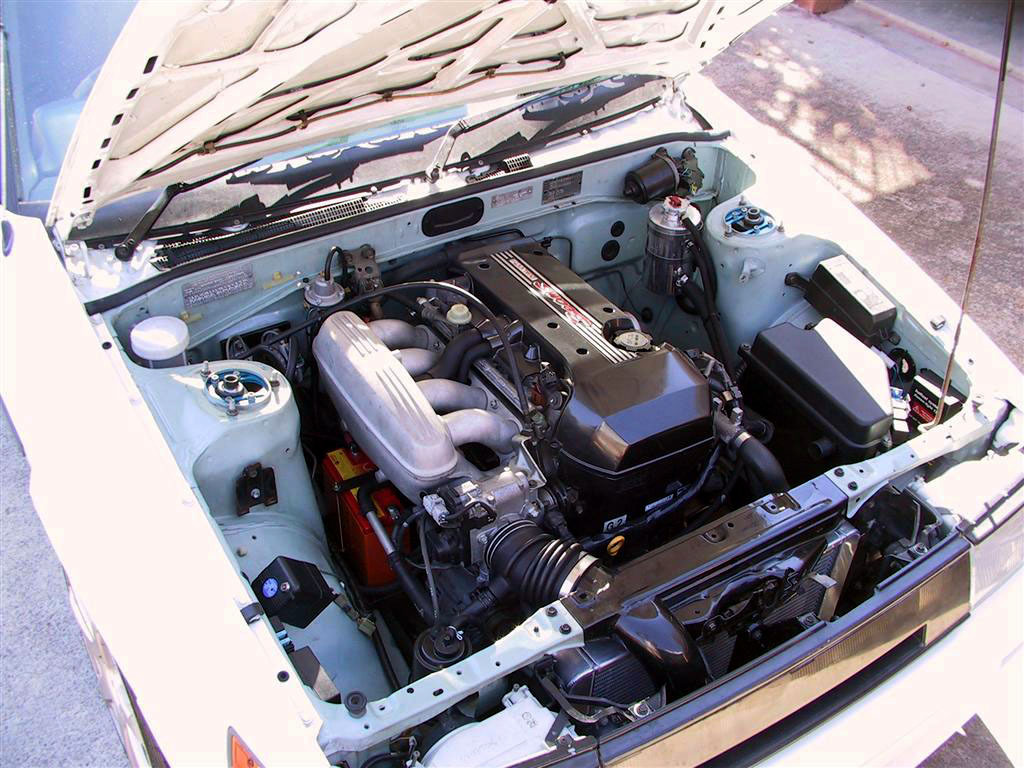

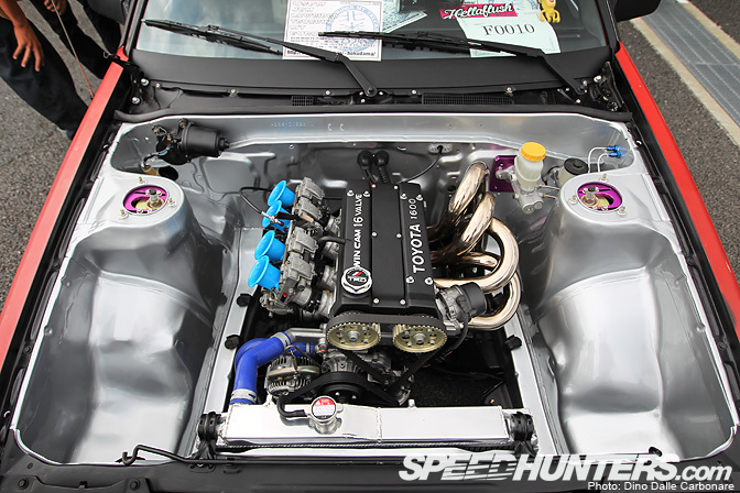

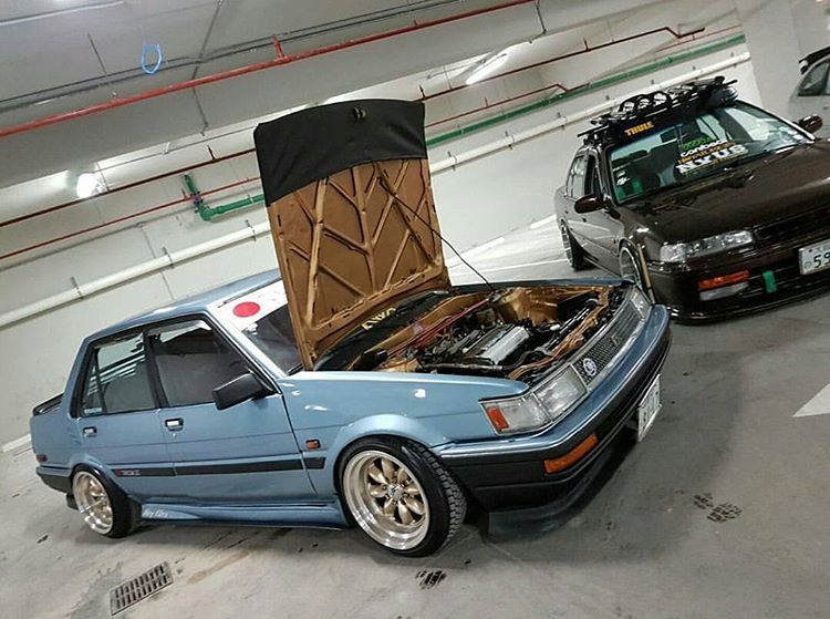

Fantastic 20v engine and body works
20v is just a teaser
HahahahahahahaBtw what is the fuel average of 20v engine?
should be 9 to 10km/l.
think they are the robust engines as compared to the other efi series engines...what would b the appropriate cost of engine with gear box?
Bhai everyone thinks the same....it's price is same as other 4a series engine i.e round about 1 lac.

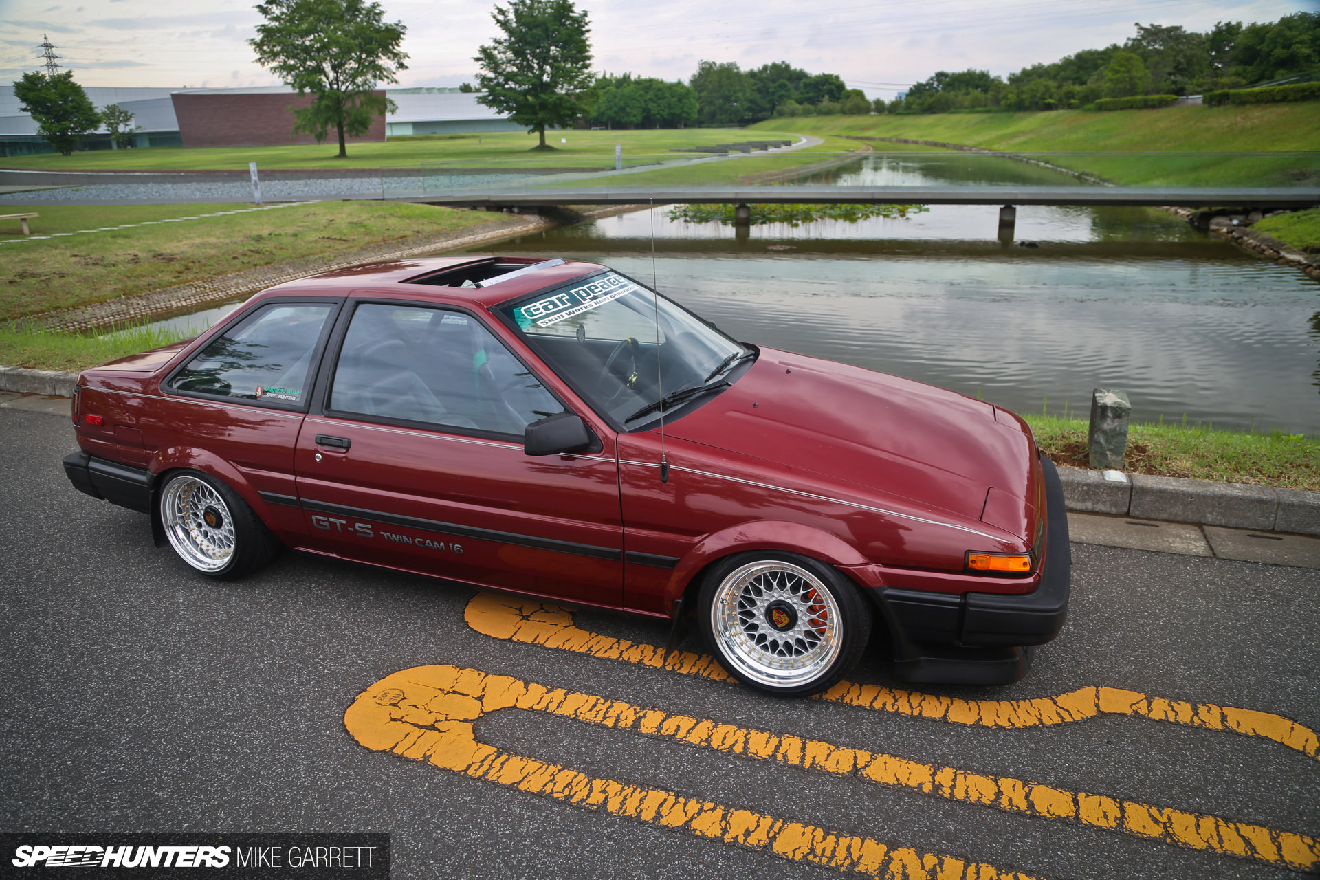

[/quote]Front bumper lip entirely change the look of 86 into sporty look.

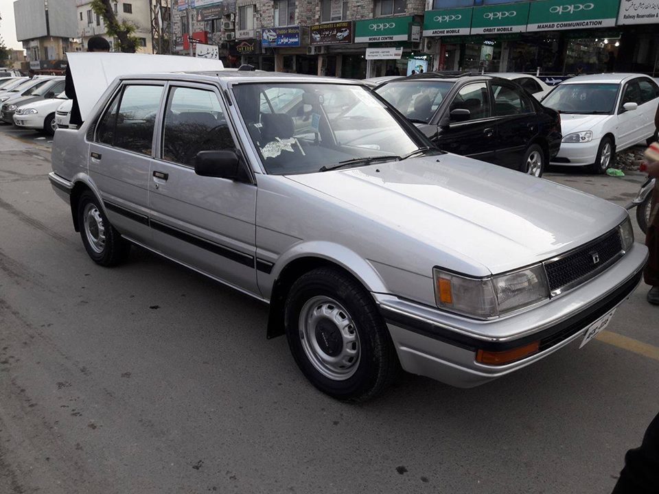

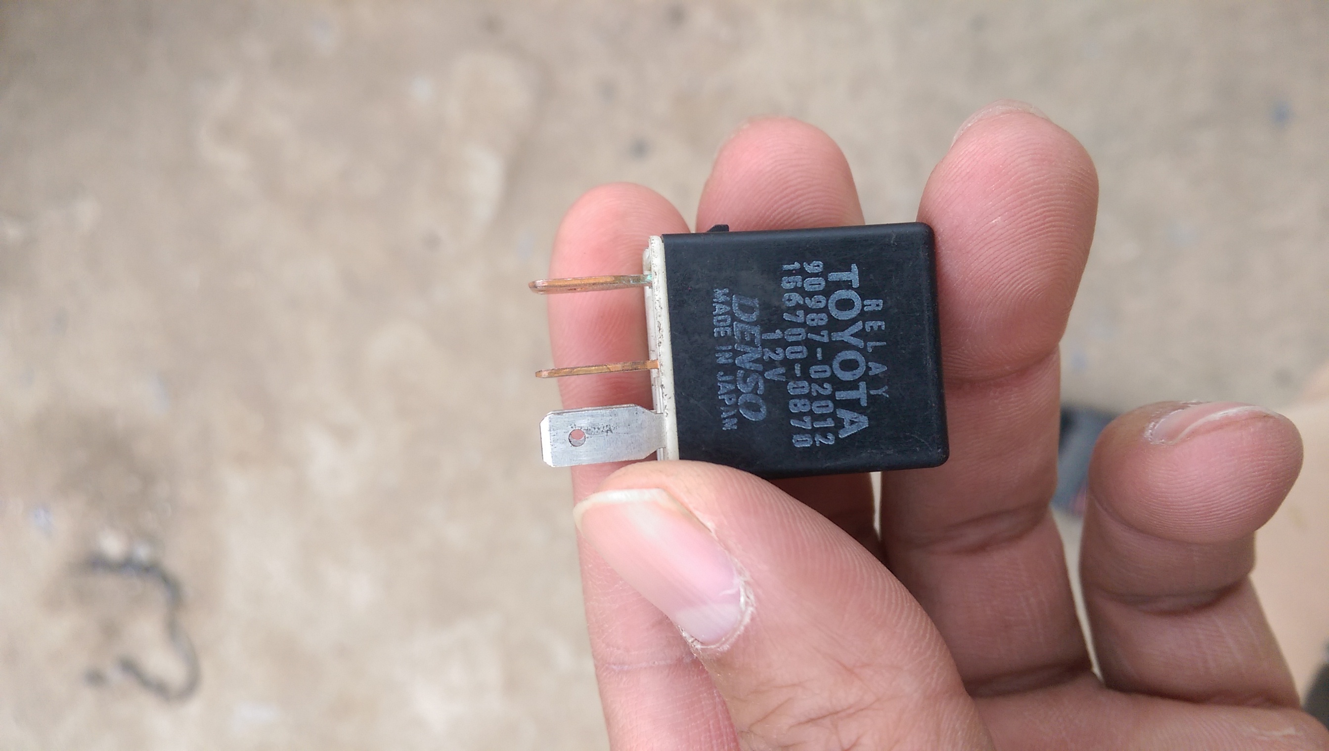

I wana share my experience about my car today.Car was started after two days...started on 1st self...without any prob ...then I went for my home chores...finally when I was on the way home I decided to fill petrol tank to some extant as I usually do...after filling with petrol the car was not cranking...dead self..then petrol pump guy pushed and it started going at once. Then at home I tried several times to start and off..it never reveald the problem again...once again when I was going out I started the car...same thing happen. I decided to check it to my electrician guy...he checked it in details everything..long story...finally he spotted the problem. The problem was bad Automatic Shutdown Relay (ASD) he replaced it and it works..this might be due to water in engine last week when the service guy washed the engine with water..with the passage of time water detronates the relay..
but only front lip from GT ae80 NOOO rear lip 86 looks super awkward with rear lip and also with side skirts.But this one is pretty nicely done
bhai cover the bay fuse box or try to seal it and you should be glad only relay shorts......cause mien corolla inside fuel box is damaged so i had installed all new wires and cut off fuse box connecting to much extent.
U r right bro..Yar ye relay fues box k bahar ha near the air filter assembly and fuel filter to the right side...mechanic had wrapped tap on it.
