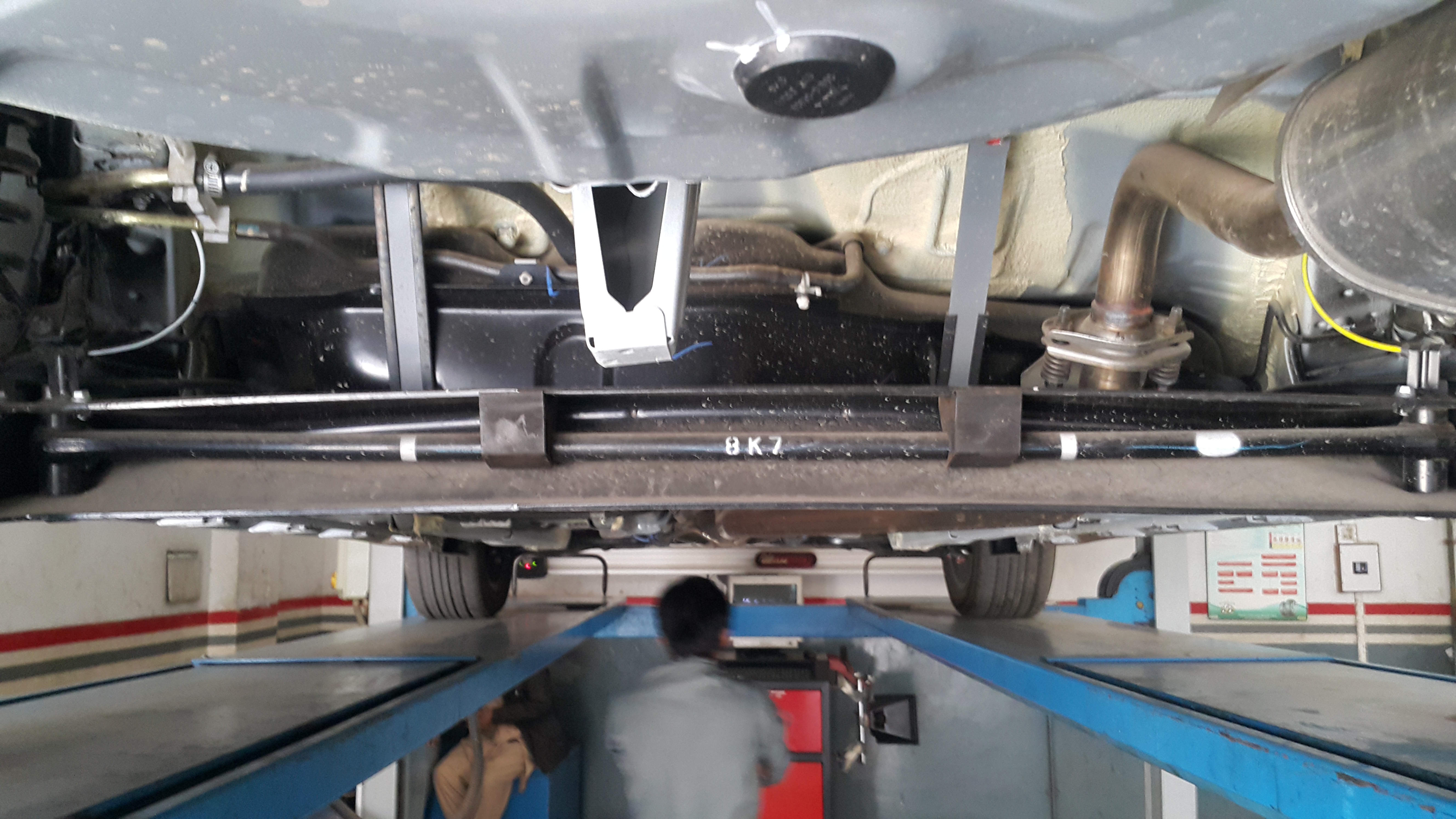

All those who are going to 3S. Do they remove old grease from caliper pins and put proper grease on it for regular brake maintenance?
Went with a cousin to Toyota Rawal and when they simply cleaned up in brake job without even opening the caliper pins, I asked them to grease caliper pins. Their response, "No, removing it and inserting the pins again will cause problems. Agar jaam hoon tab kholte hain. Size bara hojaega nikalne se." And I was like whaaaaaaaaaaaa
