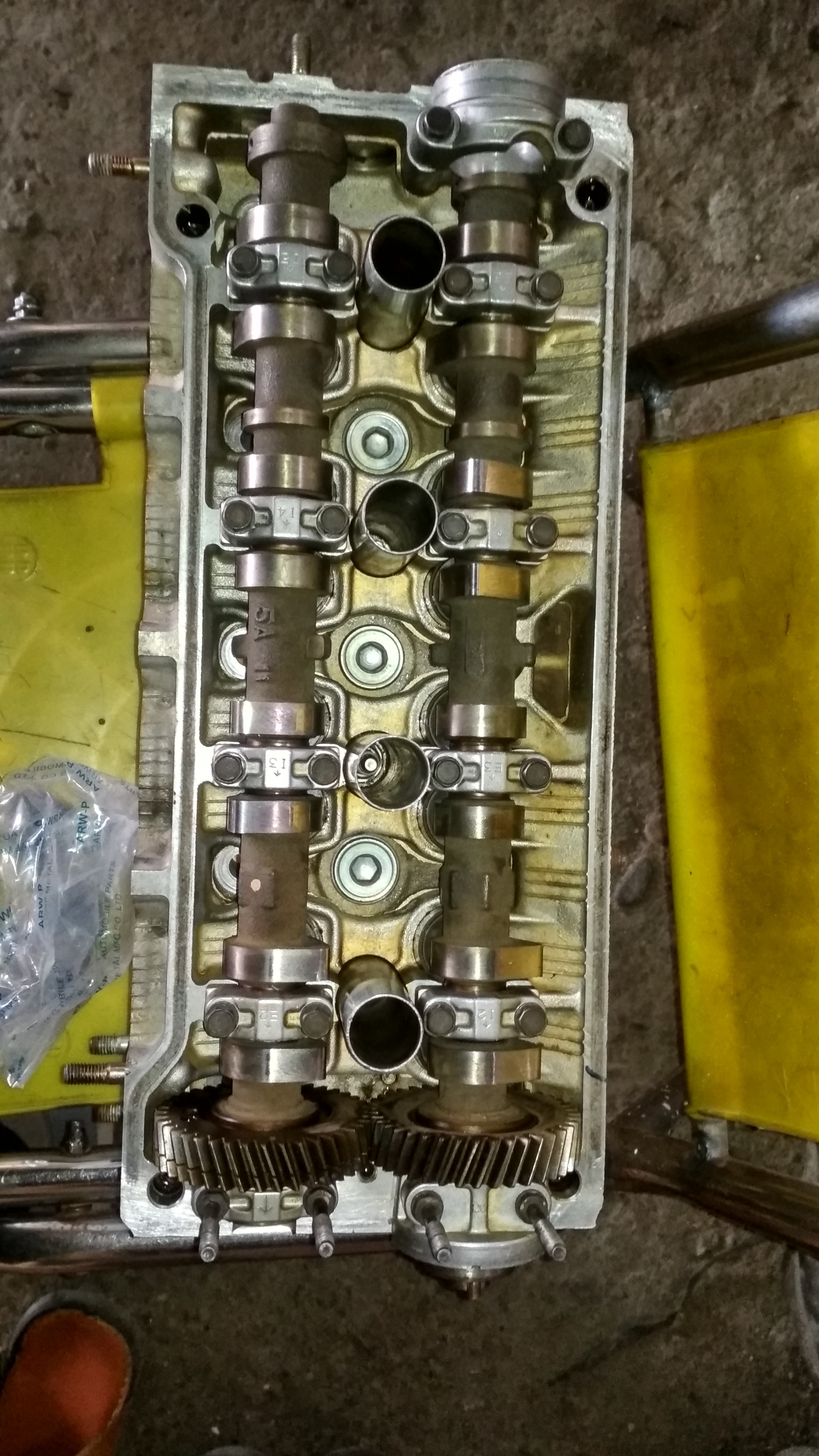

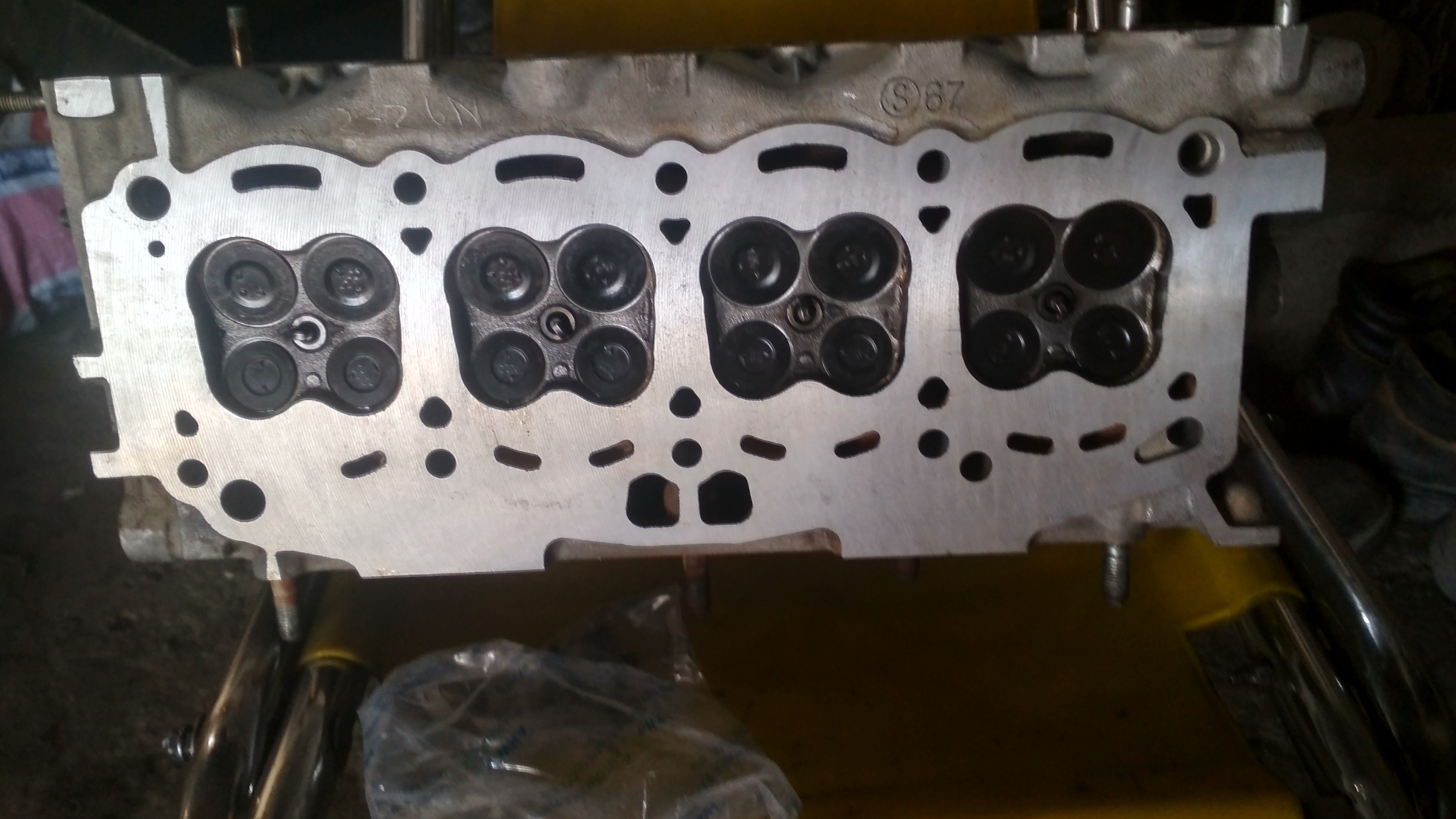

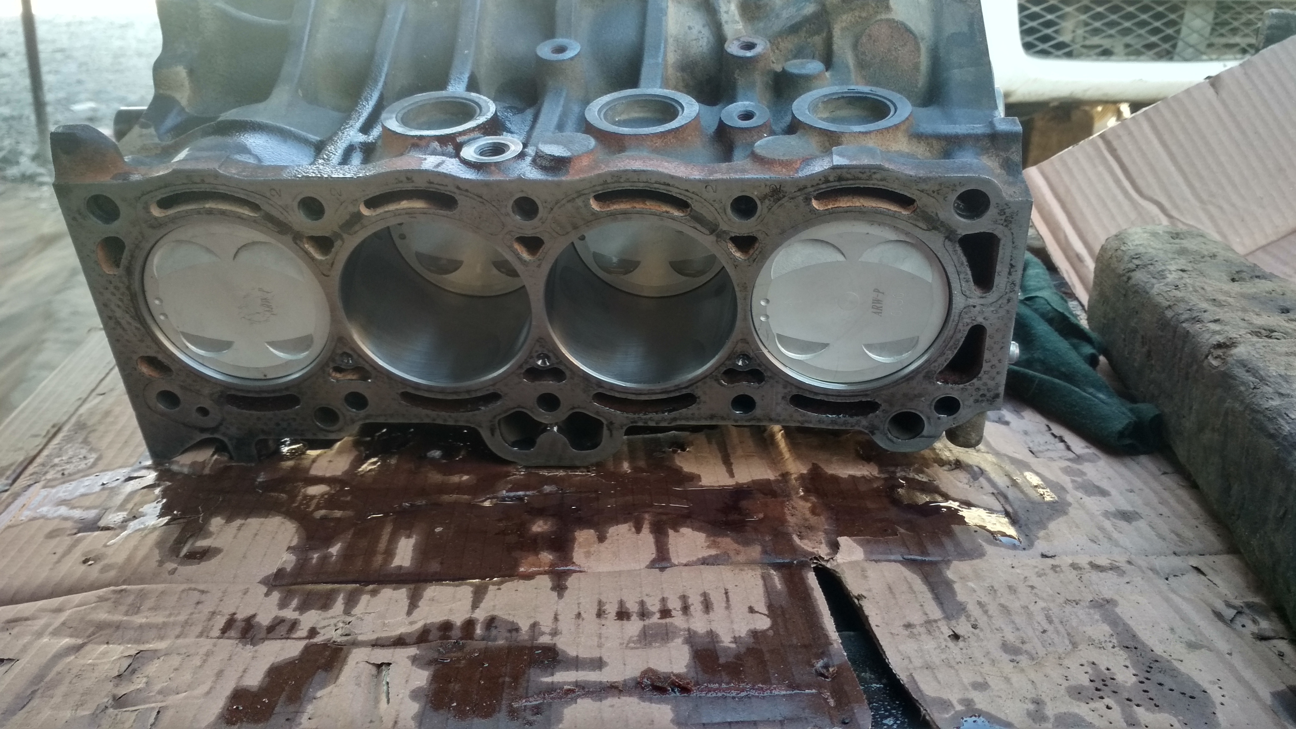

So in January 2021 finally decided to took apart the head and i was in favour of only rings and valves seal replacement.
When the engine was taken out and opened the rings were shot allowing too much oil to pistons, rest the pistons, cylinder walls and other things were in pretty good nick but the mechanic insisted to go for complete overhauling on his risk to avoid any issues in future.
So i let him do his thing.
Things changed:
Piston 0.50
Rings
Valves
Valves seals
Crank pieces
Main oil bearing
Gasket
Oils etc
Took 3-4 days.

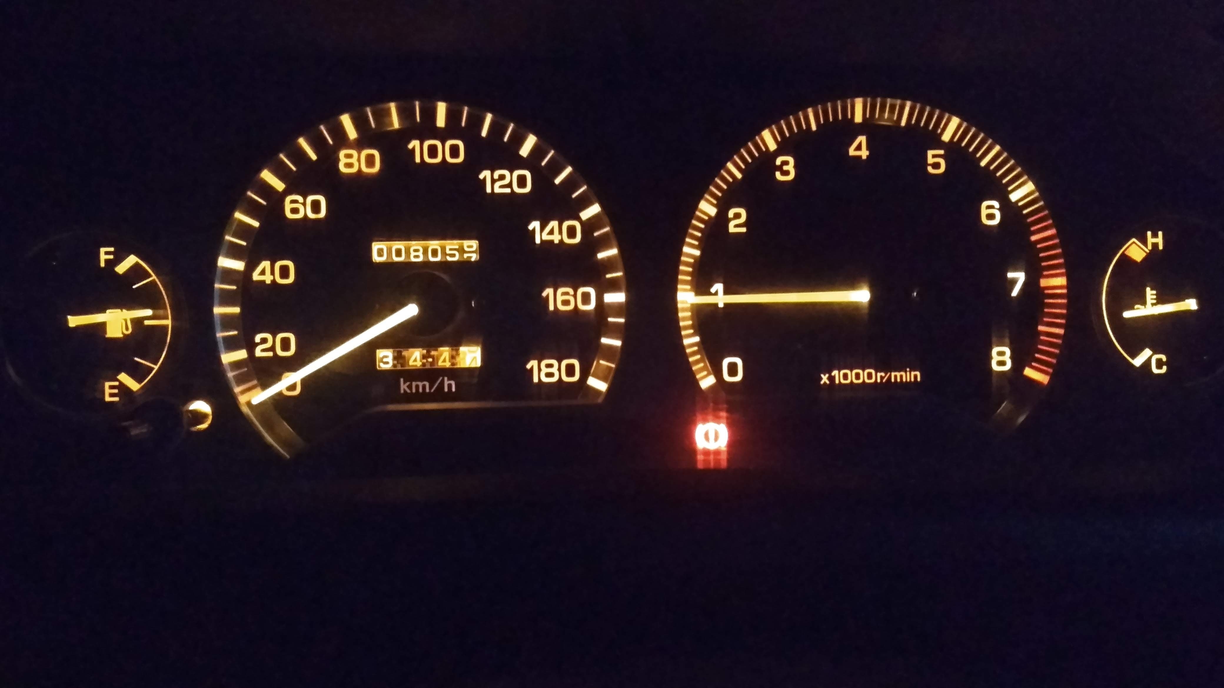

Brought it back home and drove it 800km break-in period in a month.
Changed engine oil after 800km. Used shell 10w-40.
Milage at time of overhauling was 12000km.
Milage in july 2021 was 18000km.
6000km after engine overhauling. 2 oil changes.
