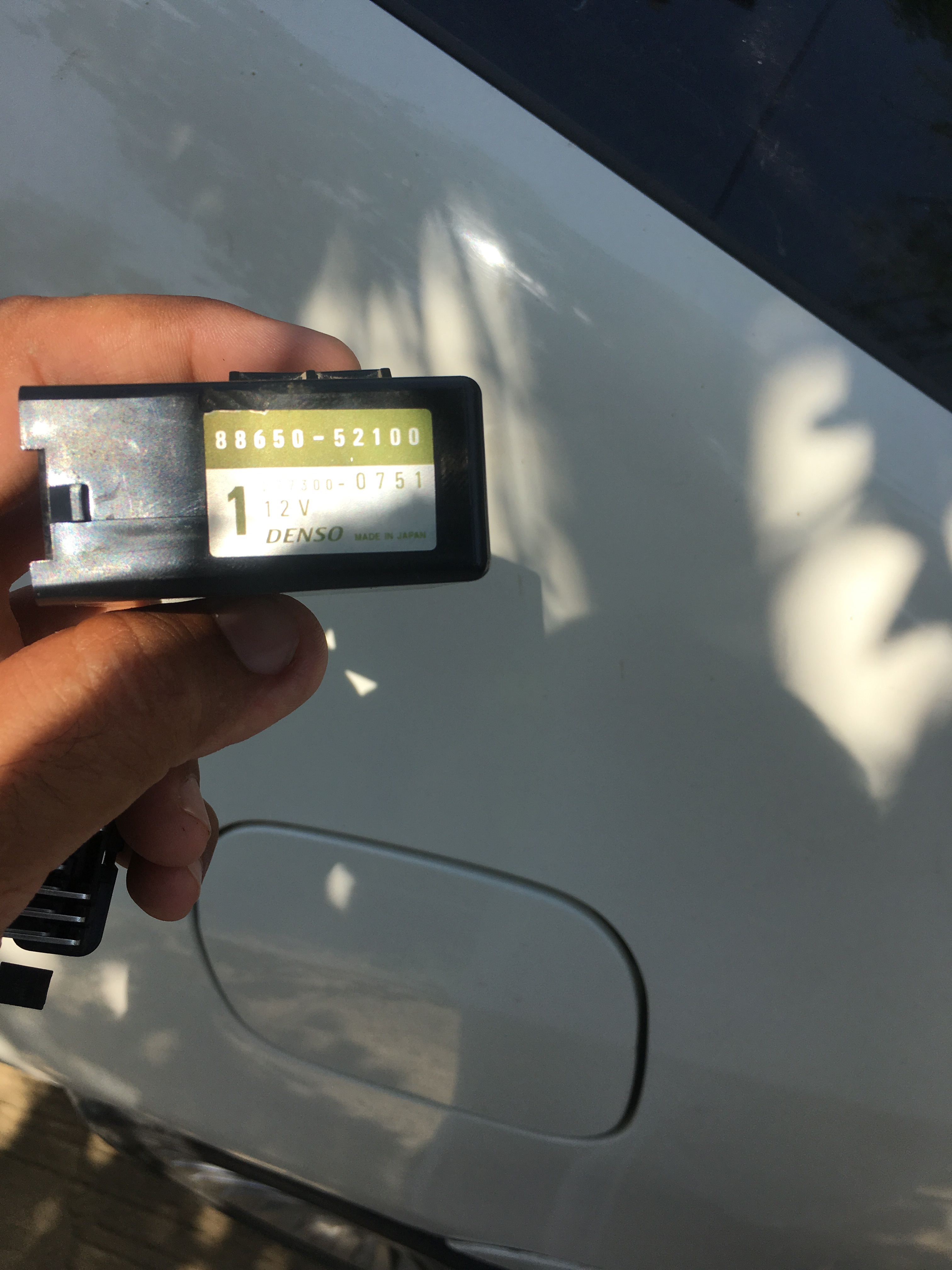

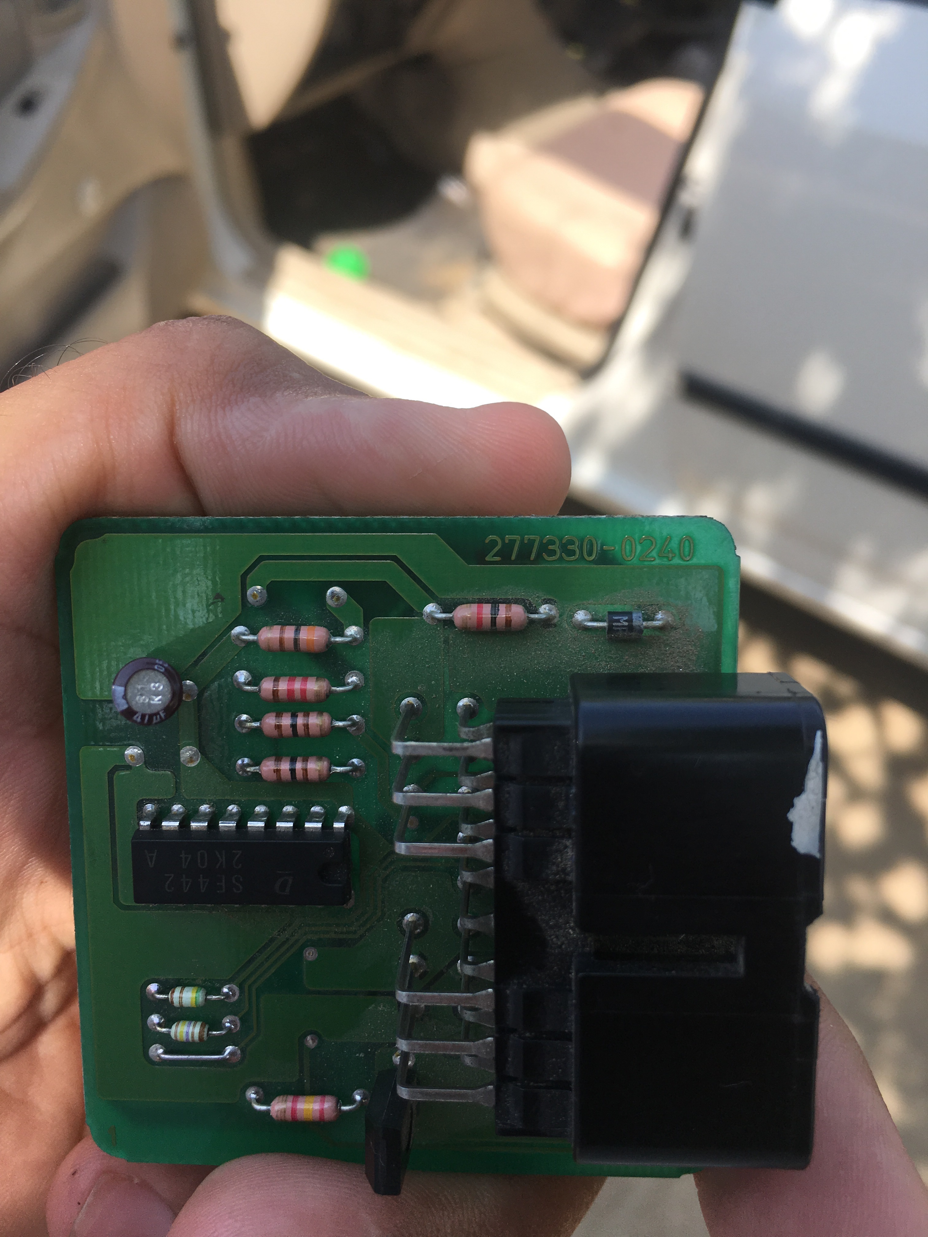

AC Control unit.
Where to find it and how much?
Many of these terms were made up by car dealers and rent a car Wale. They have such idiotic nicknames for so many cars Kai aap ka sar Ghum jaye ga.

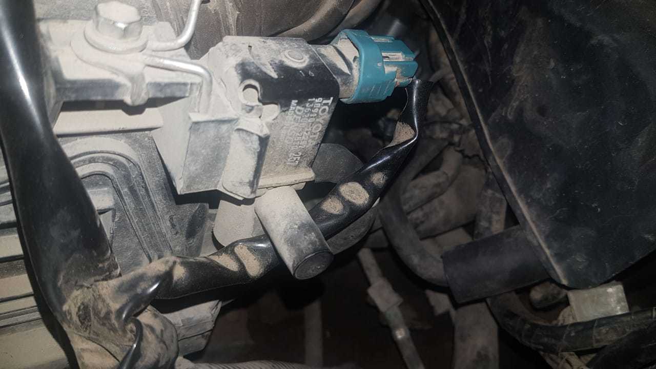

@sameerulhaq064 @rajaahmed96Please answer as car cannot idle and stalls. This filter is also not fitting properly. Recently throotle body was cleaned. Can there be any setting for idle speed adjustment? Please guide me. Thanks
Does it struggle at idle with RPM variation?

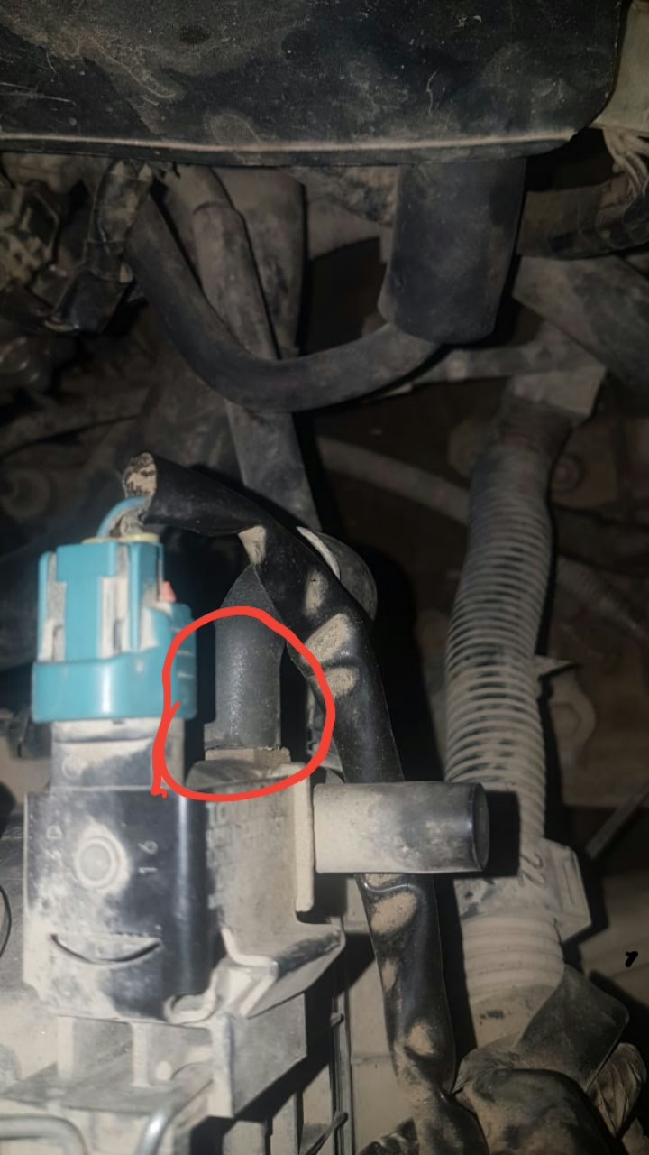

Ok so this pipe was not plugged in. This may came off due to back fire.
Can you tell me what is the purpose of this pipe and why it came off due to back fire?
@capsat @Xulfiqar Your input is needed.
that is the evap solenoid - and its capped off because there is no evap control system in the local made corolla as it was not mandated by the govt.
Its connected to the manifold on one end thats why it can pop off in backfire.
ThanksCan you tell me why when this pipe pop off there is idle issue?
