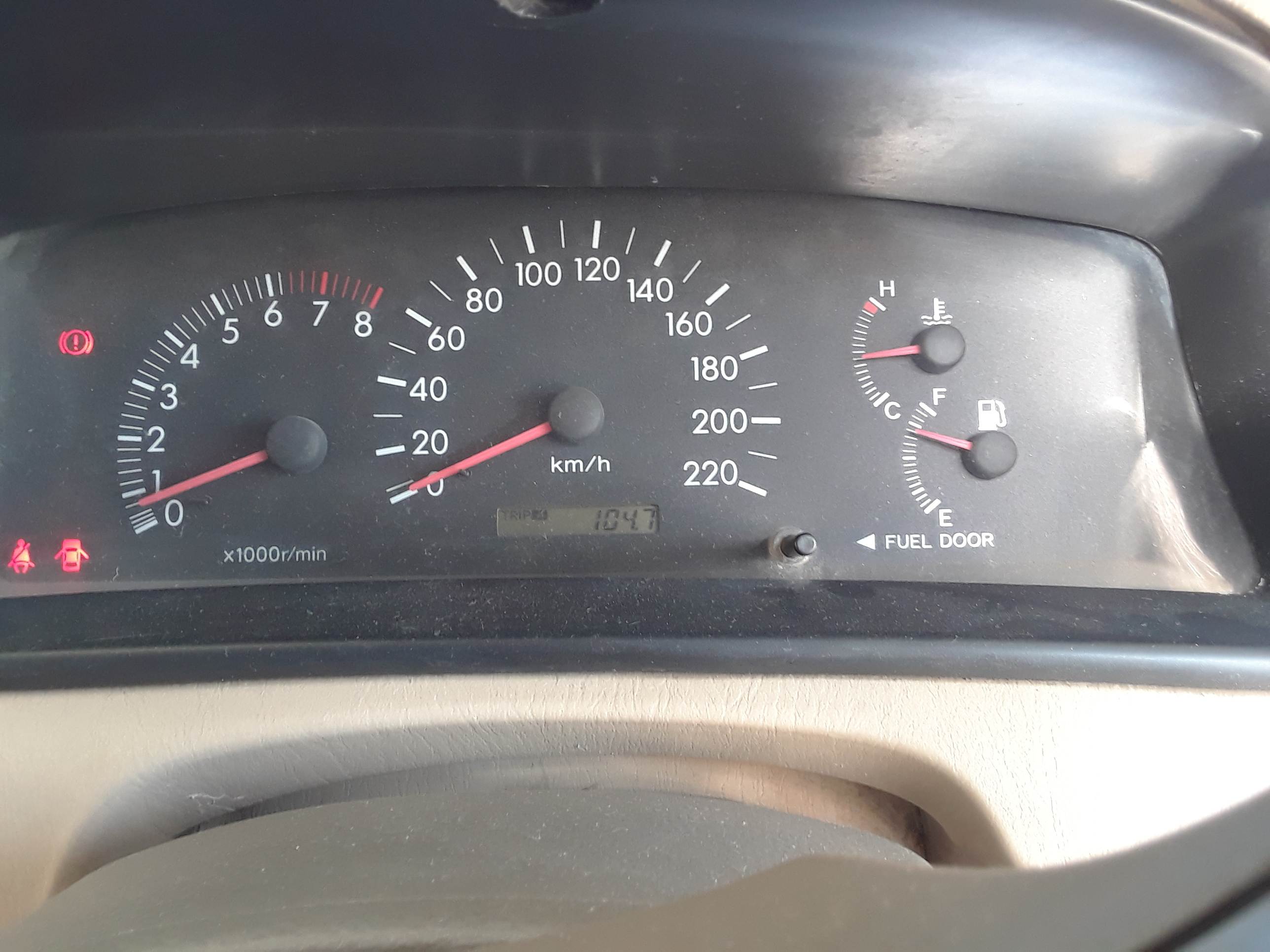

the RPM difference is too much, if its with auto txn, is the TCC locking up?
turning on the AC DOES increase the RPM from 900 to 1000, if there is no impact on RPM then either its not wired up properly or the RPM are already on the higher side.
