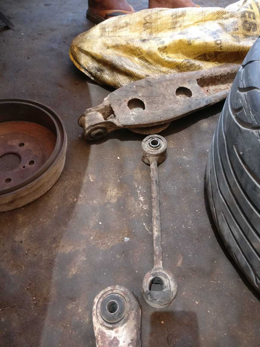

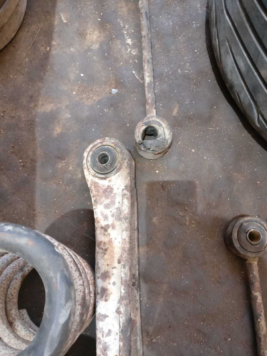

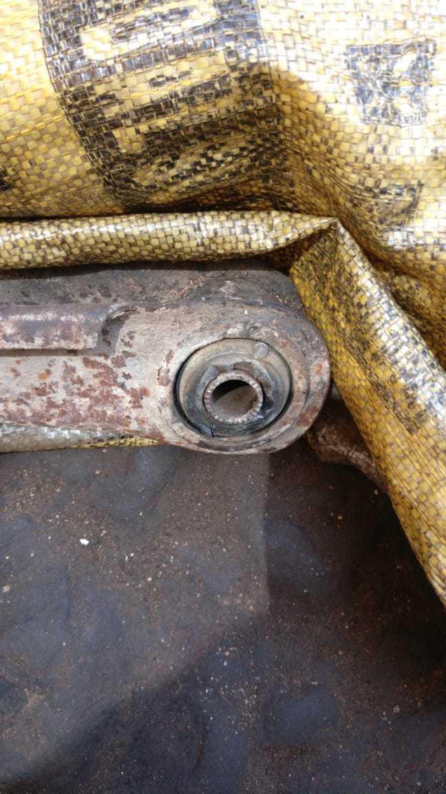

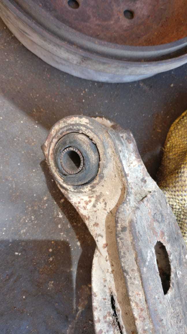

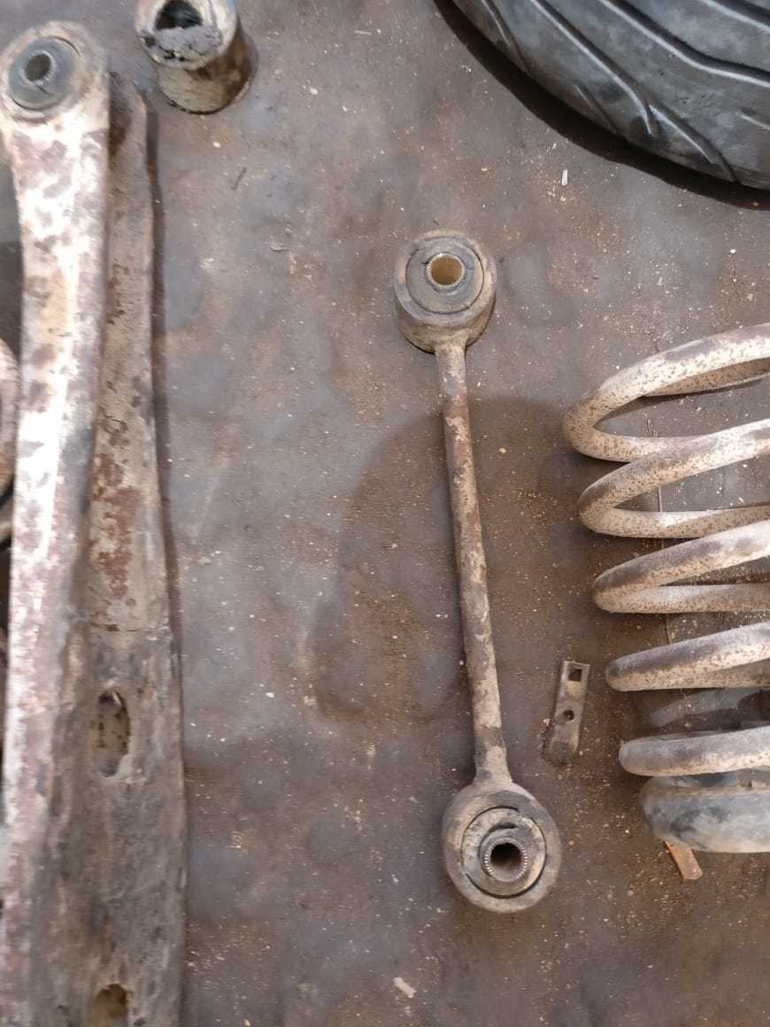

Yes bushing was the problem, if you can look at the bushes there is nothing left lol hence it was pulling on left first snd then right, as the right bush of balance rod was non existent.

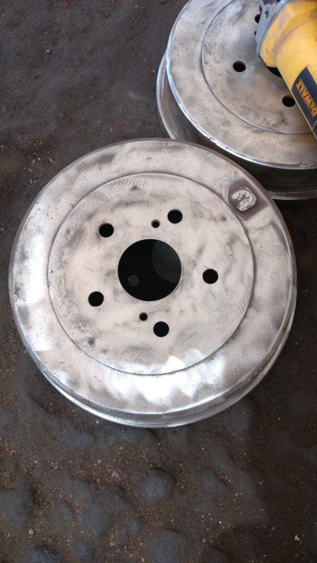

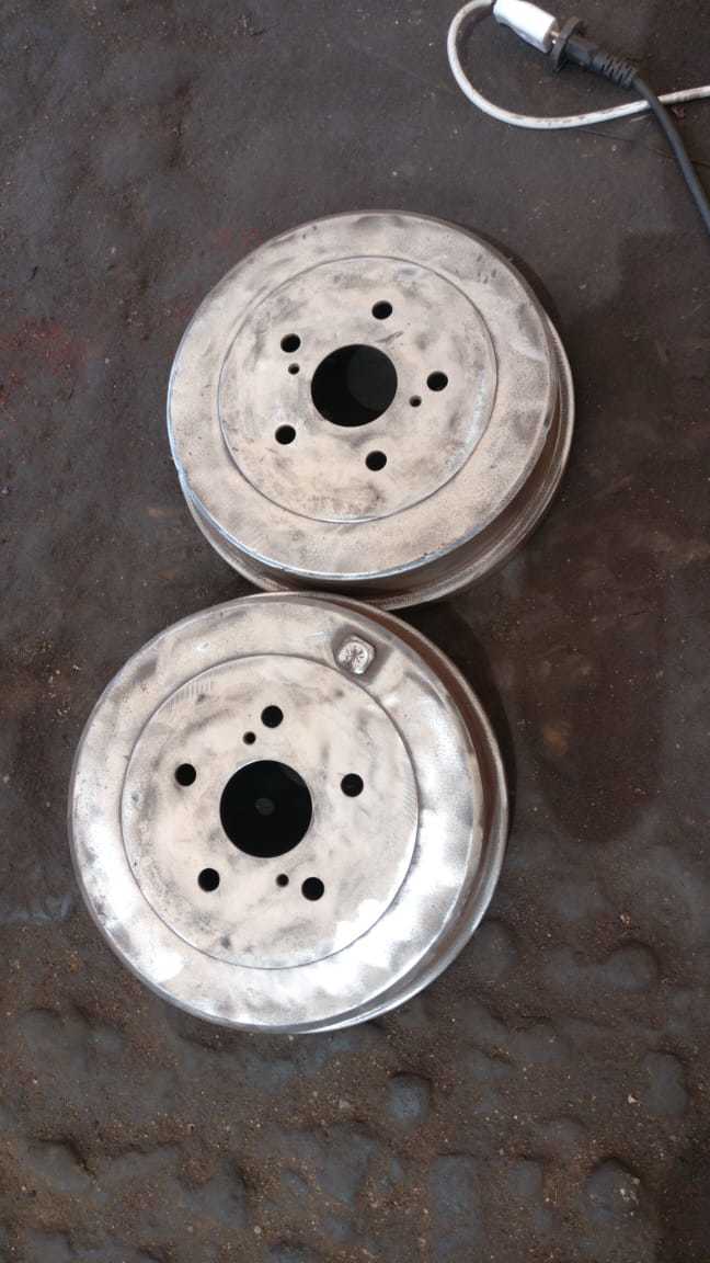

Changing the steering box aswell to eliminate some minor issues, rear complete end was stripped out, brake service done, was getting it cleaned will get the tube painted and rest powder coated iA. If we find right people these project cars will get done allot quicker.
