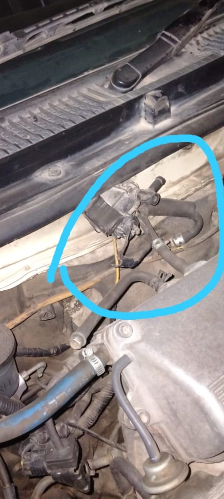

I am also having similar issue, when the car is idle, turning on the ac drops RPM and car starts shaking and switches off sometimes.
? What
This is called VSV ( vacuum switch valve ) and the one came in ae101 was adjustable. It's a simple switch which allows the flow of air when voltages are applied. Thus rpm rises. You will see 2 connection on vsv. Connect one pipe of to the intake manifold and other to throttle body.
My grip wires are broken and pipes are also broken.I will fix it when I visit mechanic.Thank you for your help
