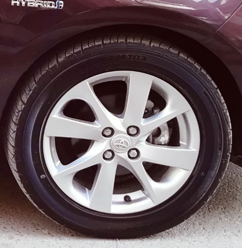

Salam. I hope everyone is having a good day. I will be changing my Tyres and rims soon in Aqua. After a little research and comparison I shortlisted the following 2 Tyre sizes
Requirements:
1 Ground clearance
2 Looks
Tyre sizes:
1 185/65/15 with rim width 6 inches, ET 38
2 195/55/16 with rim width 6.5 inches, ET 38 or 39
Now the weight of the OEM rim(15 inch, rim width 5 inches) is about 7-7.25 kg (source Prius c forum ).
Ideally the rim which I will buy should weigh less than that or about the same weight. Now my query is has anyone fitted these rims with the same above specs. If yes, did the Tyres touch the fenders? (this is especially important in case of 195 mm Tyre ) .
A slight bump in fuel average is acceptable for me.
Also do tell from where in Karachi I can buy Good genuine rims ?
