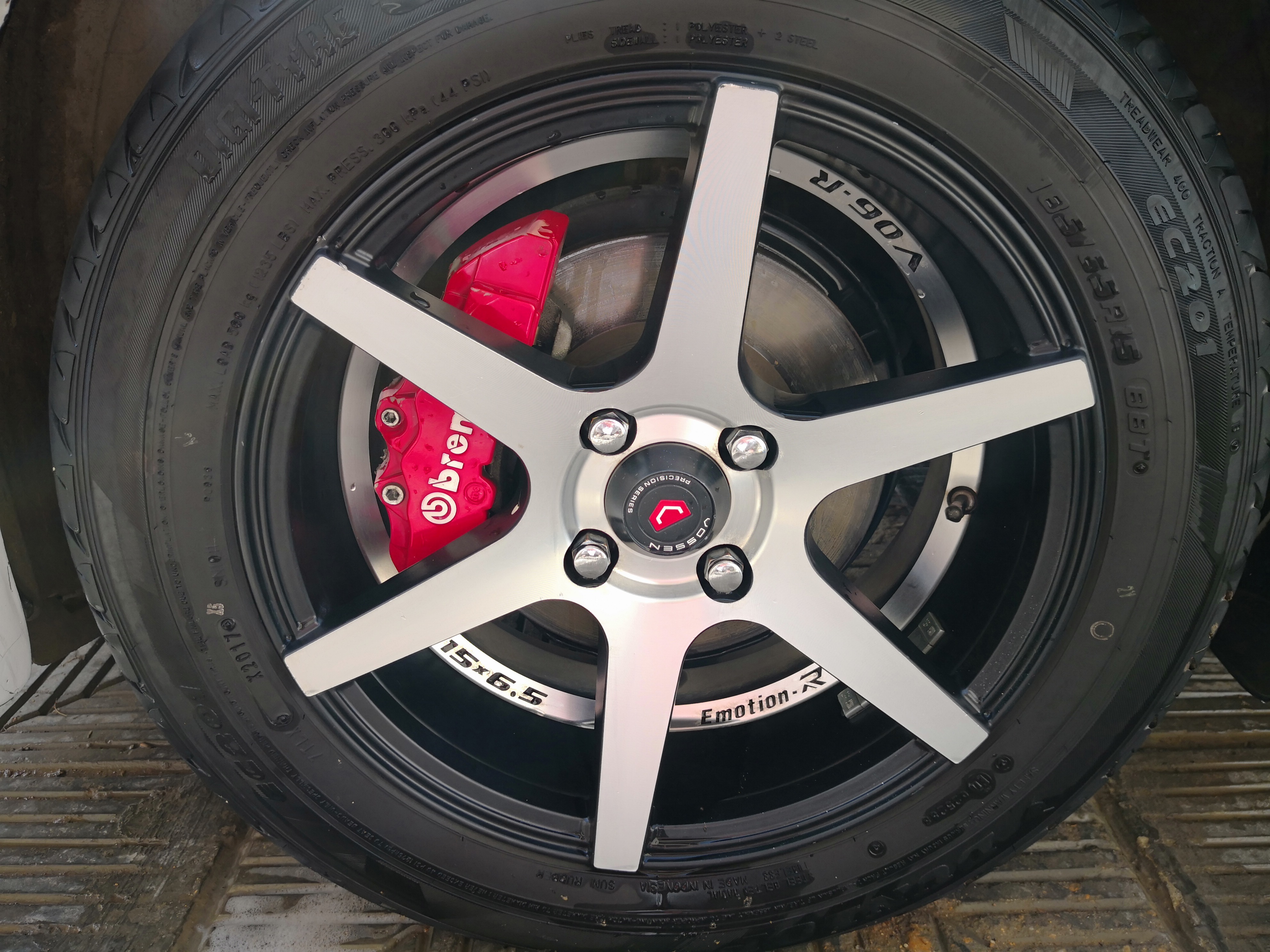

2.a. Tyre - 175/65R15
2.b. Tyre Pressure - 33 Front 31 Rear
