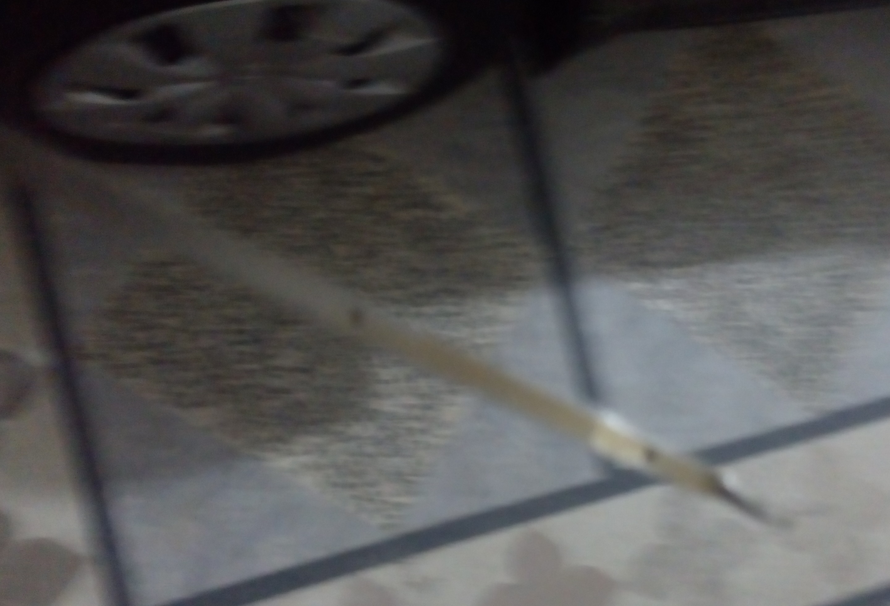

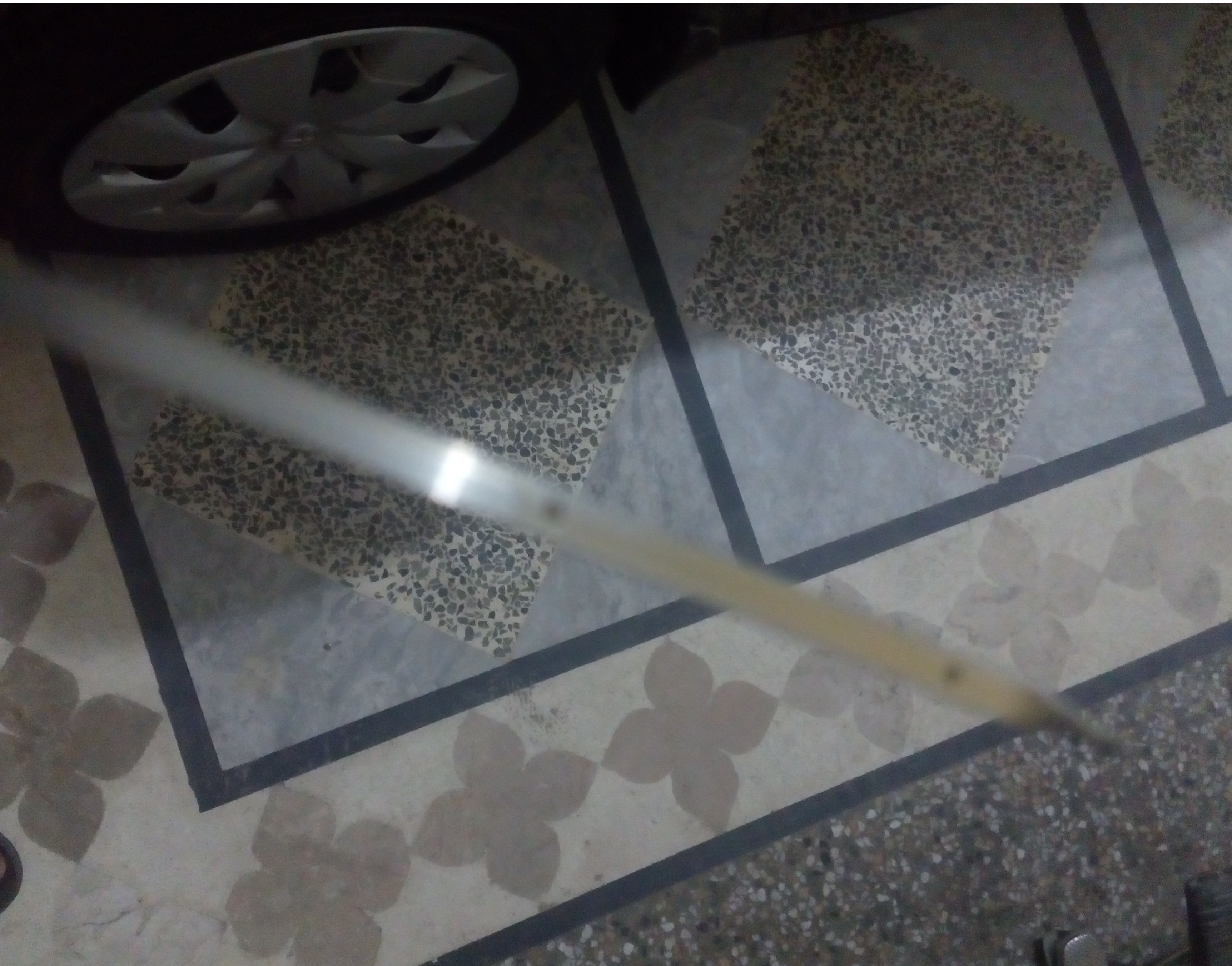

Nice question bro. But before I answer this, I want you to do this procedure below to mark your dip stick or in other words put graduation marks on you dip stick.
1) Fill enigine oil gradually into the engine in small steps and after each step, check the dip stick.
2 Once the oil has reached the lowest level of your dip stick oil indicator, here I mean the lower level indication on dip stick which is a engraved DOT in your case, take this as point ZERO.
3, Next add take a graduated measuring container and add 50 ml oil into the engine after measuring it by the graduated container. But a mark on dip stick, this shall be your 50 ml mark on dip stick from zero reference point.
- Similarly add 50 ml oil more into the engine like before, this is your 100 ml marking from zero reference point.
5) Repeat above 50 ml to get graduations on dip stick till you reach the max mark.
With above method now you have got graduations on your dip stick each one being 50 ml.
Now you can know the oil consumption in relation to KM driven with this graduated dip stick.
