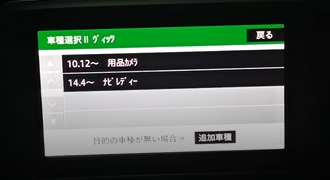

Step 2A. Select model to “Vitz”. (Just below of WISH)

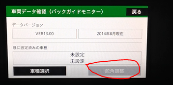

Step 3: Select "Steering Angle Setting"
There will be two buttons on the screen "Steering Center Memorize" (left) and "Max Steering Angle Memorize"(right)
Step 4: Make sure the steering wheel is in the straight ahead position, and press "Steering Center Memorize"(left option)
Step 5: Turn the steering wheel all the way to the left and press "Max Steering Angle Memorize"(right option)
Step 6: Turn the steering wheel all the way to the right and press "Max Steering Angle Memorize"(right option)
The system should then "Beep" and return you to the previous menu
