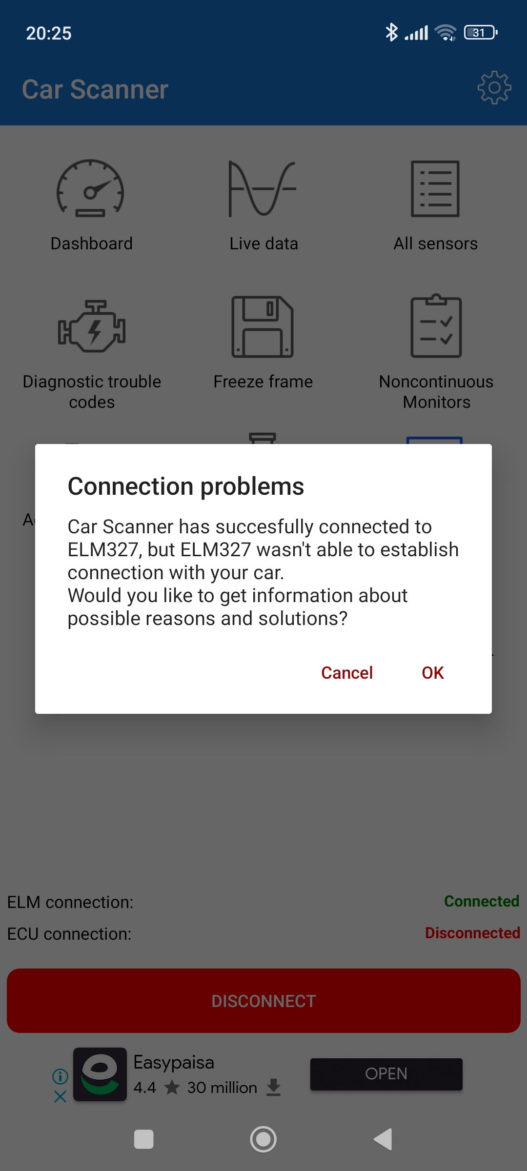

Hey brother, I have got the scanner but it's getting stuck at "Checking Models" when I try to connect Torque (Lite) with my Vitz 2009. What should I do to make it work? Attached is a screenshot.
Add another gauge analog one and scroll down to sent vaccine boost pid, also verify the pid data update? Which protocol you have made obd2 connection to ecu ?Check EGR value itās harness and wiring it code still after clear

So, I have installed CarScanner OBD2 app from PlayStore

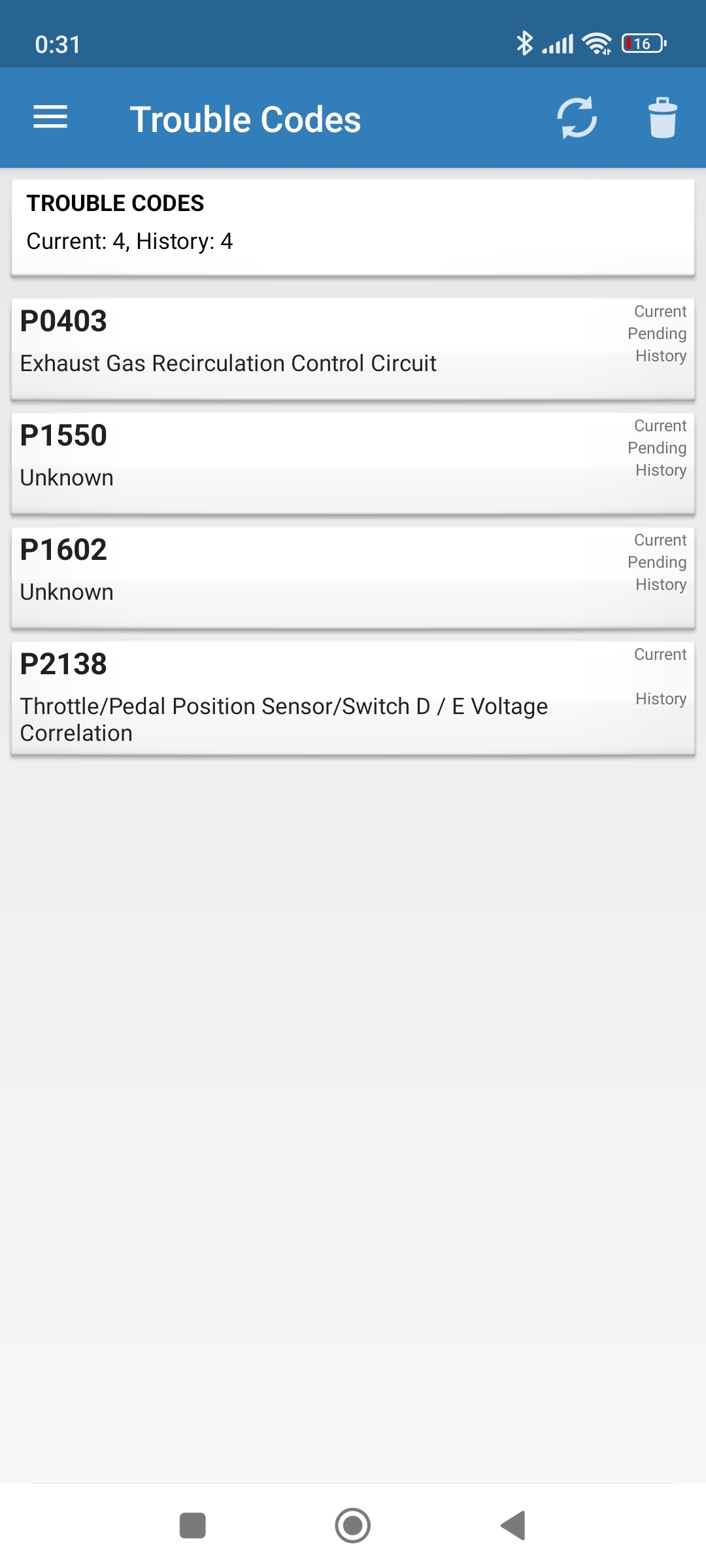

I also installed ELMScan Toyota from Play Store and it got connected. RPM shows like this and it also gave me the attached fault codes. This is weird why Torque and CarScanner is not connecting but ELMScan Toyota got connected?
Try vitz 2009 cvt bottom protocol in Toyota list, well reset the code logs and scan again which exactly elm you have ?
It's an unpaid Version so it's not letting me clear the codes.
Strange even I have used unpaid and able to clear , I think you may have different obd2 firmware versions
