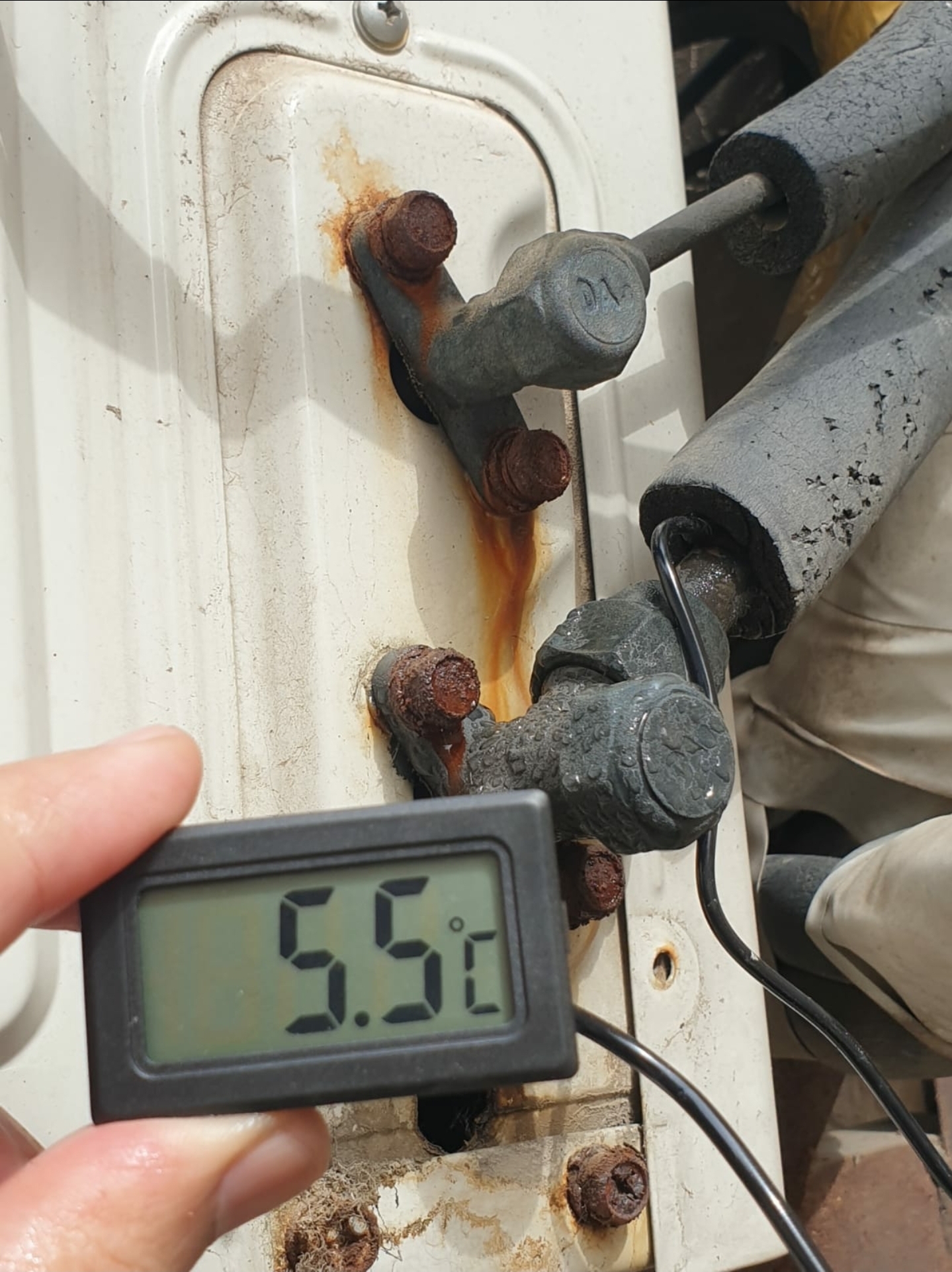

To measure its cooling i ordered digital temperature meter from daraz and was very sad when temp meter said it all.

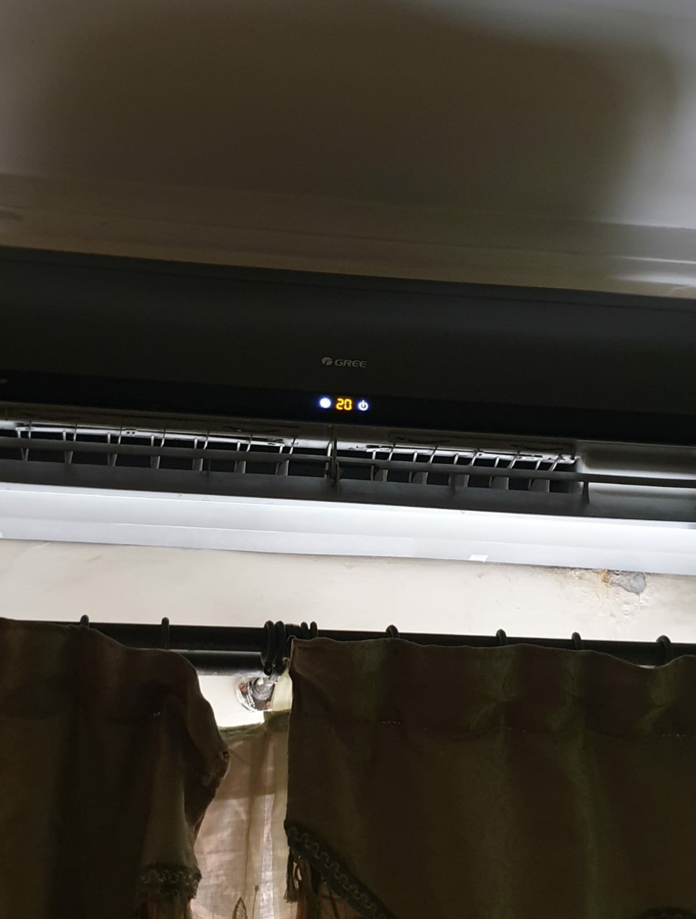

I compared it with my 4 years old Gree Cozy and there was hell lot of difference between cooling of both units.
Gree suction line temp went down to 5.5 C after running for 20 minutes on set temp of 20 and Hyundai went down to 15.2 C in same time and settings. Both rooms are exactly of same size.
