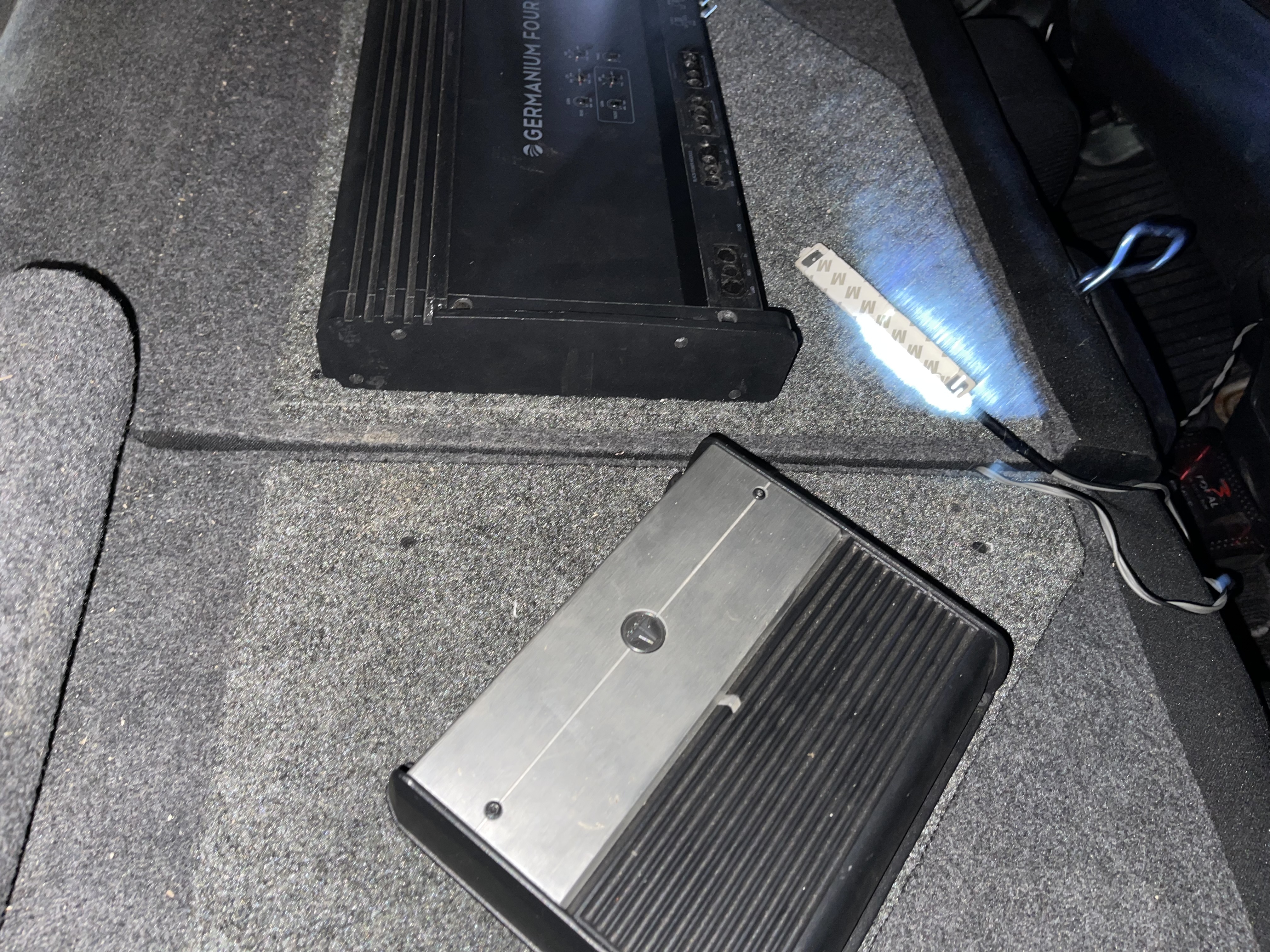

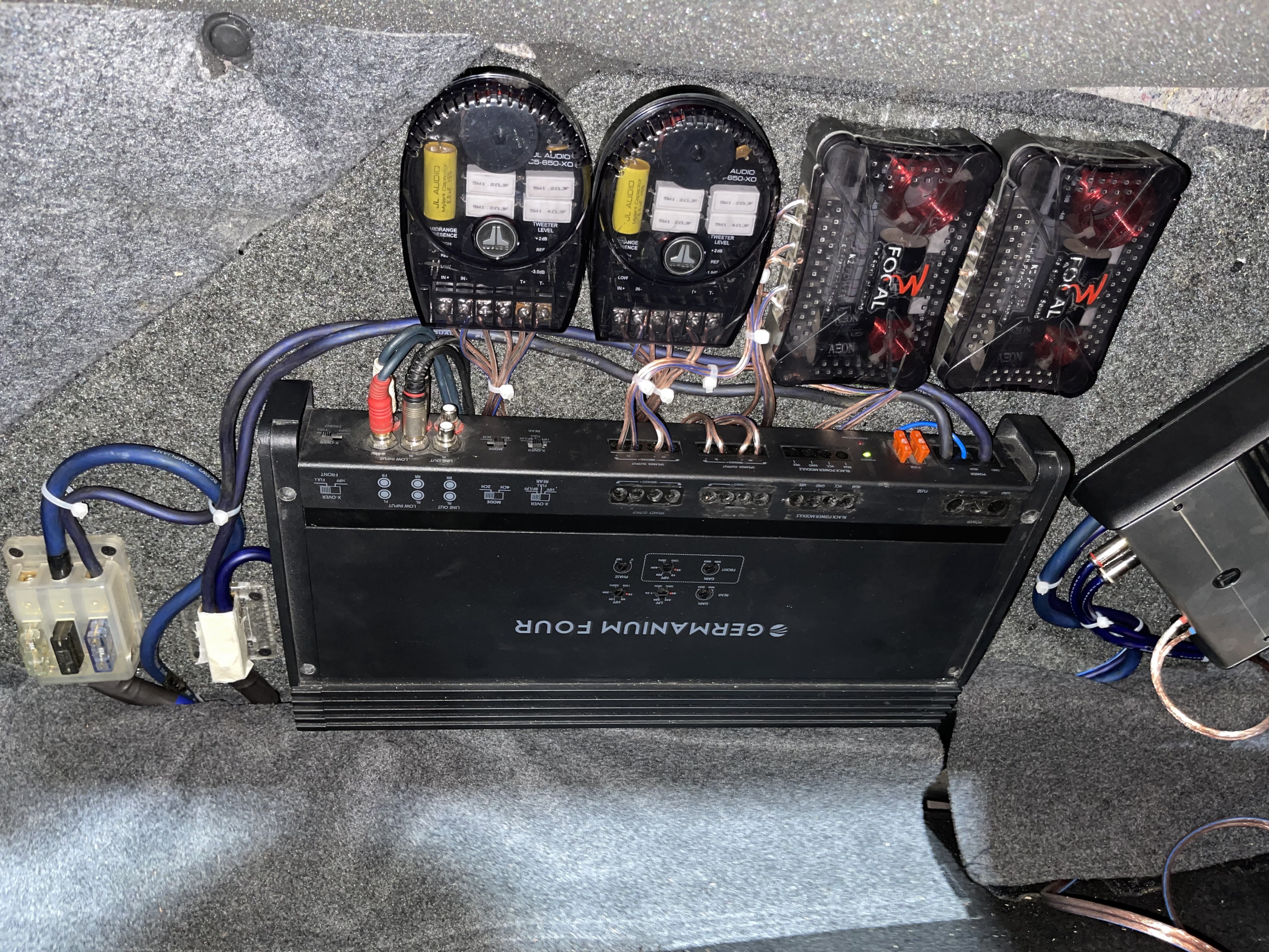

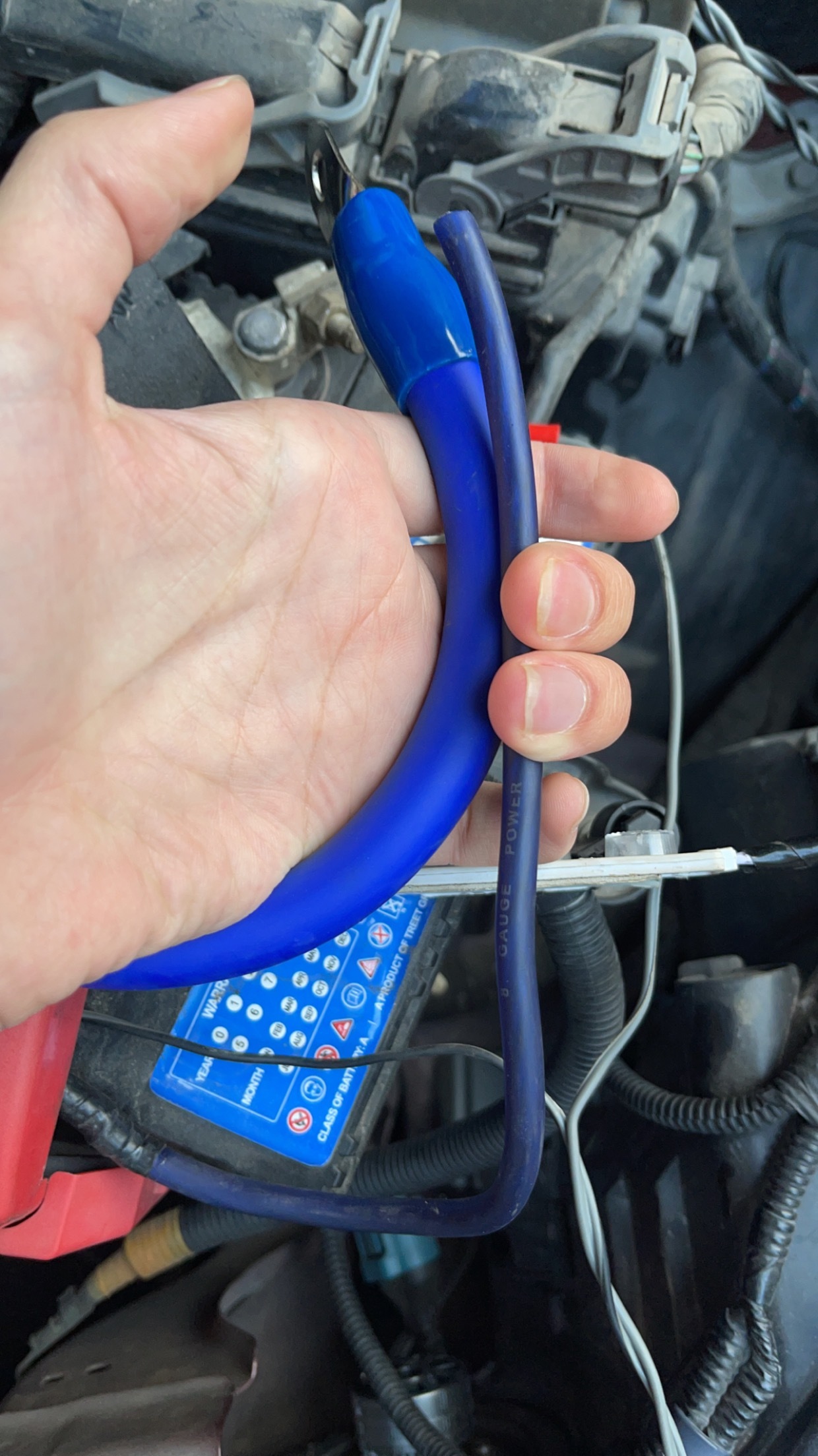

Thank you @devils_smile Mustafa bhai for the subwoofer cable. Sherry bhai did an amazing job. The 0 gauge has helped a lot with distortion and subwoofer output. Installed the amps on the back of the seats with seats still being foldable. Changed the speaker wires to OFC copper wires since my cables were CCA welp. Installed fast rings on the speaker and used double speaker adapter rings on front so my windows can roll down completely as Focal K2 mounting depth is long. Really happy with how it turned out. Apparently gains and EQ that I set myself was perfect, Sherry bhai just boosted the 12.5k by a Db rest was perfect. Time aligned and level matched the speakers. Installed a sheet of jumblon under the rear seats since it was removed anyways. Now onto big things very soon InshAllah hehehehehehe
