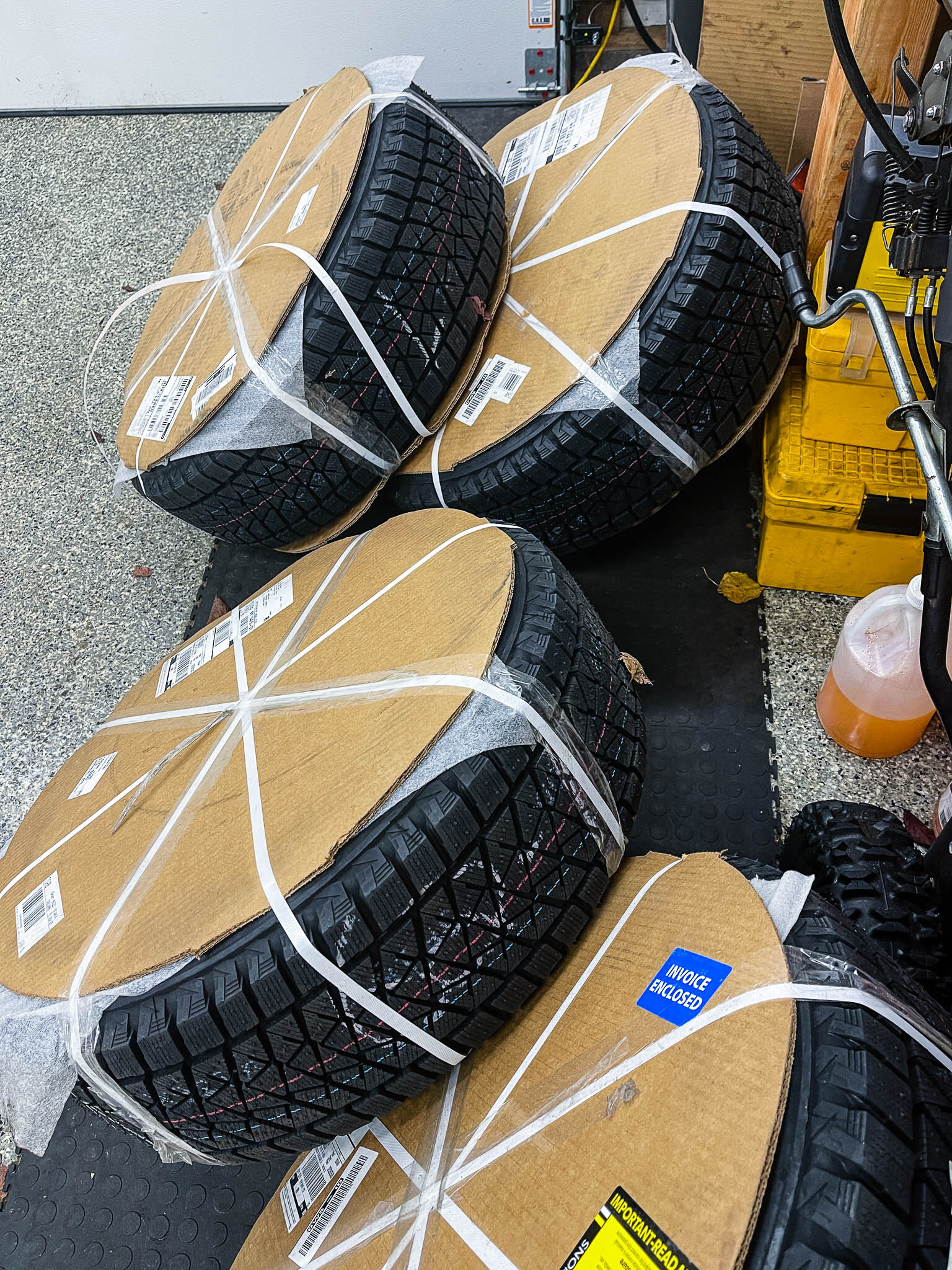

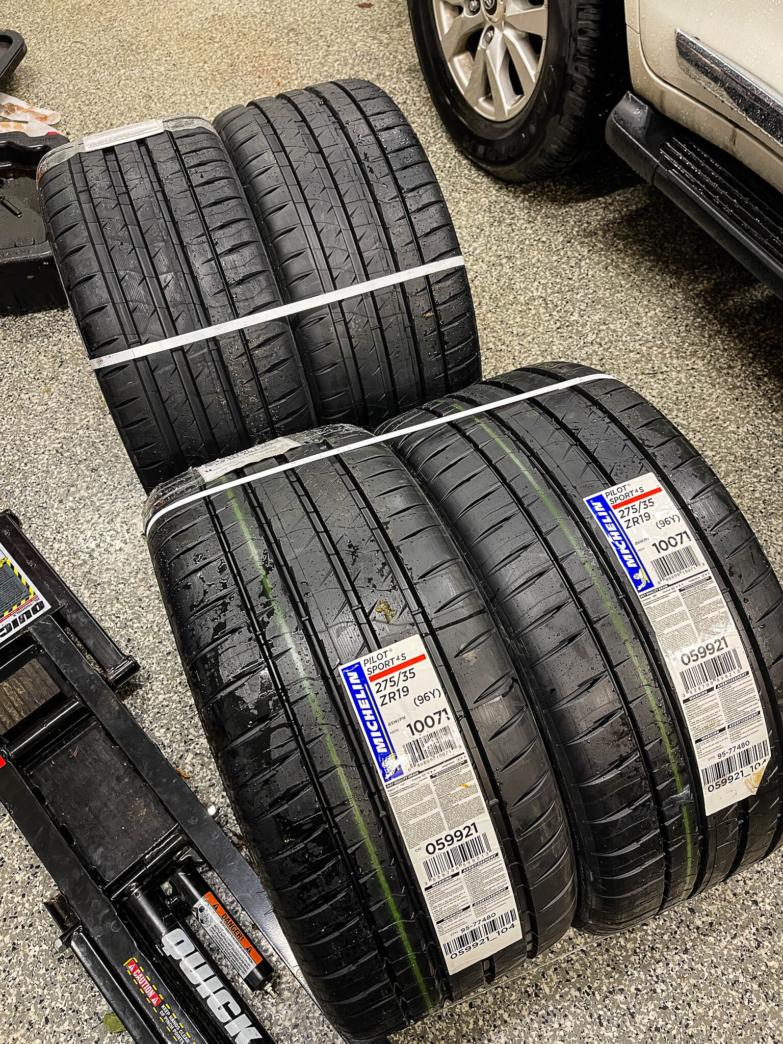

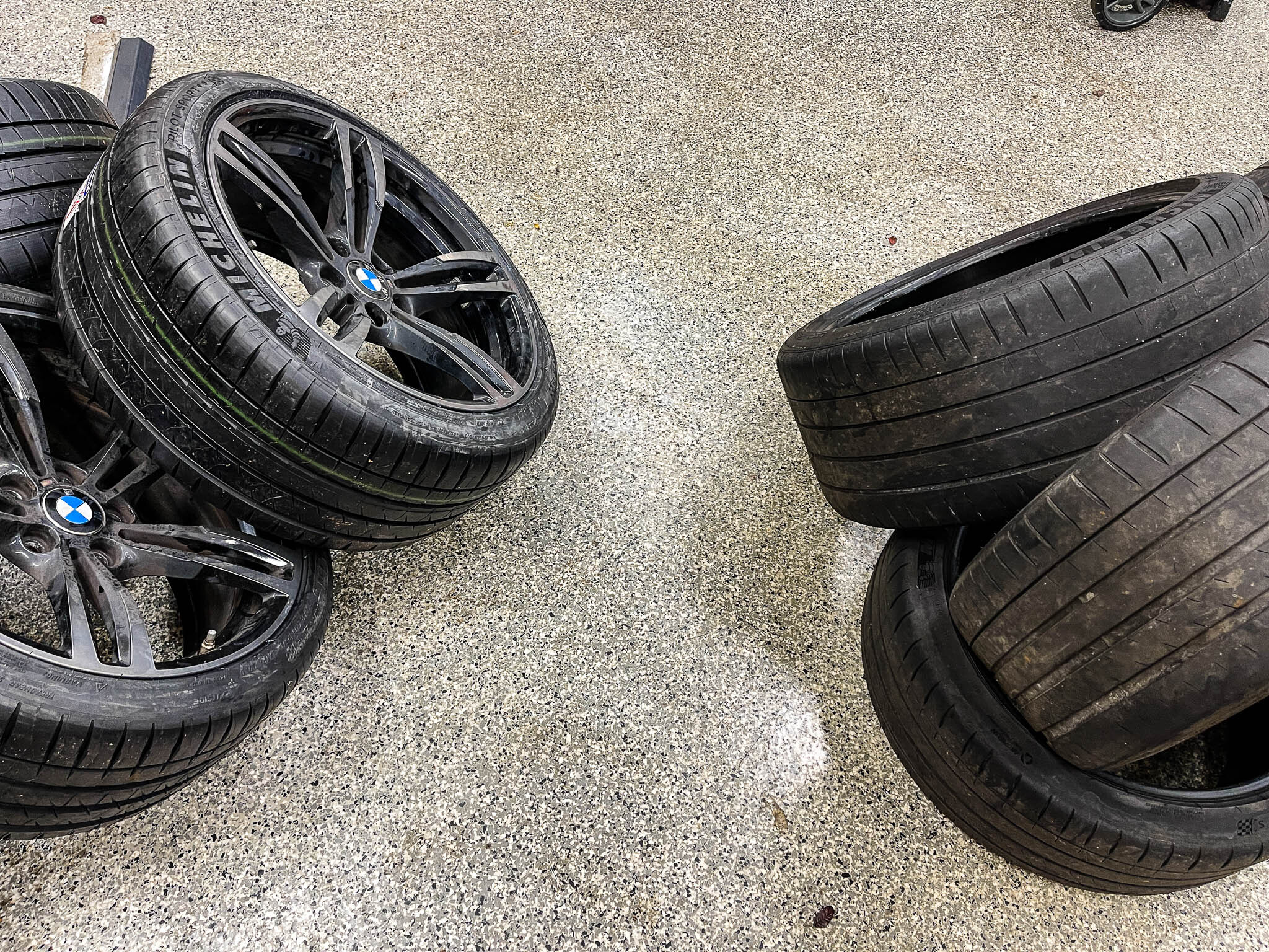

Changed over to 18 inch snow wheels and tires on the M3, and then put on a fresh set of tires on the 19 inch wheels for spring:

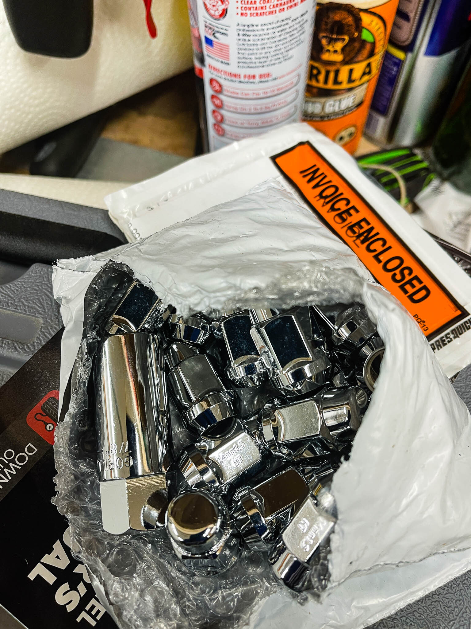

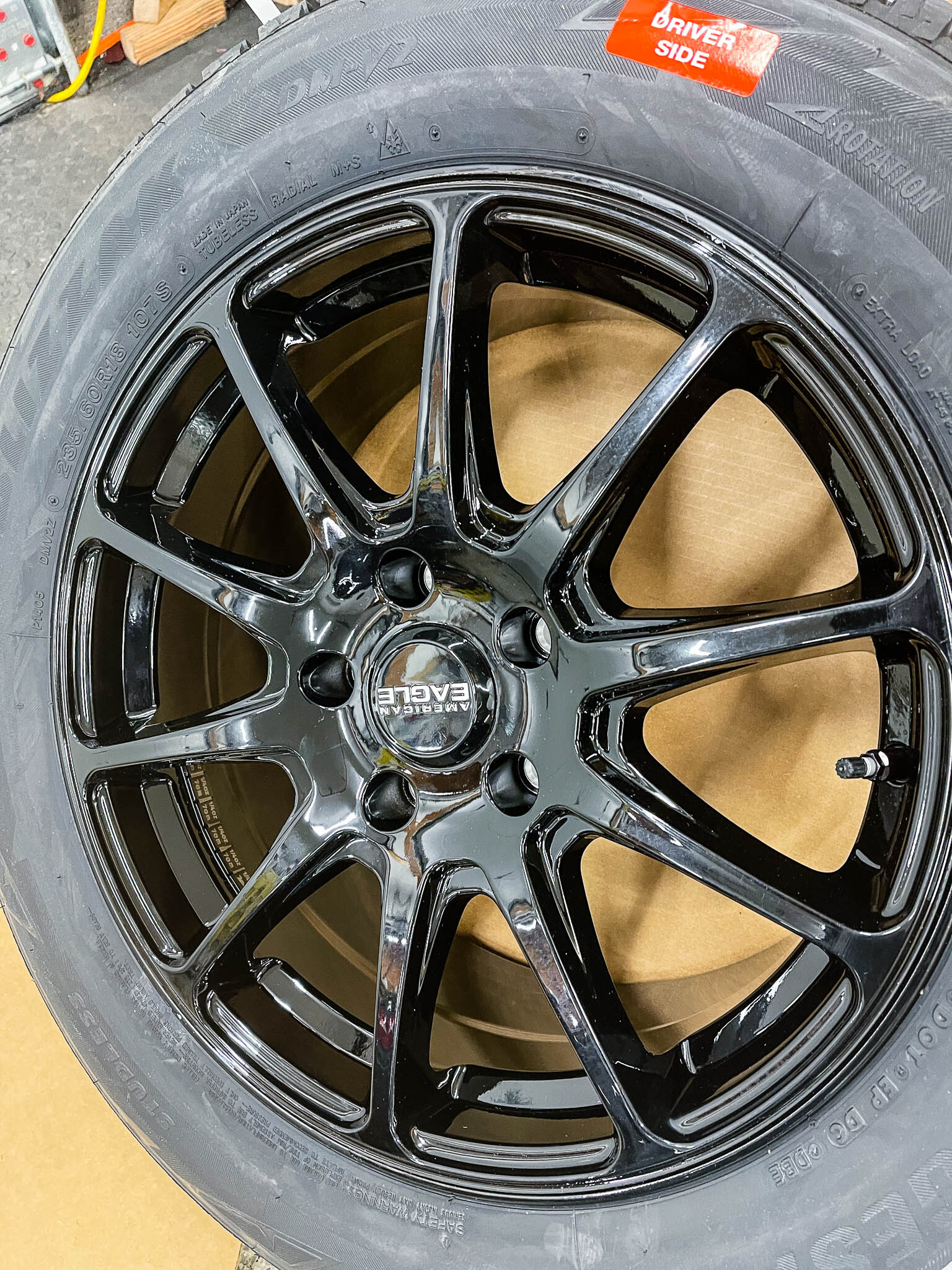

New wheels and tires for the Odyssey from Tire Rack:

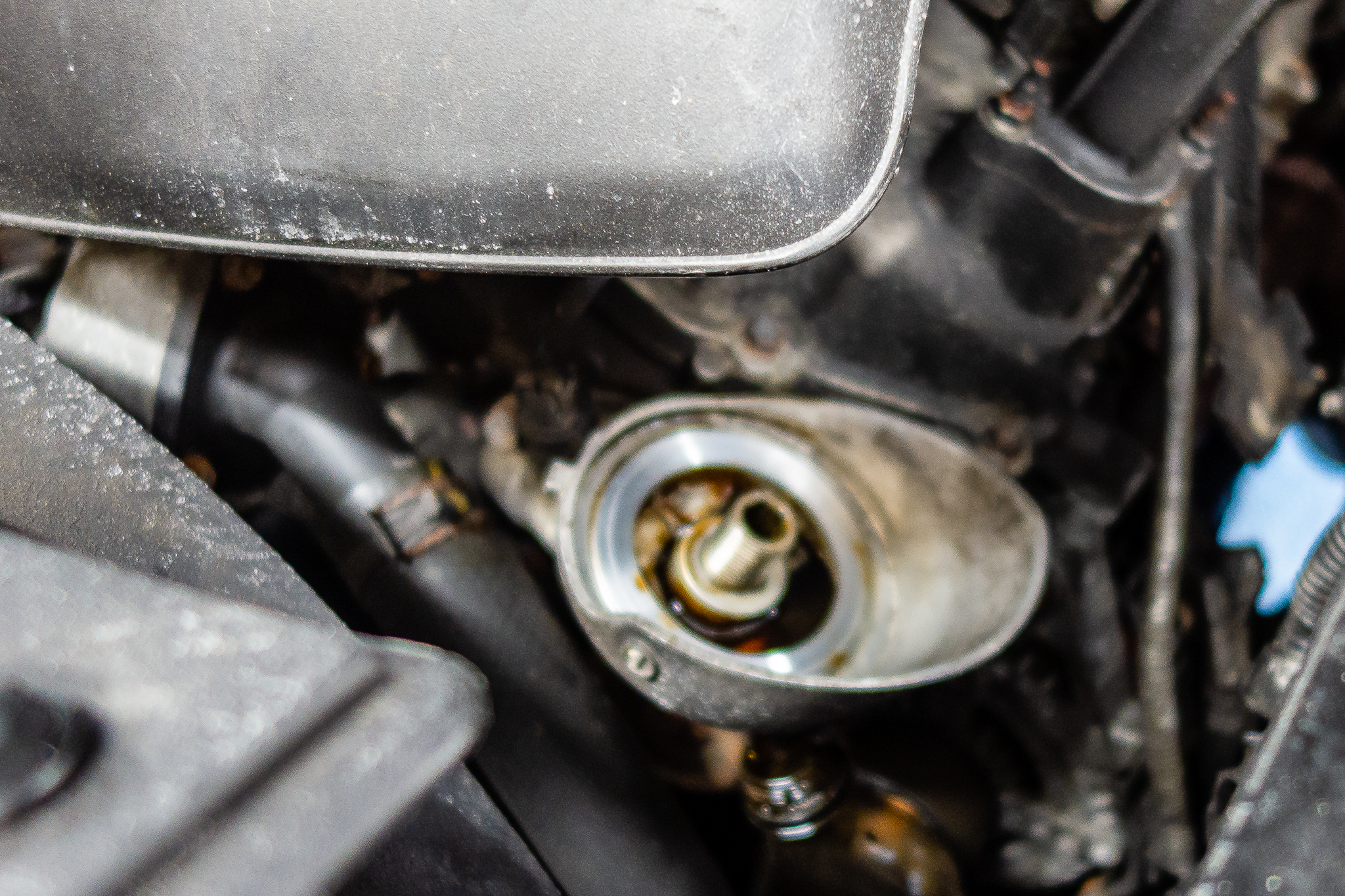

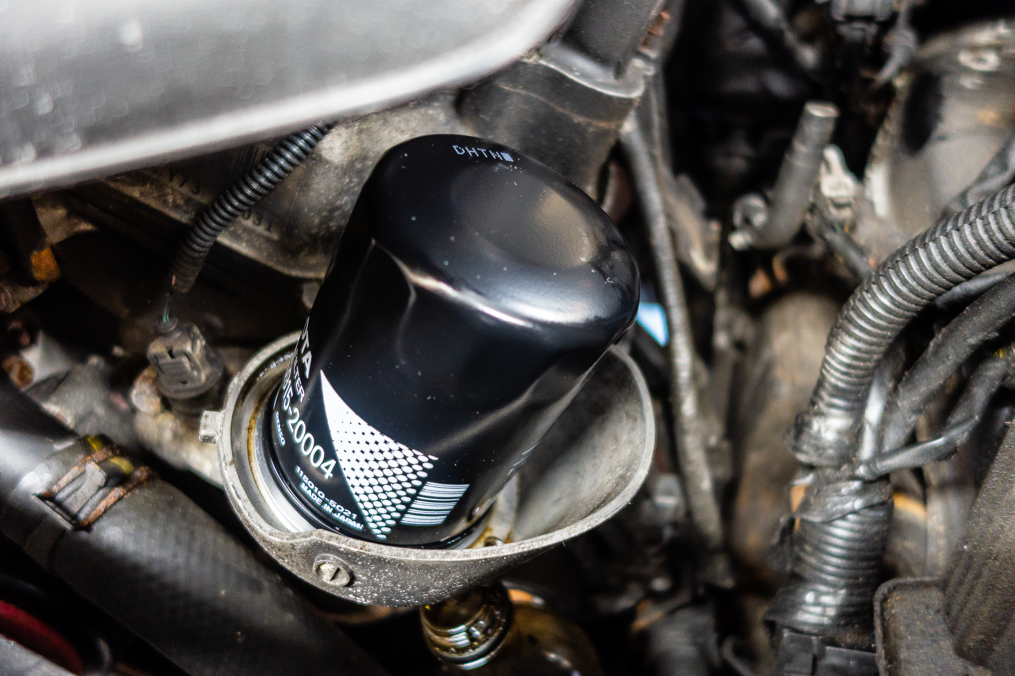

Completed the 125K service on the FJ over the weekend.

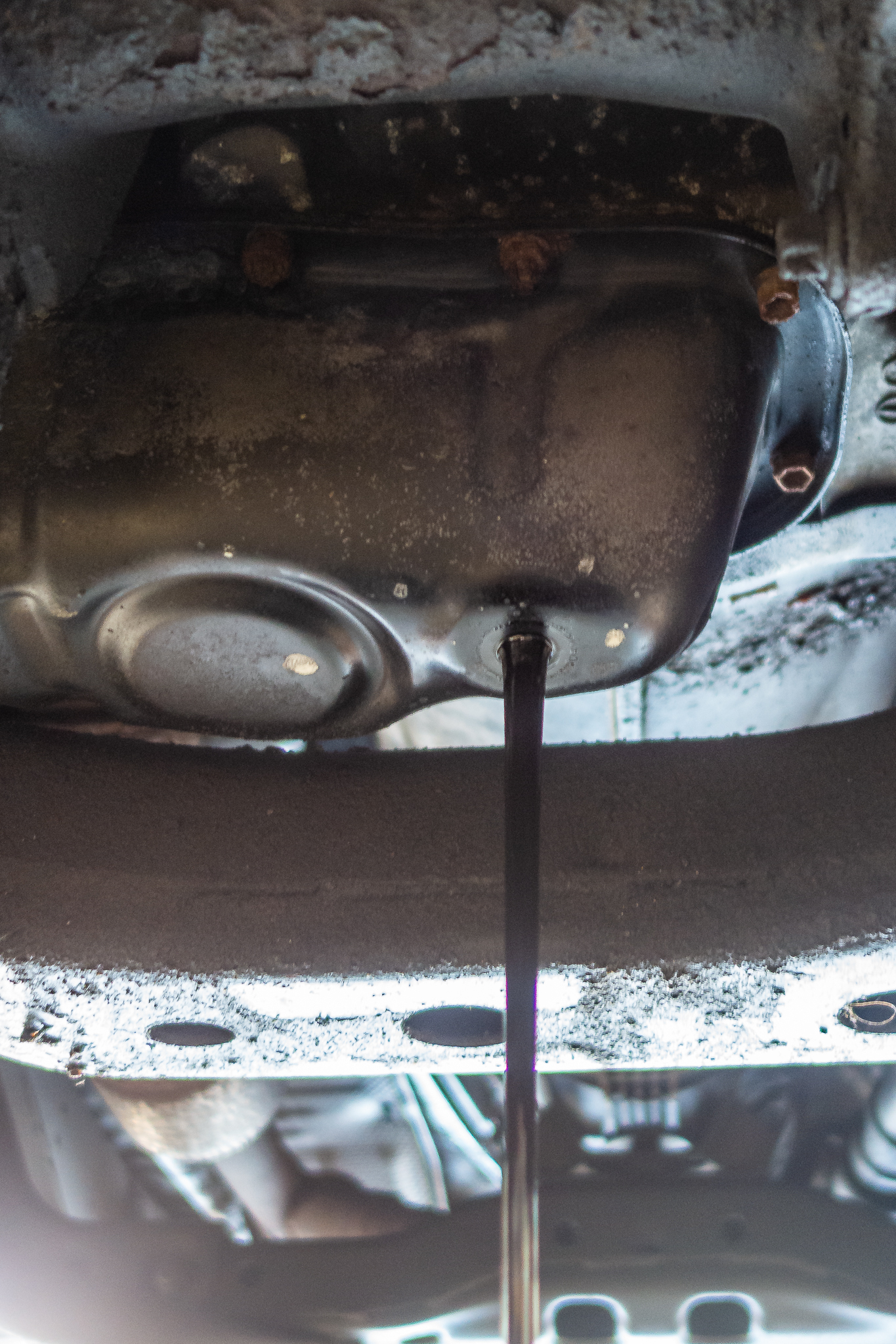

Draining the oil:

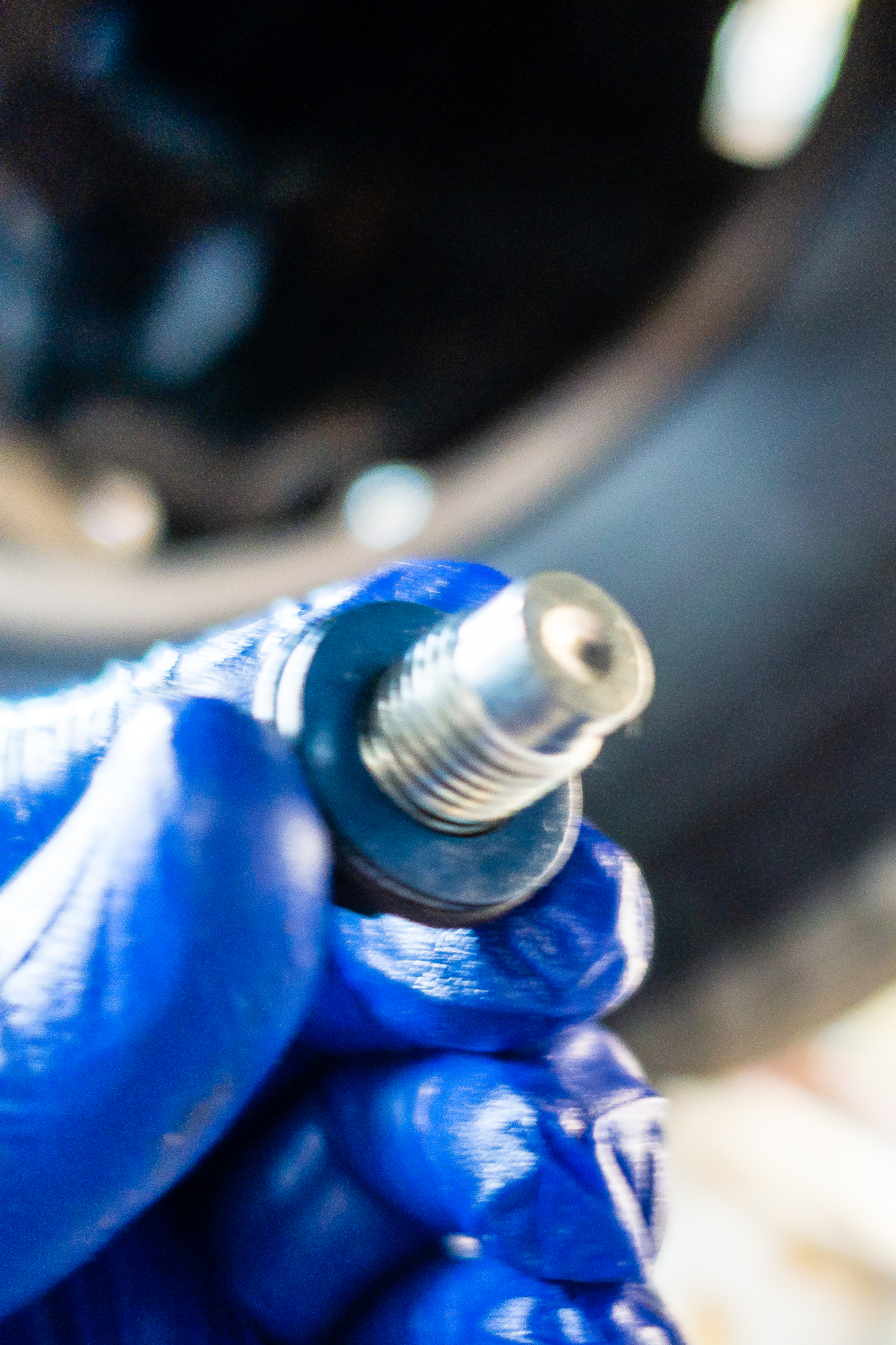

New washer for the drain plug:

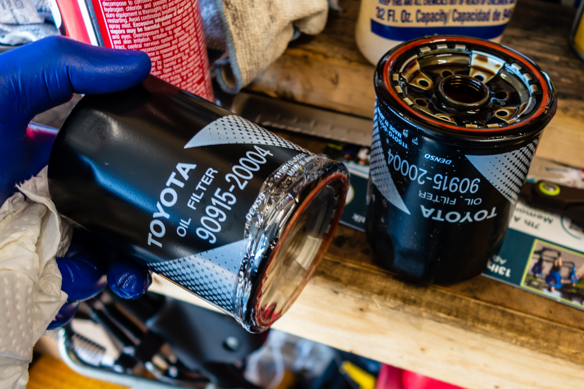

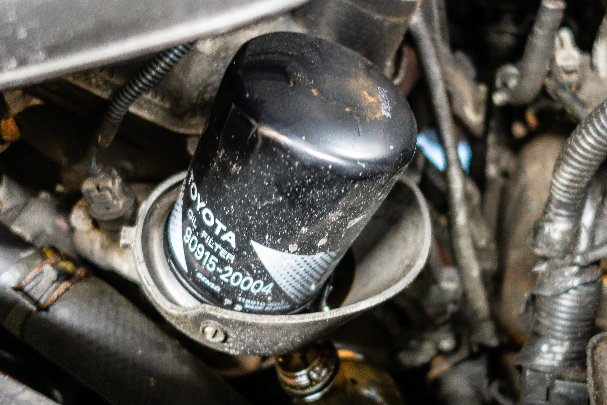

Remove old filter:
Clean the filter seat:
Out with the old, in with the new:
3/4 of a turn after initial contact and no more:

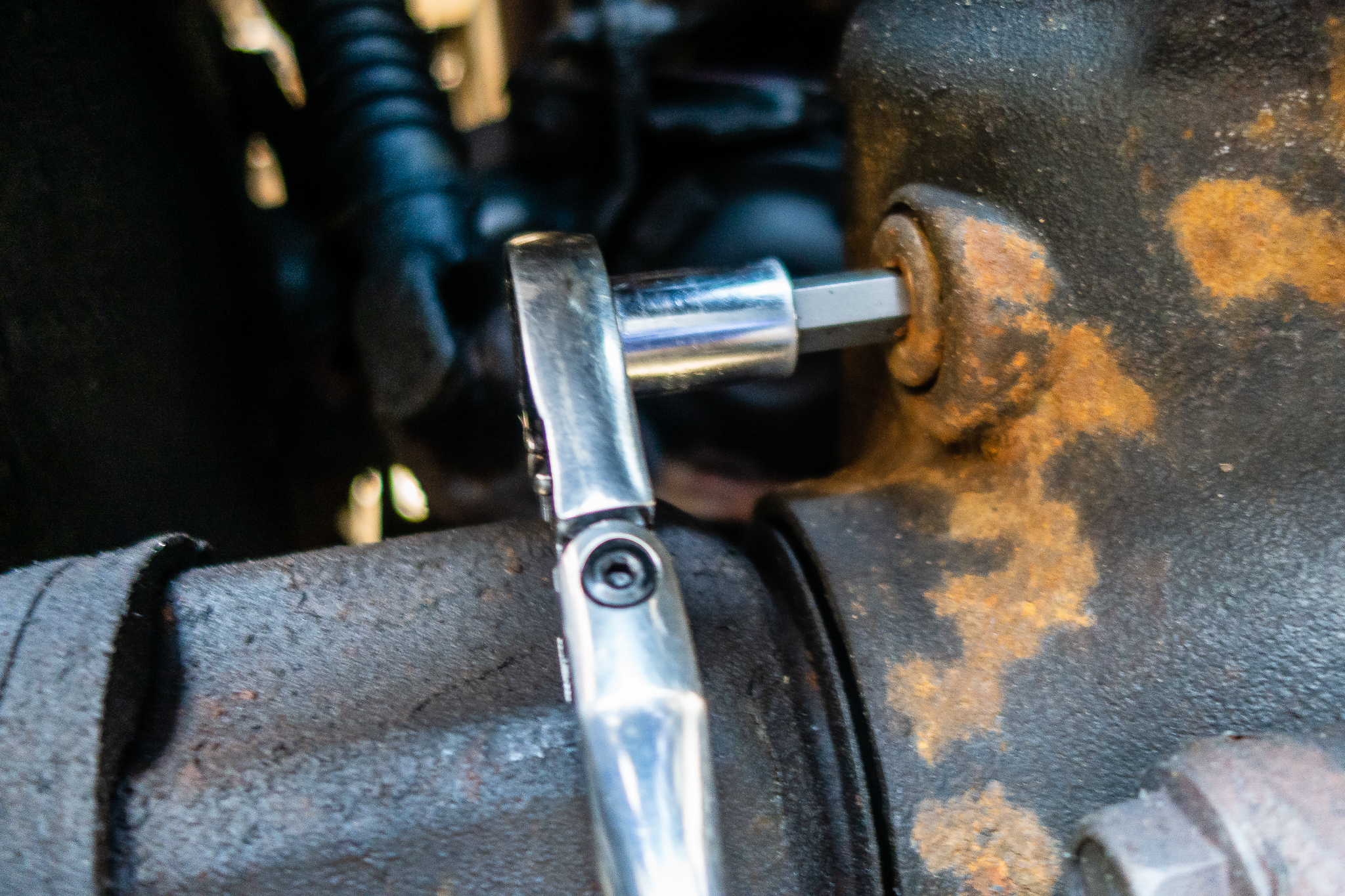

Removing the front diff fill plug:
And only then the drain plug:

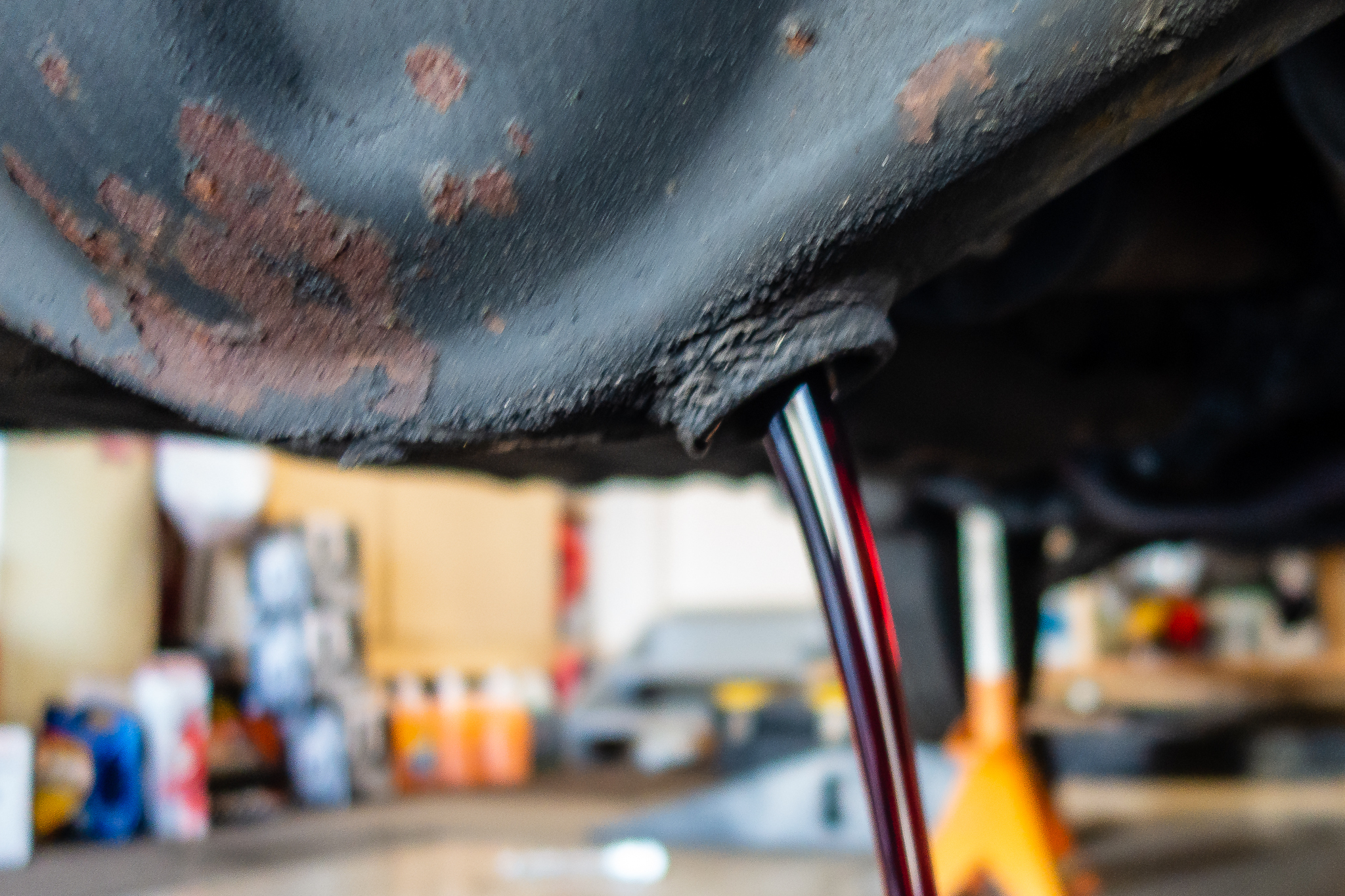

Draining the transmission:

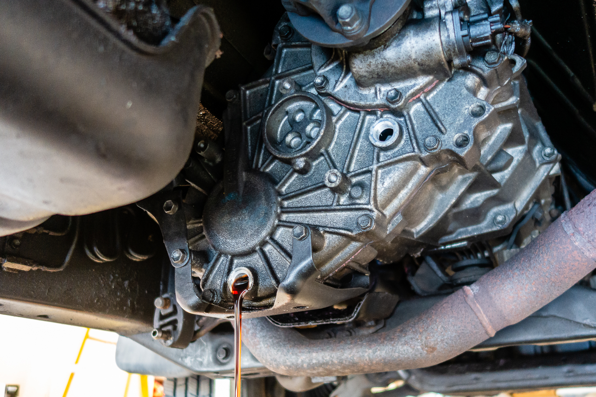

Draining the transfer case:
Always open the fill plug first:

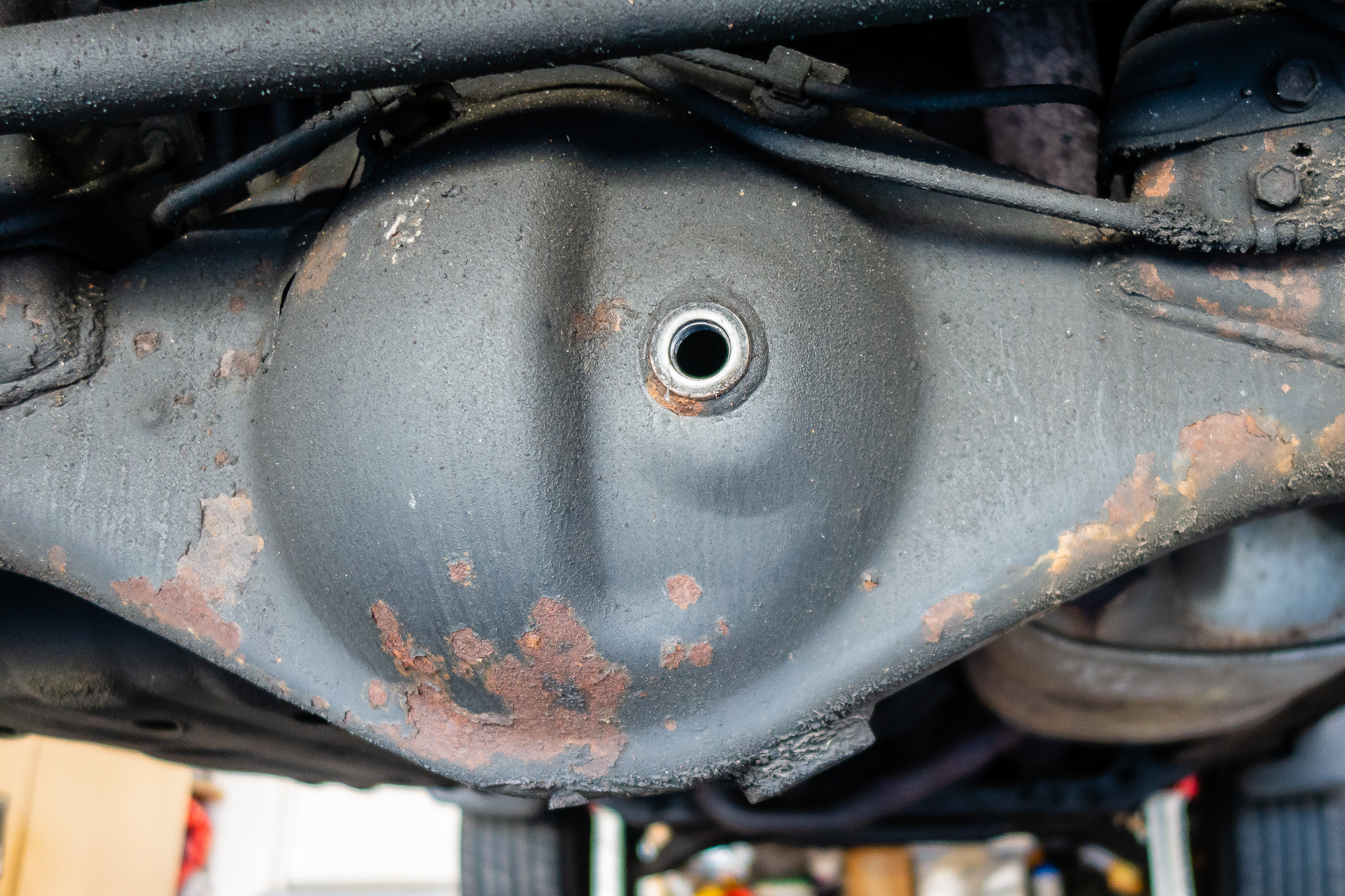

Draining the rear diff:
