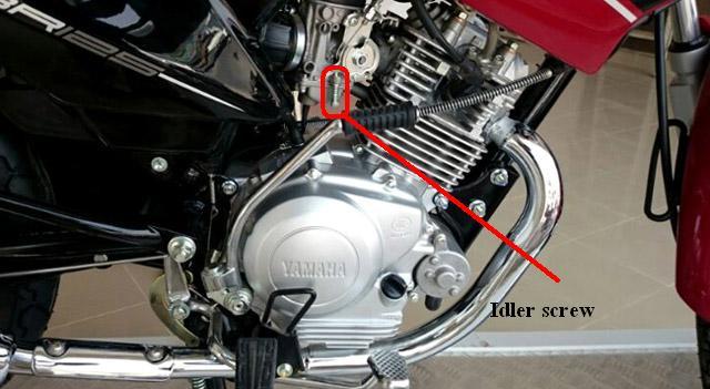

Idle screw kon sa hy????
Jis say engine key speed tez hoti hay oss ko idle screw kehtay hain carb per laga hota hay mistery hazraat oss say speed kum zyda krtay hain
idler screw ki pic attached hy
